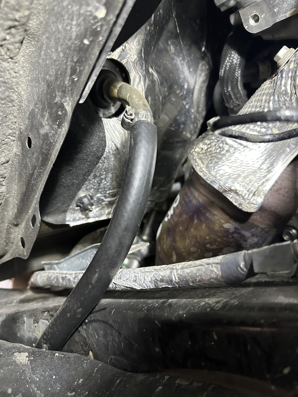

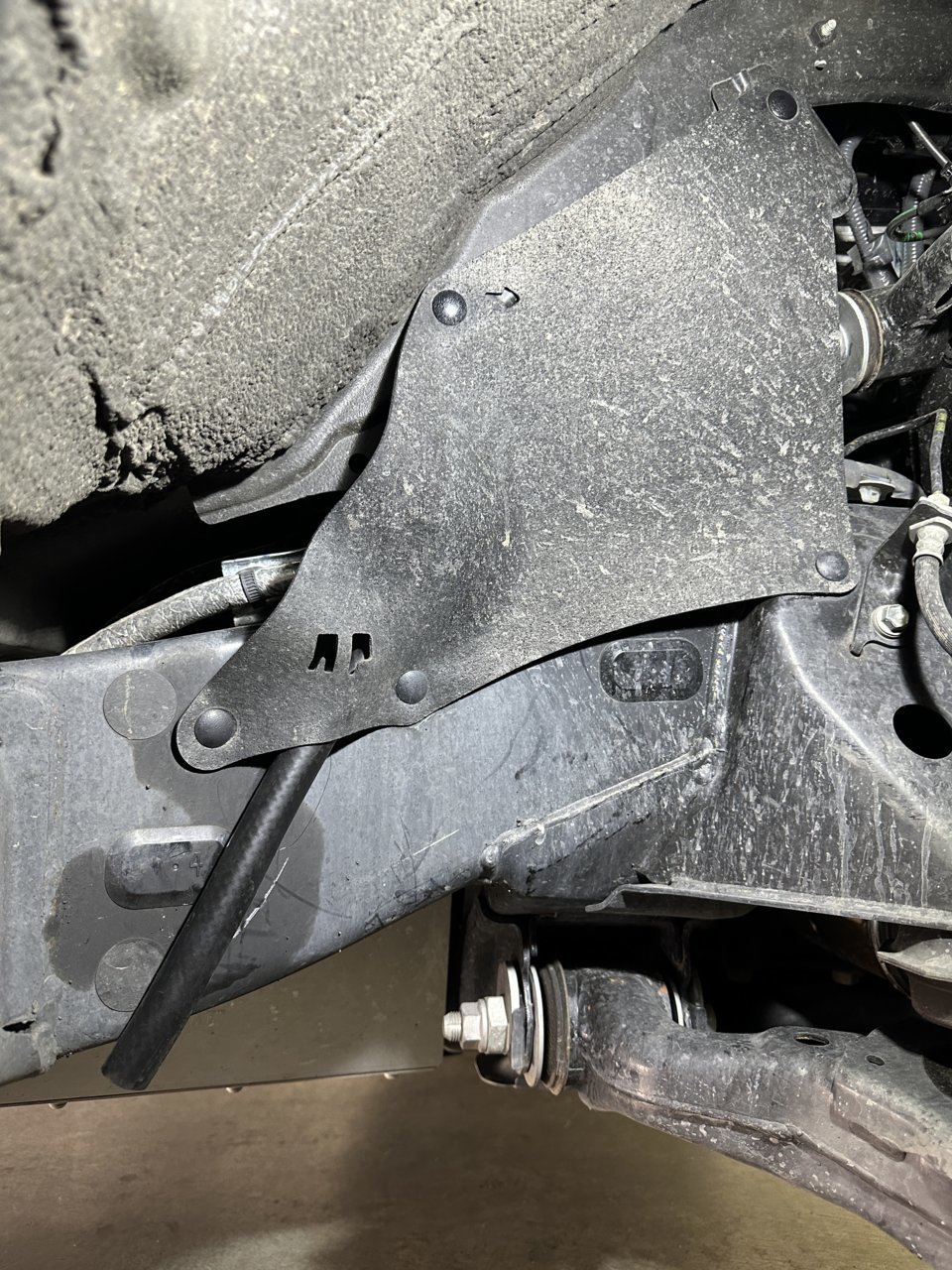

    Did this mod to my 2023 OR AccessCab. The hose I picked up came with a preformed 90 degree bend at one end which improved the transition from the drain line IMO.

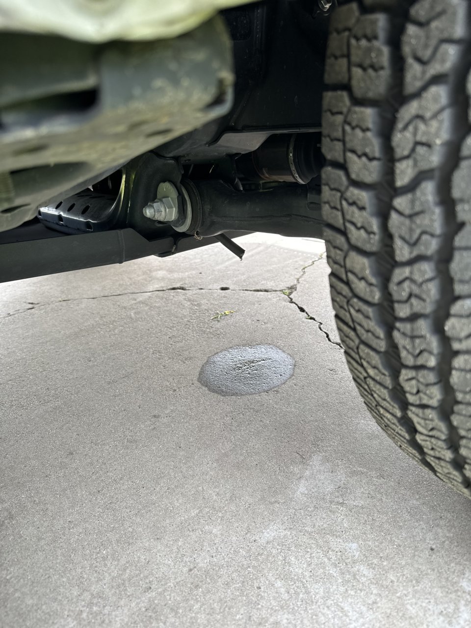

    I did this to my 22 soon after purchase and wanted to share something I've noticed.
    It will continue dripping for at least a couple hours after the truck is shut off. I noticed this recently when I walked back to the truck after it had been parked for a couple hours and saw the puddle under the drain. It's humid where I live so I figured it was from earlier and hadn't dried up. I paid closer attention and water was still slowly dripping from the drain.

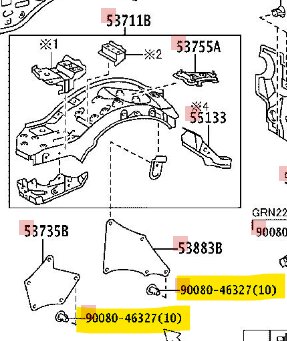

    I broke one of the spray liner clips. Based on what I found at https://parts.toyota.com/ the replacement part number for the clip is 90080-46327.

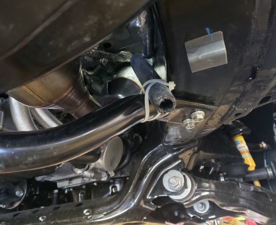

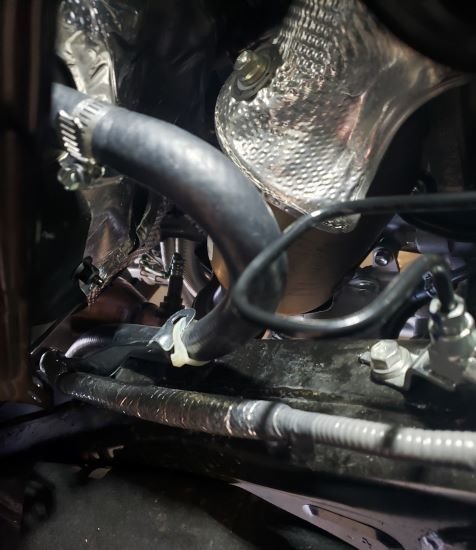

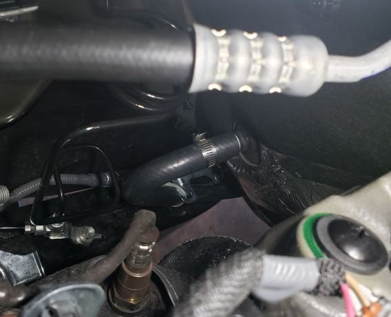

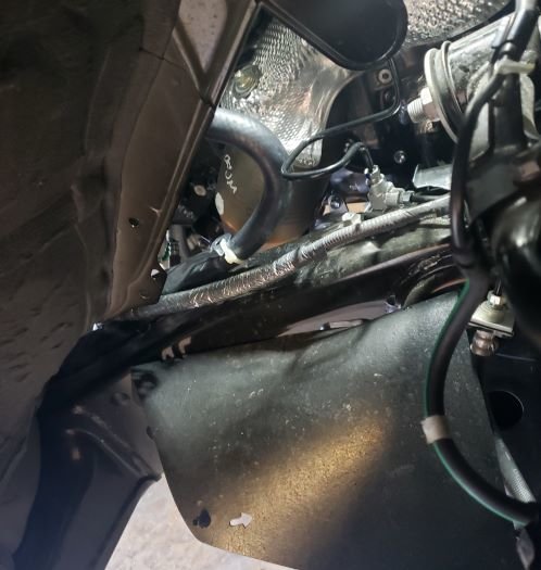

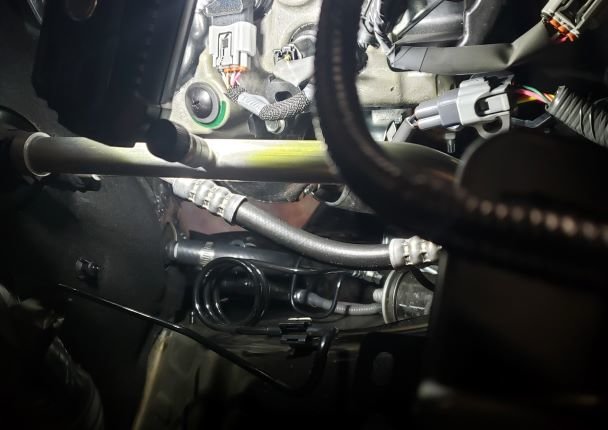

    Just finished this mod. Fitted in-between the cover, or whatever that is called, and the frame. No zip-tie at all.
    1/2inch coupling.
    1/2inch heater hose.
    1/2inch hose clamp.
    might have to get 5/8-3/4in hose clamp to secure the new heater hose part.
    Other than that, seems to work fine.
    Tested with full a/c all day.
