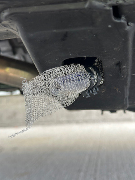

    I did this mod today. I used clear plastic hose from Home Depot, 5/8 ID, with 3/4 OD, and hose clamp to fit.

    I ended up using a metal dryer lint trap that, so far, has been working okay. Time will tell if it will deter the smaller spiders.
