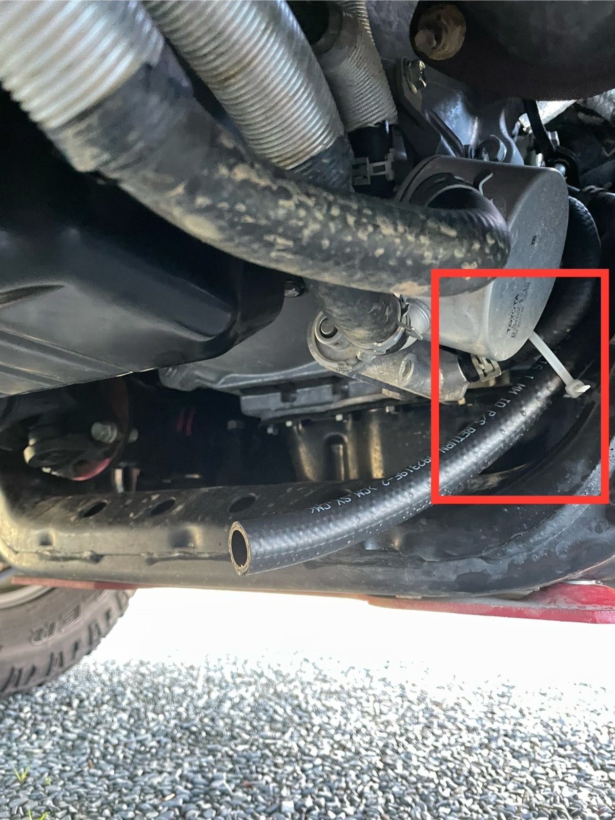

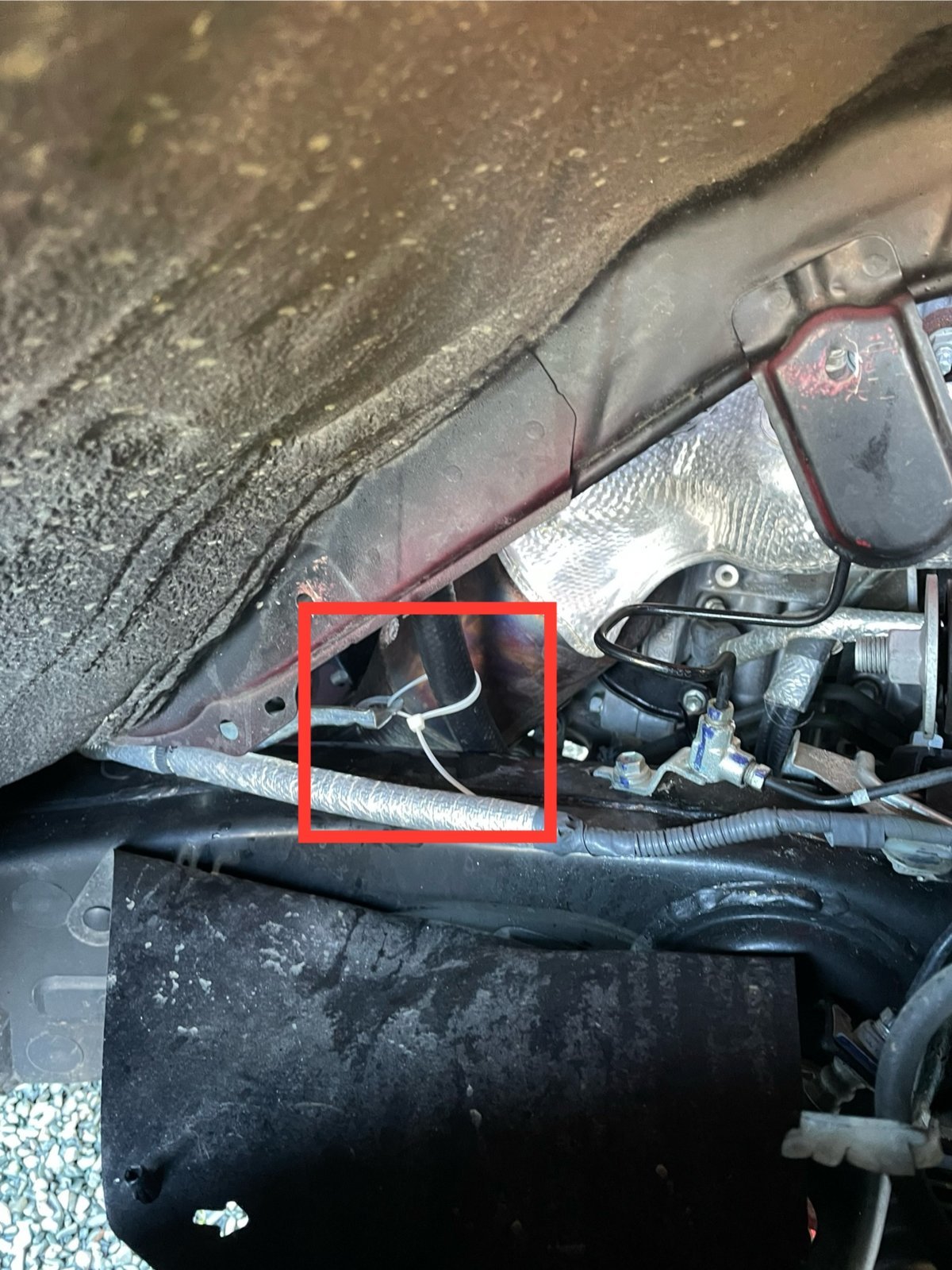

    Side note when you go to do this. It’s very close to the heat shield for the exhaust and the exhaust itself. There’s an aluminum bracket with a hole in it perfect for a zip tie. You probably already noticed this, but if not, it may help.

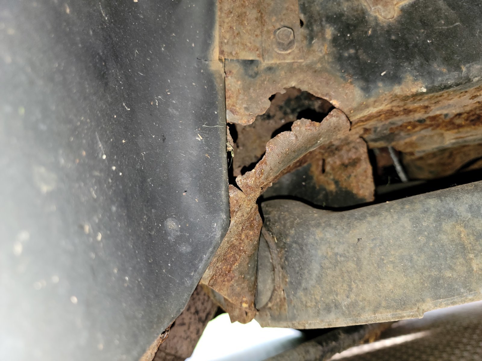

    In the months when the AC is used regularly that area will be constantly saturated with with moisture. The condensation line dripps for hours after you use the truck, It will most certainly rust out the frame in that whole area. If you ever had old vehicle that you parked on a field you'd see what just the moisture from the ground does. The Ford Crown vic and all the models based on the Ford Panther platform, had a condensation line that would drip straight on part the frame, eventually rotting it out.
    This picture is from a Lincoln Town Car, this area was constantly wet from AC condensation drain.

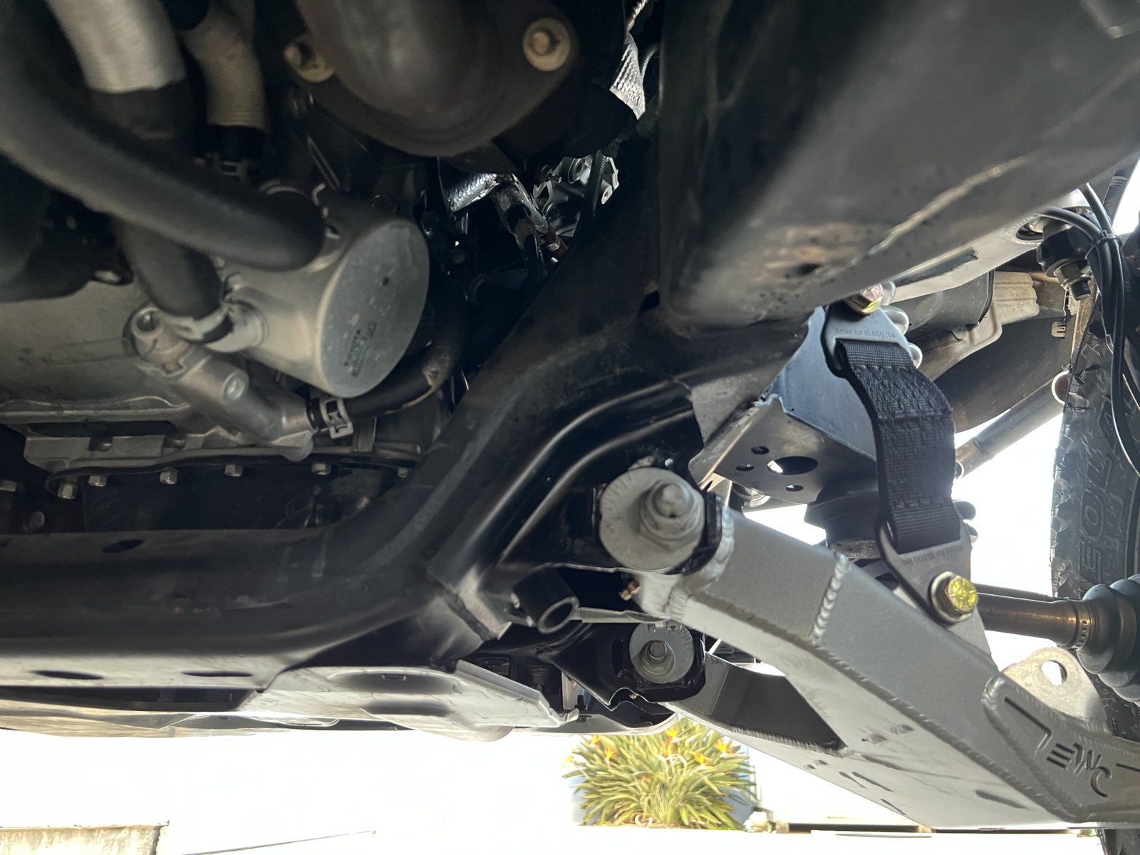

  19. Jul 21, 2024 at 10:48 PM
    #959
    BlackTyRD
    BlackTyRD Well-Known Member
    Oct 26, 2023
    #436223
    56
    Tyler
    Washington
    2023 Black TRD Sport DCLB
    S&B intake, MBRP exhaust, Black Rhino Shogun wheels, tail lights, VLED footwells, bed stiffeners, side mirror turn signal lights, interior lights, X-Trek grille, Tinkerer shift knob, TRD skid plate, OEM bed lights, OEM remote lock tailgate, blackout door handles, window tint, hitch pod light, oversized cup holder, RAV4 knobs, RetraxPRO XR cover

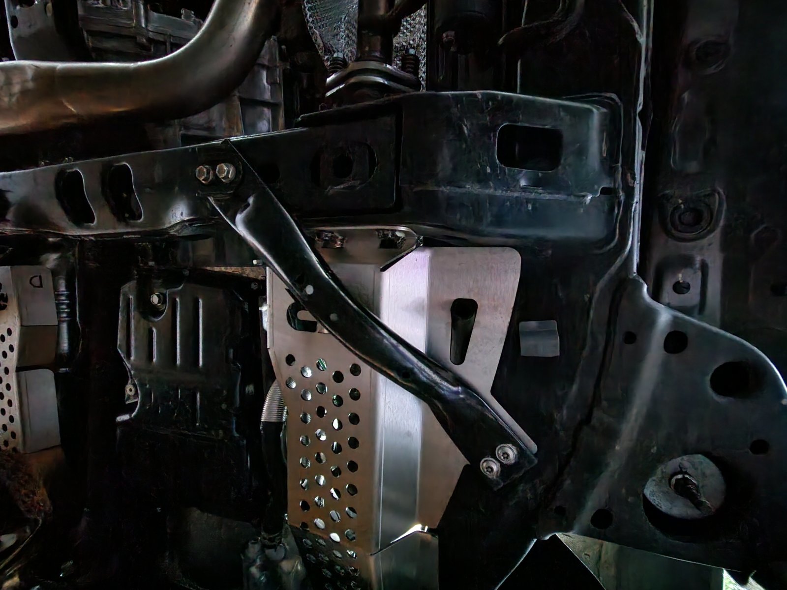

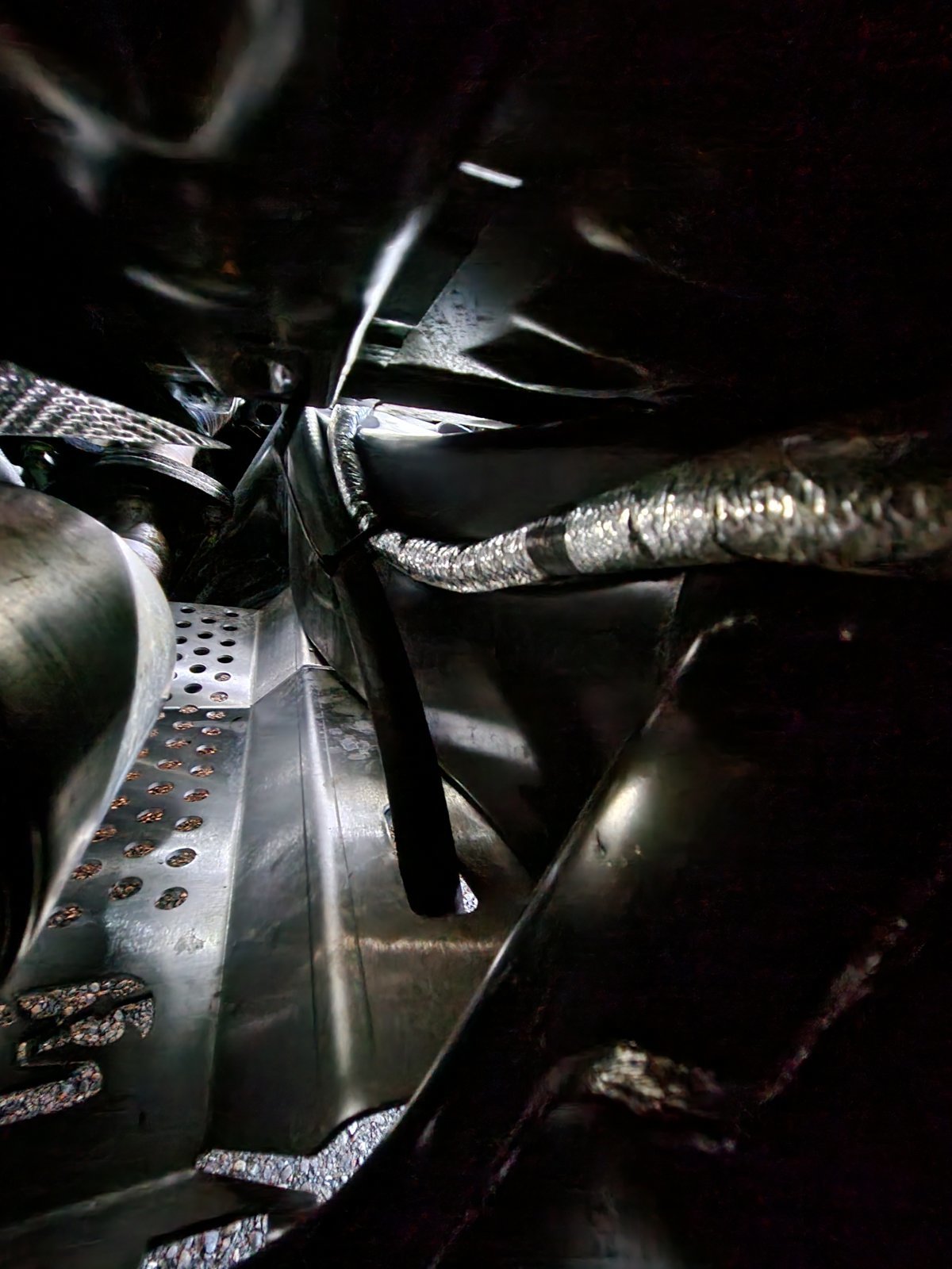

    Finally got this done and it fit right in the cat shield
    N64_Wallmaster likes this.
  20. Jul 22, 2024 at 1:13 PM
    #960
    N64_Wallmaster
    N64_Wallmaster Carolina Cajun
    Oct 31, 2023
    #436583
    705
    Raleigh, NC
    2017 LTD 4WD
    - Bilstein 5100 Shocks - Icon AAL - Old Man Emu 2885 Springs - 16" TRD Bead lock style alloys - bronze - Falken Wildpeak AT3W 285/75 r16 - IFS Skid Plate; Bare Aluminum - Body Armor 4x4 Revo Rock Sliders - Diode Dynamics SS3 Fog Lights w/ Amber Accent Lights - Tacoma Lifestyle Side View Mirror Sequential Turn Signals - Cali Raised LED Bed Channel Supports; added self-adhesive rubber edge trim - AFE Magnum Pro Dry S Filter - LEER 100R Camper Top - Weathertech Window Deflectors - Bulletpoint Mounting Solutions Dash Mount - TRD Pro Grille with Raptor Lights - Headlight H11 to H9 DIY bulb conversion - Diode Dynamics interior and license plate LED bulbs - FBC license plate light DIR - Replaced chrome LTD mirror covers with oe black - Replaced chrome LTD fog light bezel with oe black trim - Meso Customs map and dome lights - Hot Shot Offroad All Lights On - Metal replacement Toyota oil filter housing - VIOFO A119 Mini 2 dash cam
    Looks good. Happy about the cat shields?
