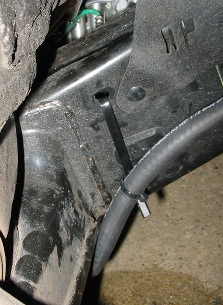

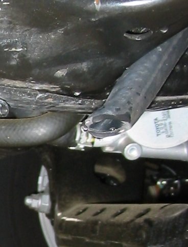

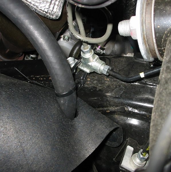

    I ran the hose outboard of the frame.
    To bear the general weight of the hose, I made a figure 8 out of two plastic wire ties with one loop around the hose
    and the other around the metal brake hose junction. The hose then passes through a slit I made in the rubber splash guard
    and rearward. Near the bottom edge of the frame, I snaked a large wire tie through two holes in the frame by putting two crimps
    in the wire tie. Okay, I folded the wire tie and bit down on two bends about 3 inches apart. :) Hey, it worked!
    I looped a smaller wire tie through the big one after it was snugged down and used it to secure the free hose end.
    A Sears Handi-cut I found in the road a while back made easy work of clipping the end to length and I was done. After it was all over, it occurred to me,
    "Wonder if the tire will rub the hose at full right turn?"
    Nope. Misses by several inches. I have the OEM Toyos on my SR5. Proceed at your own risk.

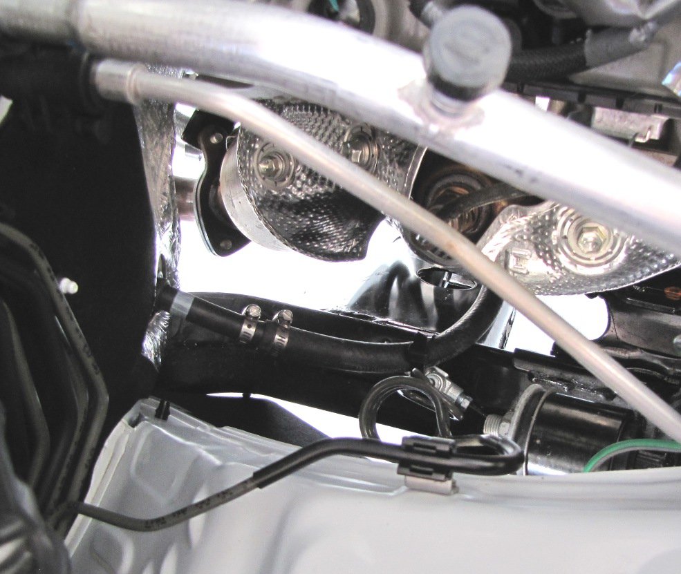

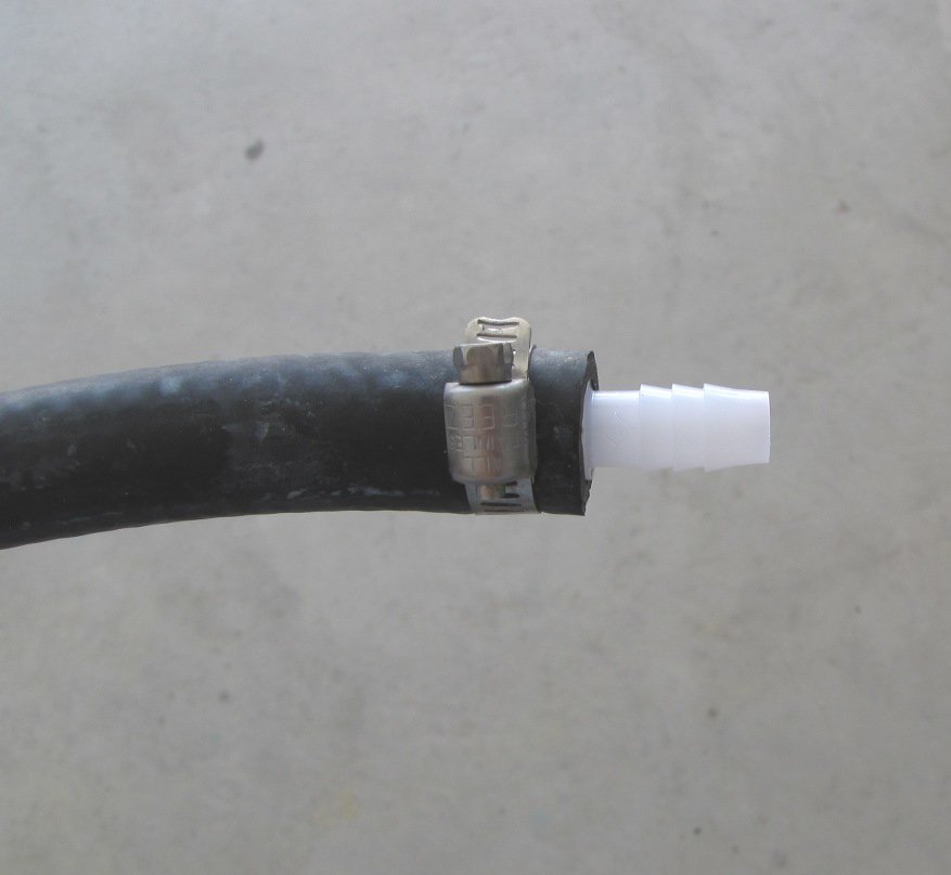

    I got this done to my Tacoma today, but I bought a plastic barbed connector at the hardware store and used it to splice on the heater hose, and I secured it in three places with large ty-raps. Thanks to the OP for posting this up.
