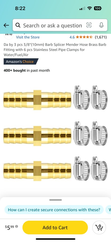

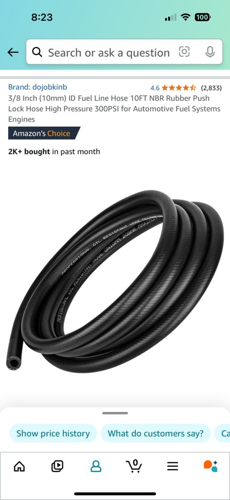

    I've seen both 3/8" and 5/8" hose mentioned, along with the barbs and or clamps, so which is it, or will both work?

    Maybe the original ID is 3/8" and the OD 5/8"? The one with 3/8" uses a 3/8" barbed fitting to connect the hoses.
