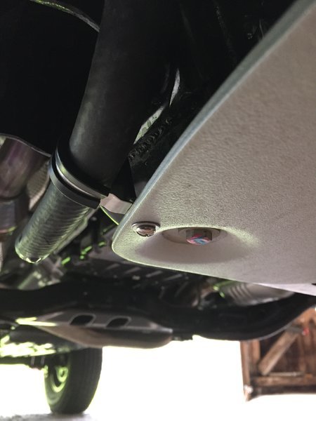

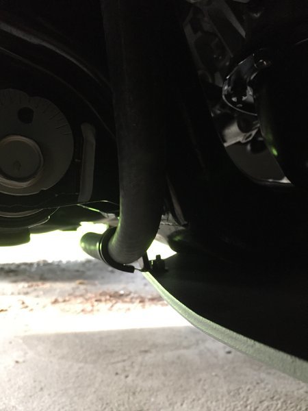

    Here's how I anchored mine. SS rubber hose clamp and some SS hardware. Very solid.

    Did you use those clamps higher up as well?

    No but there isn't any need to. If I were to do it again I'd get a size smaller clamp though.

    ^^^^hmmmm, good observation. I used heater hose, which stays more flexible since it is rubber. You could try that if you wanted to keep that drainage hose. Otherwise, I would think you'd be ok.
