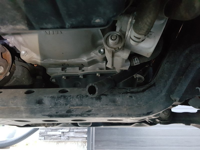

    Did the mod and it was pretty easy. I ran the hose down the frame crossmember and dumped it out the bottom of the subframe. You can barely see it and it's tucked out of the way of everything.

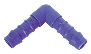

    Noticed this the other day when i got home, water was running down the frame rail and dripping out about half way down the cab. Problem solved now . Thanks for the info .20170616_210508.jpg 20170616_210424.jpg Just finished mine tonight, less than $5

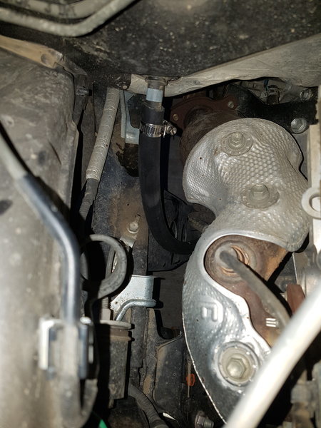

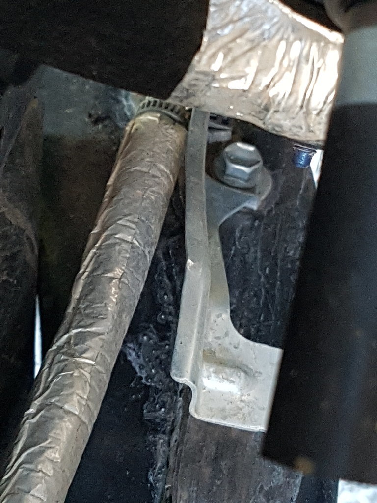

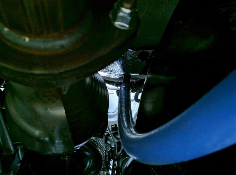

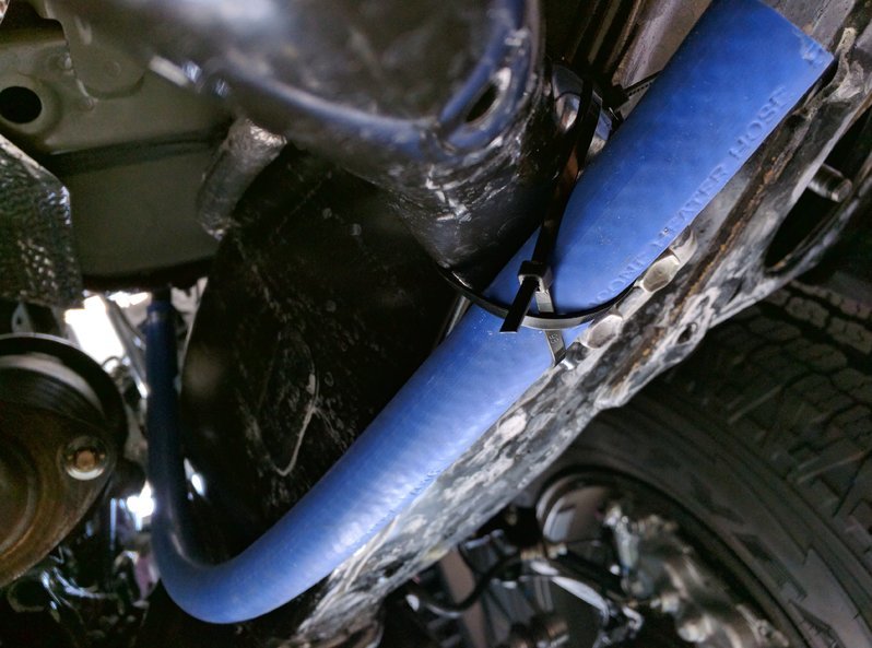

    I have performed this mod with reinforced clear nylon hose, I kept it away from the heat running beside the frame to the outside and down along the frame to the rear of the engine.
    From above with open hood.
    From the passenger front wheel well.
    From below under chassis.

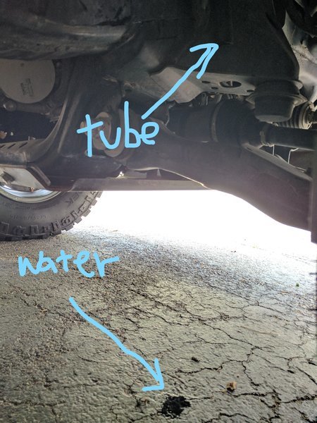

    Rotiform SIX OR Toyo Open Country RT
    just a follow up on this, since doing this reroute, i notice there is some serious hardwater stain on my epoxy floor from where the tube drips down to the garage floor. Can't imagine it doing that over time on the frame. If you haven't done it, do it.

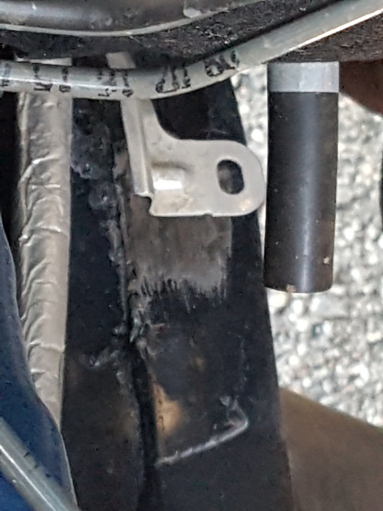

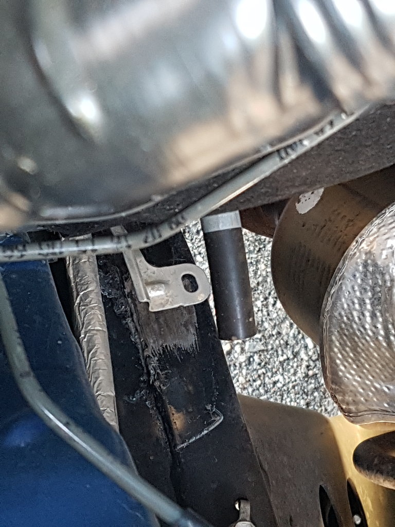

    Went to put the hose on this weekend and noticed this bracket is rubbing on my frame, anyone know what is suppose to attach to this bracket?
