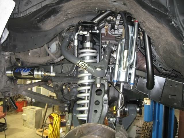

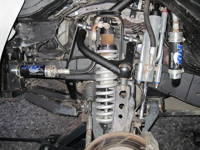

    I had purchased them with the UCA's and rear Fox's as a package deal.....the rears don't look anything like the fronts. The maintenance sheet they sent suggested to wax the bodies to keep them healthy. I did a few times and this still happened. Still awaiting a reply from FOX.

    turned to this:
    I'm going to clean everything up as best as I can, replace what needs it, and coat everything with Fluid Film as mentioned earlier in this thread.
