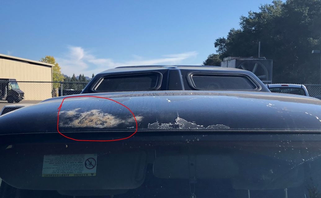

    Any protective rust spray or liquid for oxidation on the paint?
    Some areas of the roof on my truck's clear coat has faded and getting worse over time.
    Some of the extreme areas even look like it's faded down to the metal causing surface rust :(
    2002Tacoma4x4 likes this.

    I don't think that's faded paint as much as worn paint. Paint isn't magical anti-everything. Sand and dirt in the air is constantly, well, sand blasting it. Waxing helps slow the fading but older paint is just gonna wear down over time on leading edges.
    "I'm Earl Scheib, and I'll paint any car, any color for $19.95. No ups, no extras."

    Maybe I'll just rub sunscreen on there that'll do it!
