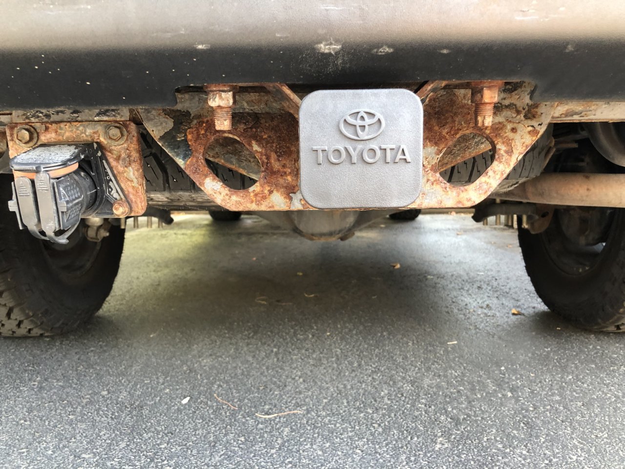

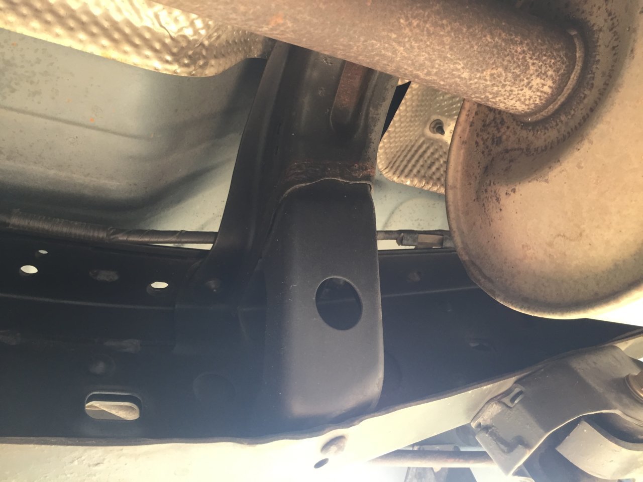

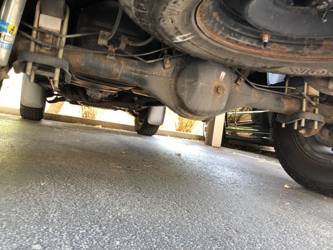

    I recently moved to Arizona from Michigan and would like to do some rust maintenance on my truck. I have some pretty bad rust on my trailer hitch as well as my rear diff. Is sanding it down and painting over it with undercoat or a similar coat the best option?

    Not sure about removing that much rust.
    My frame and components had some rust (not as much as yours) that I wanted to stop since Toyota wouldn’t replace it after 2 attempts. I cleaned what I could with a wire brush, wiped it down really good then sprayed on Amsoil Heavy Duty Metal Protector. I used 1 large can and ran out at the very end. I did this about 5 months ago and my frame still looks good! I plan on doing it every year give or take. I missed a spot just about the exhaust and you can see the difference, wish I would’ve taken “before” photos but this stuff works. Rain and car washes haven’t effected it.

    I’ve seen the guys in here mention POR 15 I believe for rust prevention once it’s all cleaned up.

    I’d bet what we can’t see if that hitch is way worse. I’d be replacing that

    Luckily my frame was replaced with the recall, so frame is rust free! I will see if I can wire brush it off and maybe I'll test that amsoil out!

    Yeah, that thought has definitley crossed my mind... I don't tow at all though so not rushing to do it. Would at least like to clean up the rust and paint over it to make it somewhat presentable.

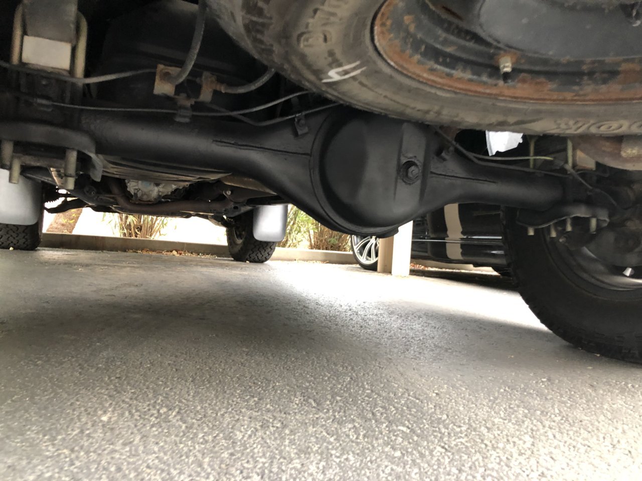

    Ended up using Rustoleum Rust Reformer instead of the POR-15. Amazon won't take it as a return since it is flamable so I can always use it down the line if I decide to. Think it turned out halfway decent!
