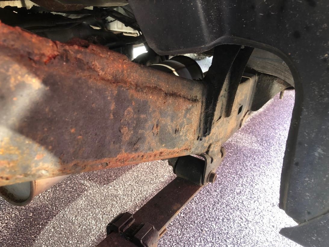

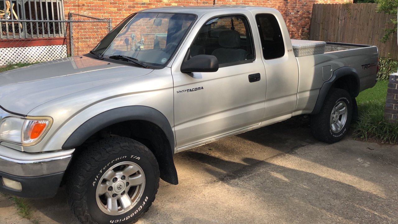

    Is this a build thread? I'm going to start posting the progress of the frame rust repair project on my new-to-me Tacoma. Its a 2003 2.7L 4x4 M/T with over 246k miles. This forum has proved invaluable to me as a new Tacoma owner and given me the confidence I needed to take on this project. Thanks to all you great contributors.

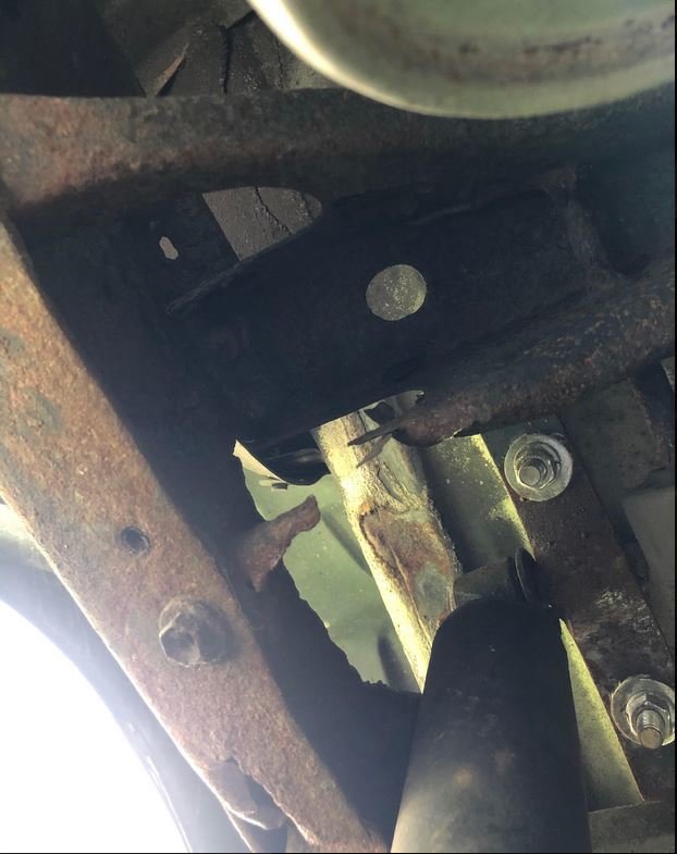

    The rear frame of this truck is wasted with rust and jerry rigged to stay together in a less than safe manner. The rear shocks are actually bolted to the bottom of the bed because the original mounting studs are rusted off. The rails over the rear axle had previously been patched with scrap steel and the worst welds I've ever seen. I don't know how long ago it was done, but the repair patches and welds have also begun to rust through.
    I was going to use safe-t-caps to fix the problems, but instead got a pair of rust-free replacement rails from another TW member @Tour991, and I will graft them in to the existing frame behind the transmission cross member. The front half is also rusty but the structural integrity isn't compromised like the rear is.

    Here's a pic of the truck and a rust-porn teaser.
    More to follow.
    Just look at this....

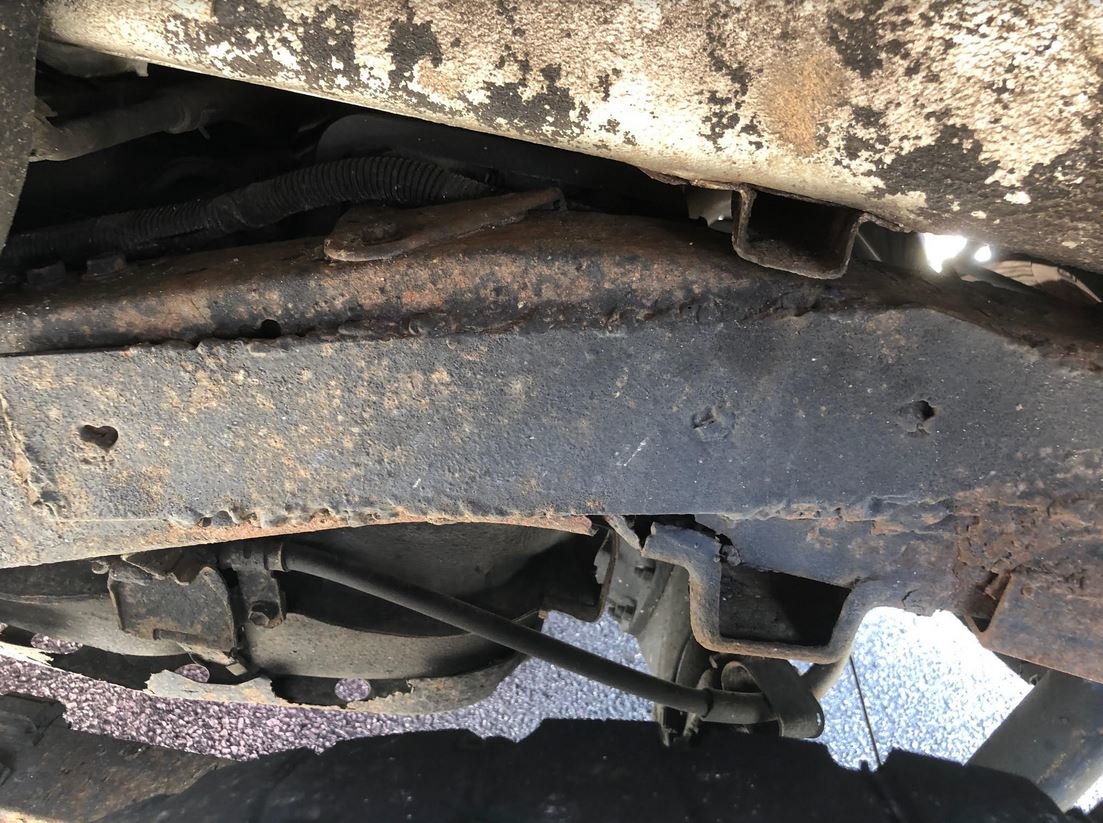

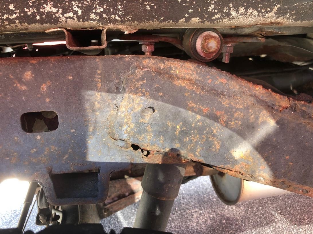

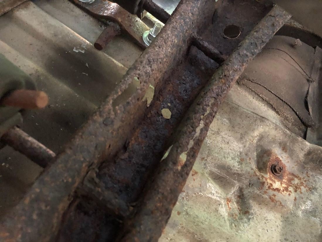

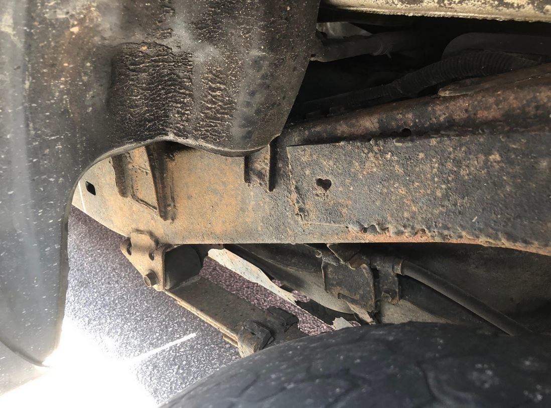

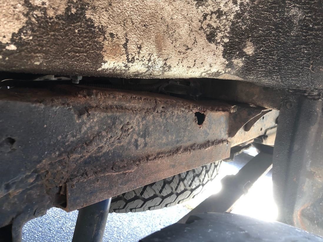

    Here's some pics of the frame rails with old repairs. Some of those welds aren't even holding anymore (if they ever did)

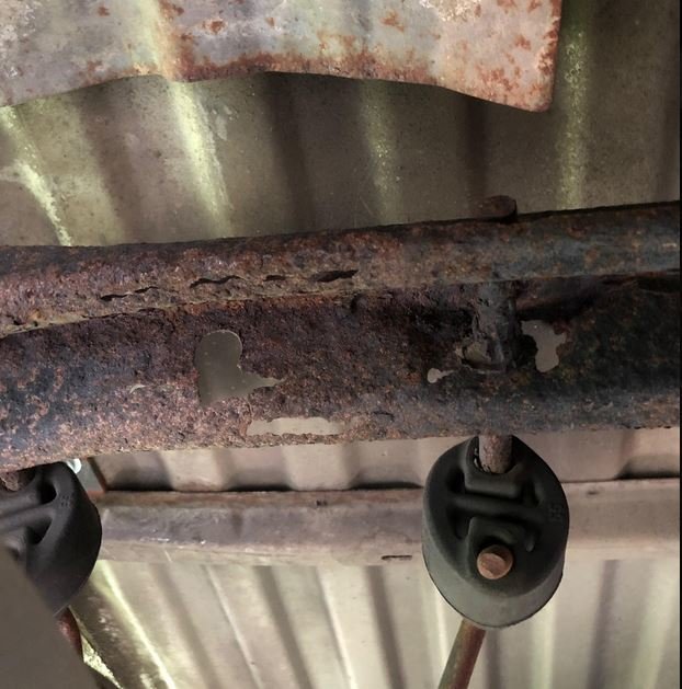

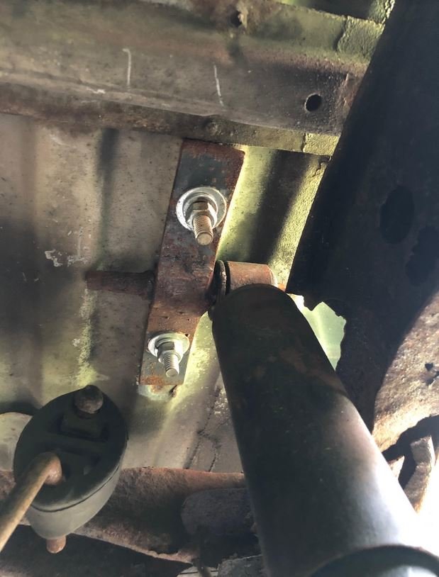

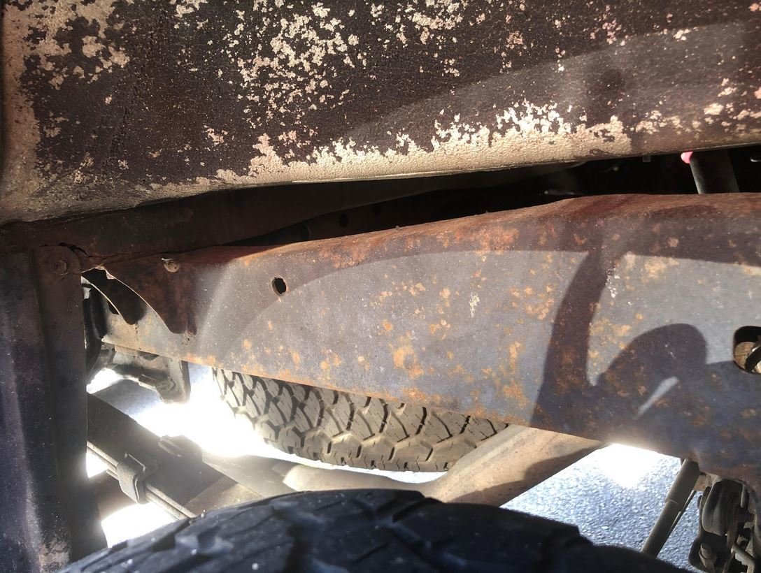

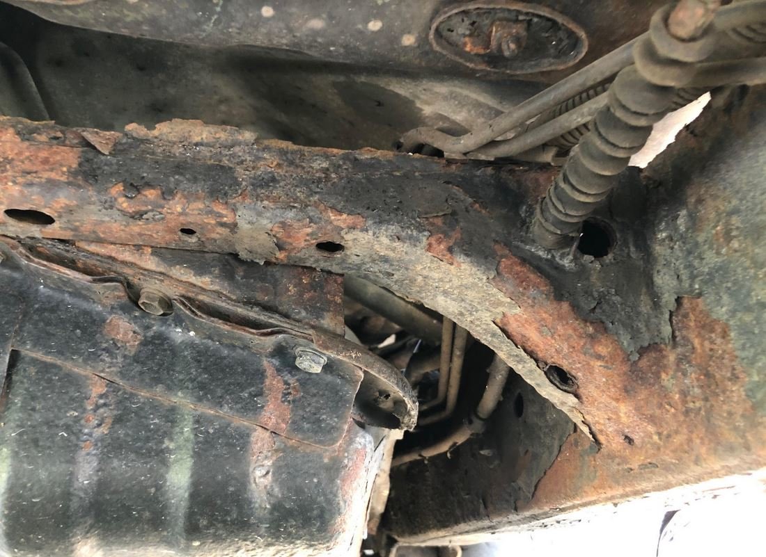

    Here's some more rust, cross members are shot. I'm replacing all three rear cross-members and the bumper too which is also rusted out. Spare tire and gas tank cross-members are ordered, pending shipment from ToyotaPartsDeal. The center bearing cross-member isn't really all that bad but I figured I'd replace it anyway. Not available from Toyota sites, but just processed an order for a replacement from Amayama in Japan. Hopefully they come through.
    center bearing crossmember.jpg gastank crossmember.jpg gastank crossmember2.jpg rear shock - spare tire crossmember.jpg rear shock.jpg

    I'm still in awe of the shock relocation mount.

    South Carolina? That looks like something we drive around in Ohio. Was that truck driven on the beaches a lot or maybe it is a northern transplant. Those relocated shocks are really impressive. I'd like to see the genius that came up with that idea. I see a full frame replacement. My brother-in-law did that with his 93. He found a solid 85 frame and did it in his garage in a couple days.

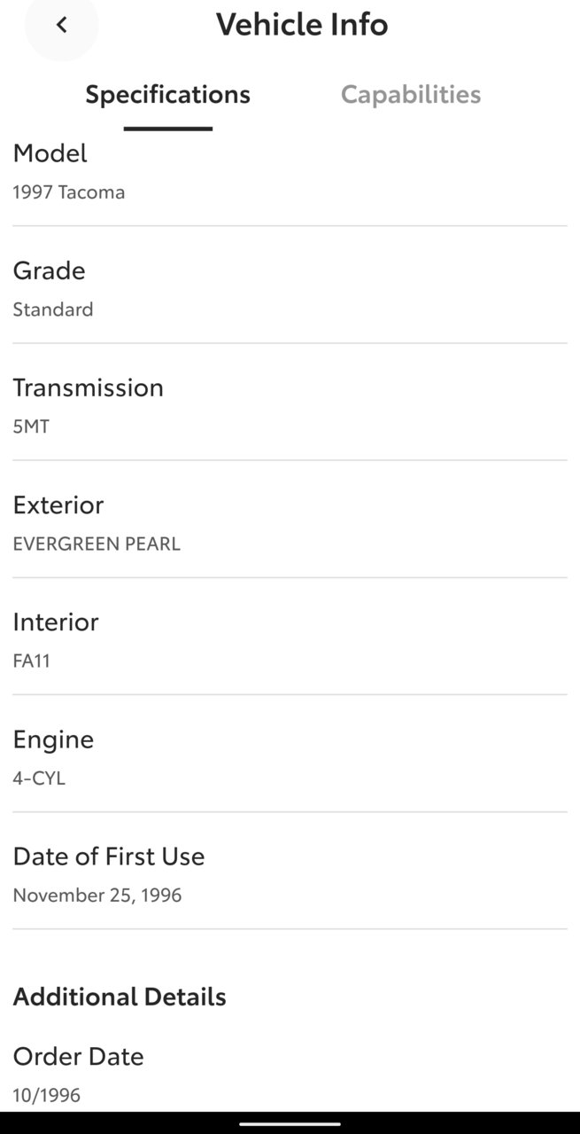

    Download the Toyota app on your phone. Add the truck to your garage and it will give you some good information on your truck.
    This screenshot is my 97. Cool thing is it shows the day I bought it.

    There was a old saying in the weld industry back in the day concerning weld integrity,,,, "welded at and missed,, shit at and hit", you have the latter
