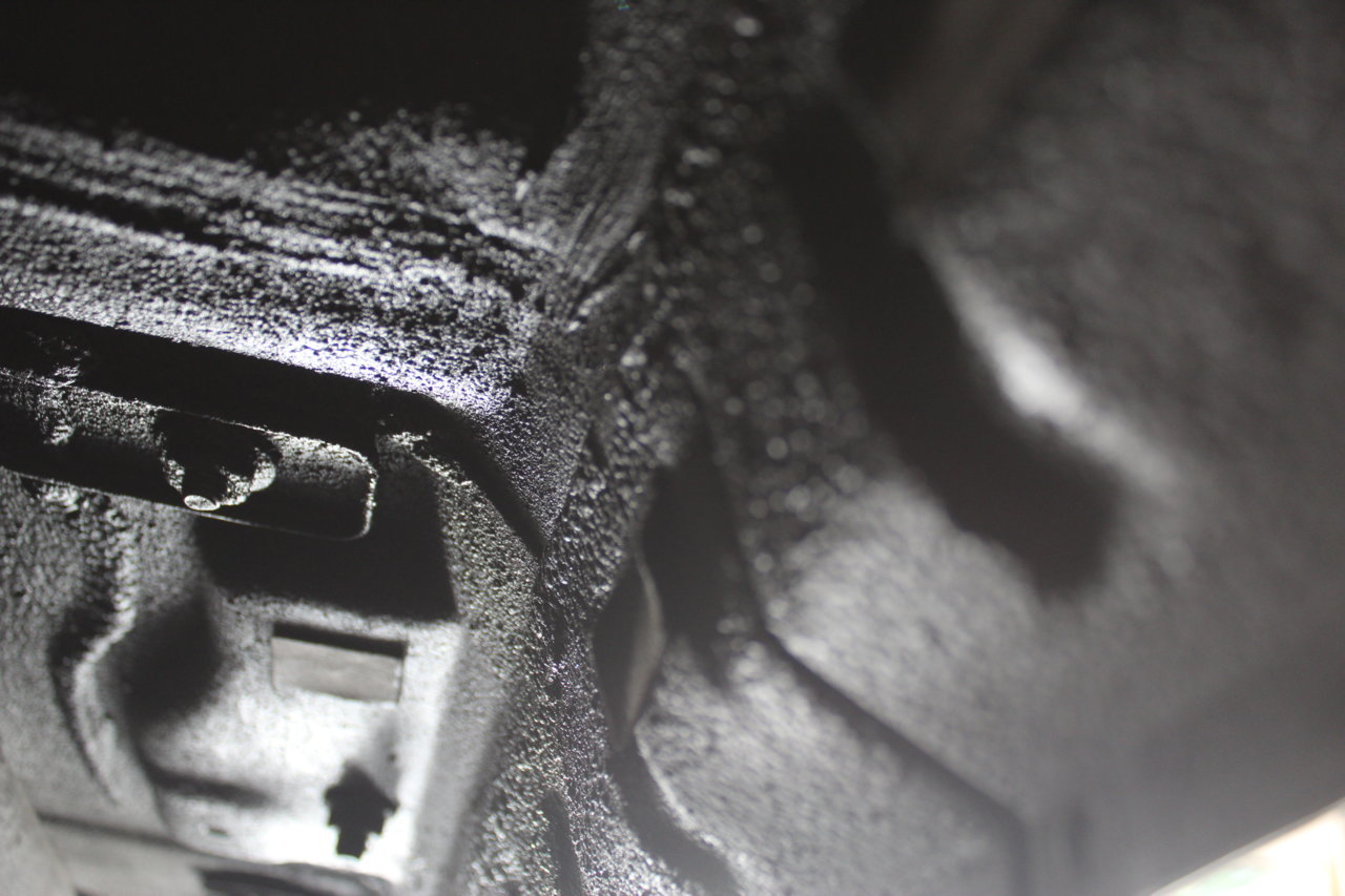

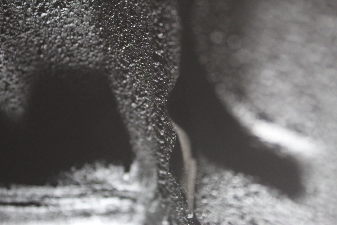

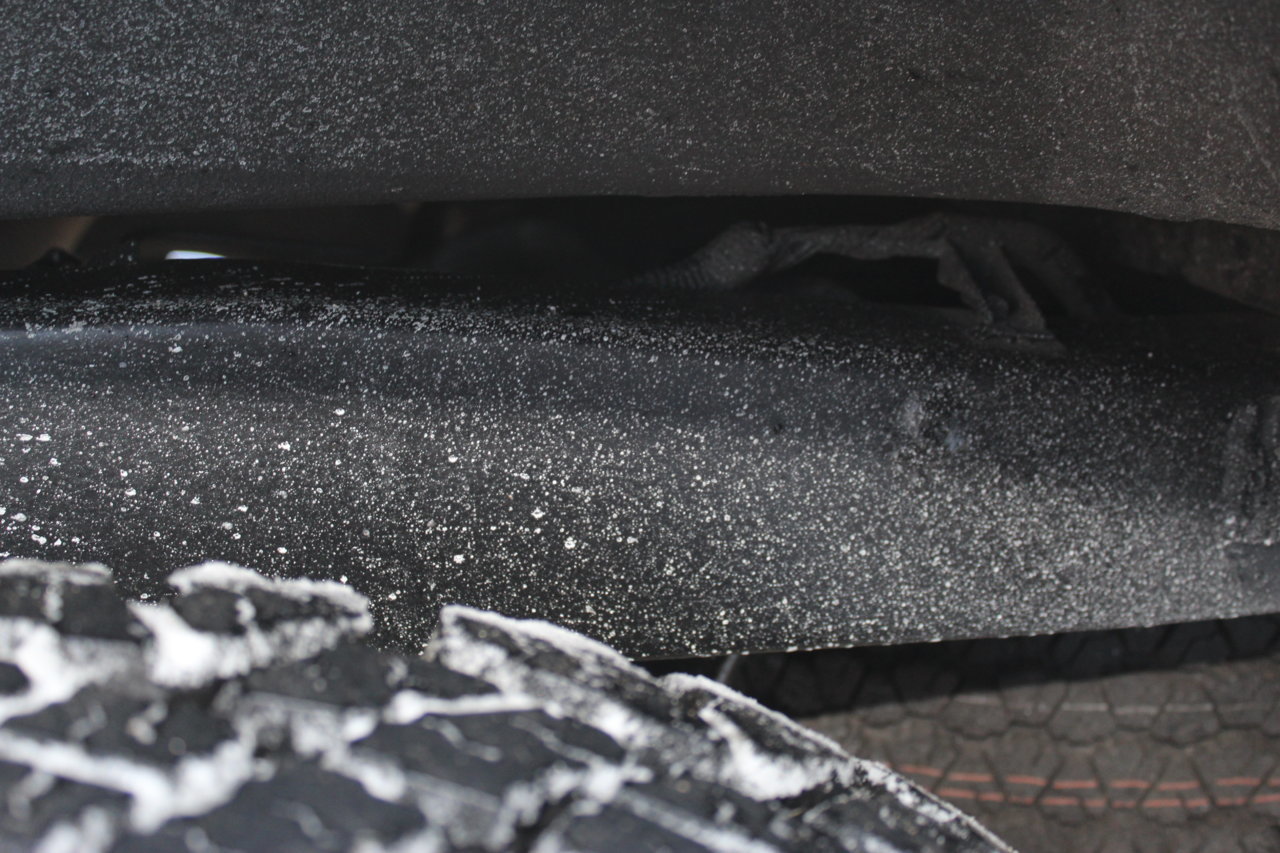

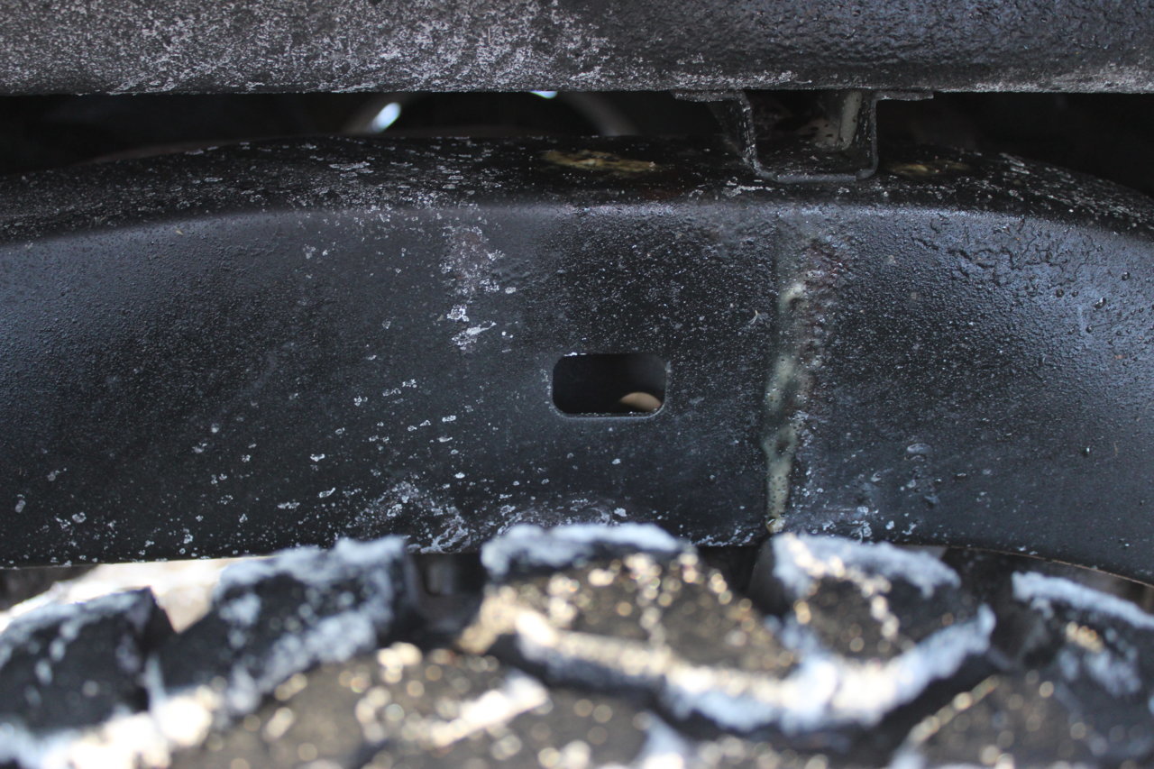

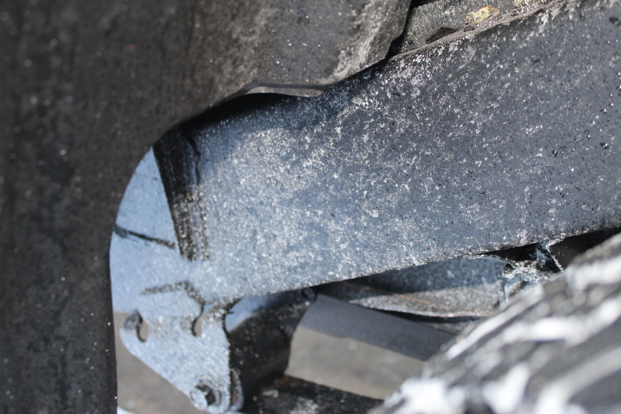

    here are some recent real pix of the 'enemy' (about six months ago) from the western fringes in the mid west Missouri River valley, which is not a cold weather state per toyota lol
    pre-treatment chemicals laid down on the roads for a puny 1 or 2 inches of snow :facepalm:
    the streets were so white crusted for the next several days until it rained and washed it into the sewers
    not much i can do or have done other than power wand-hose it off routinely, most times in sub-freezing temps...
    ^^ some FF attempts to see what it was going to do to this fractured defective coating

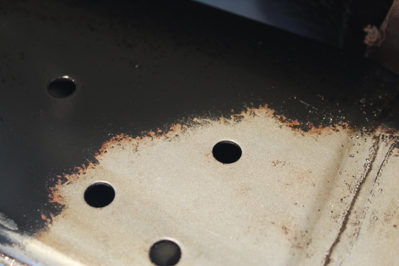

    does anybody have a good explanation for this CRAP i found on the passenger side today??
    it blew my mind when i started finding this garbage!
    what the puck toyota, what the?!
  10. Jun 17, 2020 at 7:21 PM

    black is the factory frame paint and white is bare steel. Repaint it before it rusts

    frame paint garbage
    its rusting underneath that paint that looks good, can you not see it?
    worse than a crappy pee coating!
    decades of humidity with a little salt thrown in?
    i swear there is something in that paint that either rusts on the top and seeps through :annoyed:
    fml

    the reddish layer? looks like primer
    Does not have the texture of rust either

    the heck if i know!
    that coating just shears right off with ease in some parts, some parts are not so easy and do not seem to have the reddish layer underneath
    :notsure: but i don't know
    maybe that garbage primer has rusting properties

    So the paint bubbled and there was rust under there, where you sanded down?
    If it is the case, well, at least it was very mild because the steel isn't pitted or anything

    either its primer or its not? idk lol
    i thought primer was blackish
    its just trying to understand the art of rot
    maybe just spray the naked fresh blasted part with FF and it will not rust again and respray it every year :notsure:
    whats the best course of action?
    i swear this truck is gonna put me in the grave before i turn 50 with this crap!

    Primer can be any color actually. "Red oxide" is a common steel primer and it's actually reddish/brown colored. Depending on the brand/manufacturer it can be brownier or redder
    I guess it is what they used on the frames before dipping in the black paint and it's probably that red/brown layer you can see under the paint in your picture.
    since it's bare unrusted steel, I would repaint the area with POR15 or something similar, then apply Fluid Film

    do you know why the primer seems to not be holding up well in areas?
    is it salty water sitting on and seeping through the paint coating making it de-laminate?
    maybe its extreme humidity? do the other areas of North America that see extreme humidity (but no salt agents) have this same issue with peeling and non-effective primer leading to loss of surface adhesion
