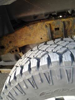

    Salt up here really sucks. I wire brushed my frame last fall, and used Rustoleum paint on it. The passenger side still looks like the day I did it. Here is the driver side, pretty damn ugly and discouraging.

    ^damn son, that looks brutal!
