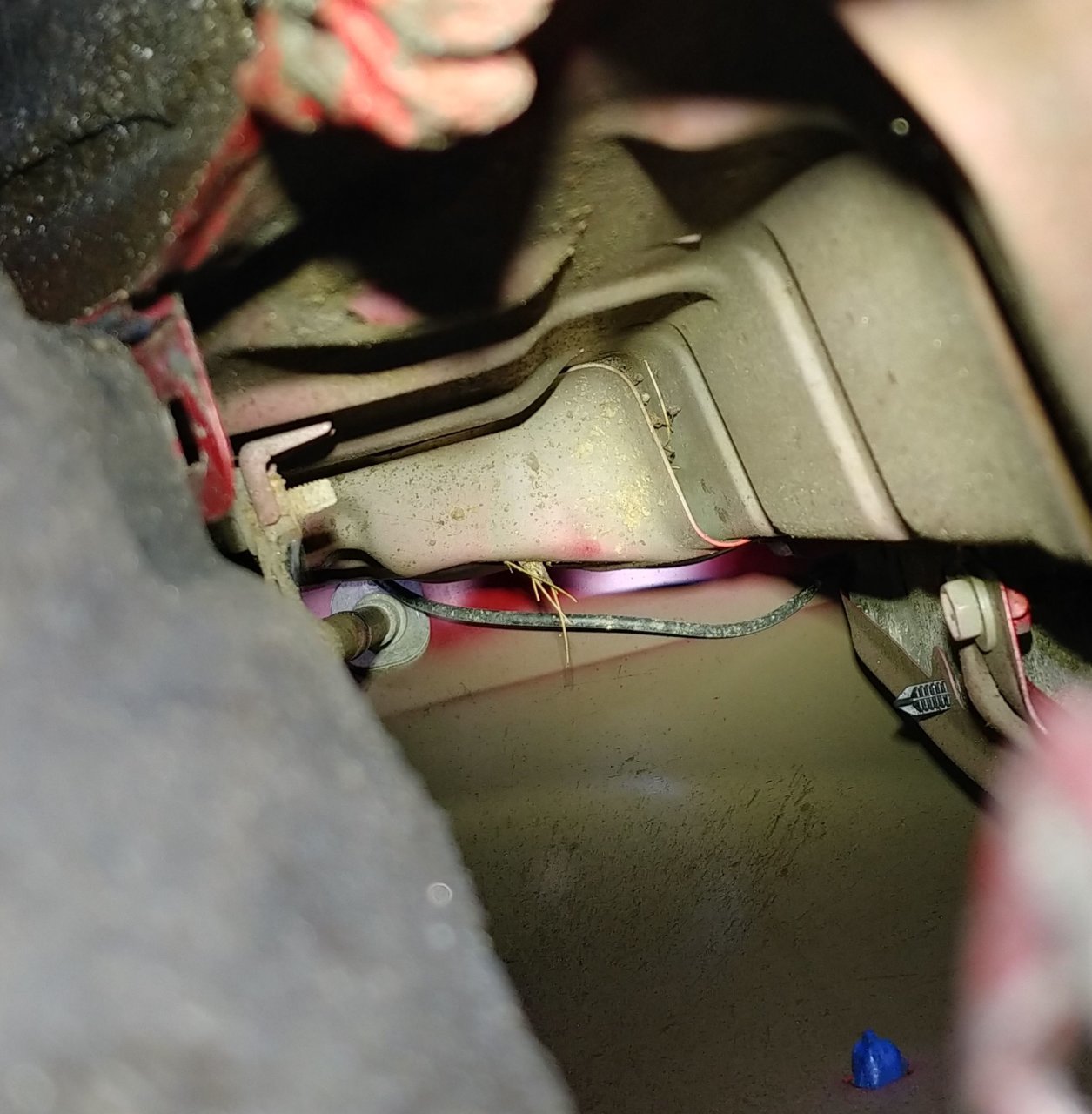

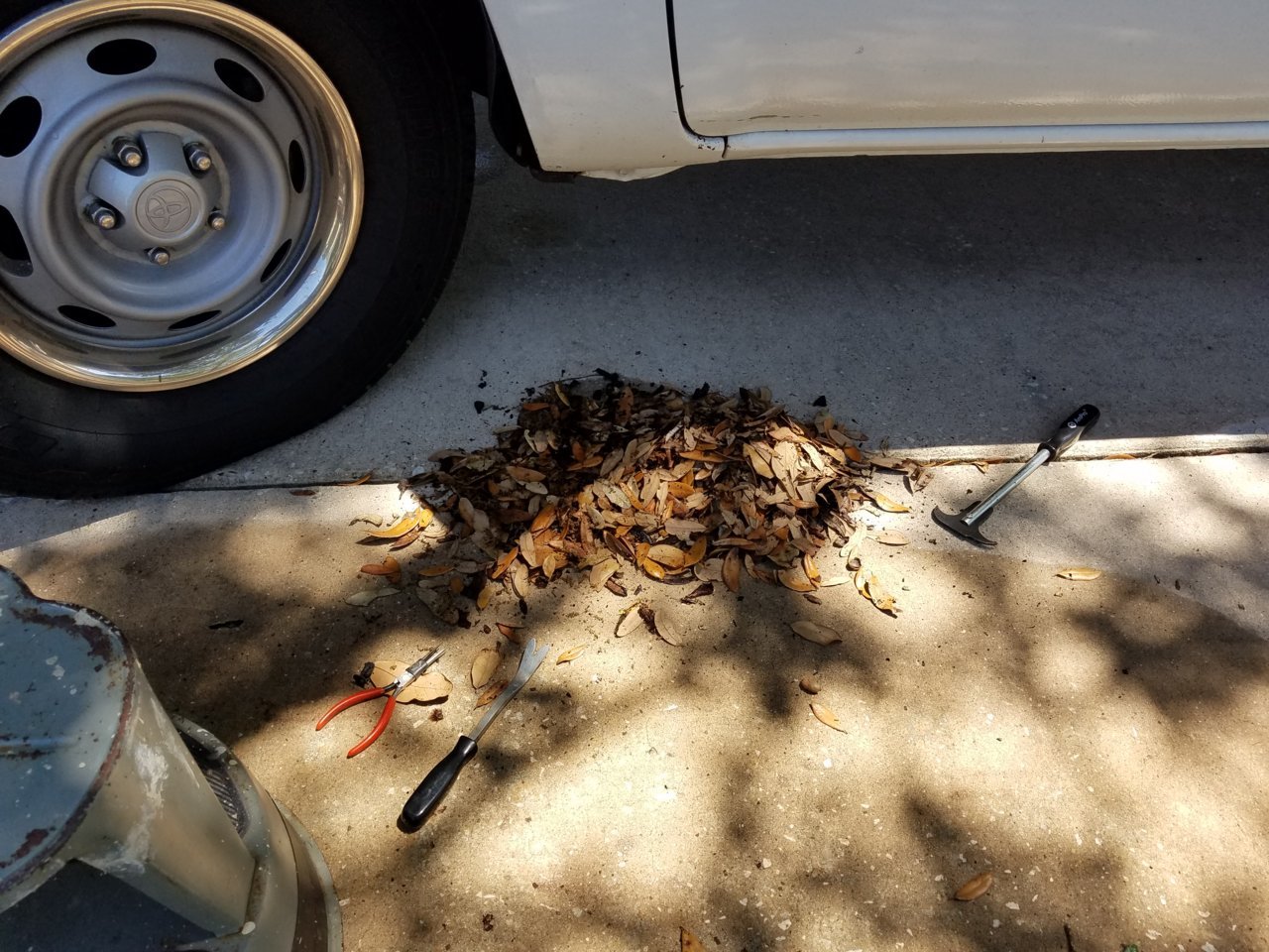

    I released a couple of the lower inner wheel well liner clips, pried the liner out a bit and put a wedge in place while I worked the tools. Then hosed it from top to bottom, then compressed air (which got more leaves)
    With my mods, I no longer get any leaves.

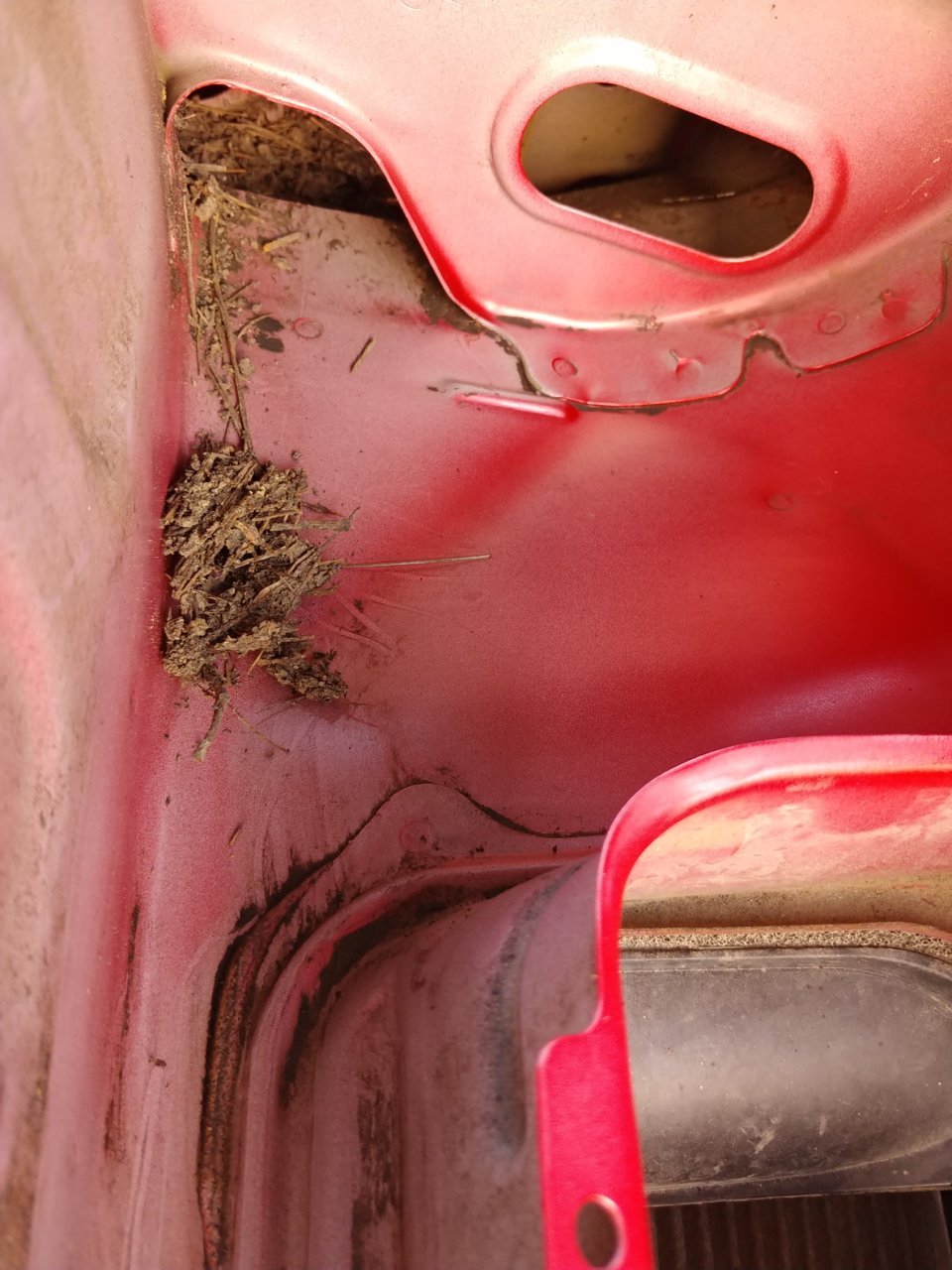

    Wow thats quite the collection of junk. Ran across this thread doing research on the evap core drain.
    Being the NE I definitely need to check this area in the interest of rust prevention. Just to be clear, all that junk came out of the area behind the inner wheel well liner, above the mud flap / cab mount area?

    Correct.

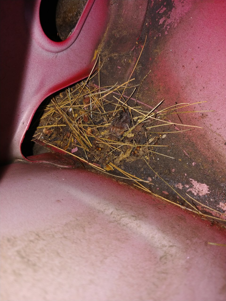

    Pulled the passenger side wheel well liner enough to see that it was all clear. Just a few pine needles nothing else which was surprising. Then I made the mistake of looking up and saw a bunch of crap hanging out from the cowl area. Off comes the wheel, cowl, windshield wipers etc. Did the best I could with a vacuum and pick, but I can see there is still a bunch of crap trapped in that dead space between the cowl 'trough' or whatever its called and the inner fender. Im kind of afraid the only way to properly clean that area in there is to pull the fender. Not sure thats a project I want to tackle. Might be able to get it good enough if the entire wheel well liner came out, but idk.
    Good news is theres no rust yet. Im pretty damn OCD about keeping any leaves etc clear, looks like that has paid off to some extent.

    Drain snake, compressed air, water hose. Once the main clog breaks it will clear easily
