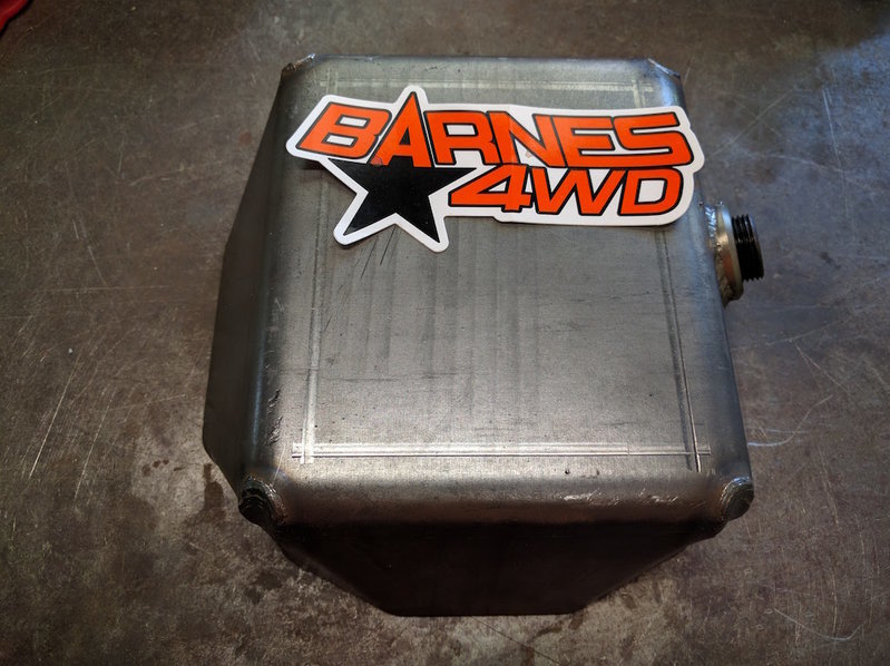

    My North East Taco has been weeping from the diff cover since I got it, ~3 years ago. I have been JB welding etc... every 6 months or so which holds for about 6 months. At the most recent start of weeping - mid-summer, I final decided to fix it for real.
    ordered this a few weeks ago
    Beefy!
    I don't wheel at all, but it's still bad ass.
    Installation is simple o_O - cut off the old, weld on the new.
    Here goes nothing.

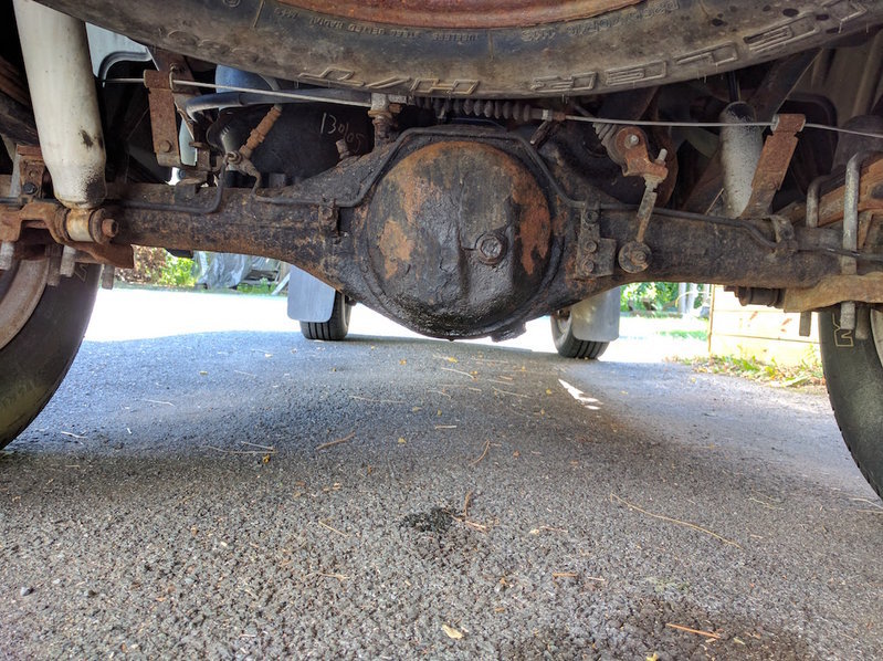

    This is what I am working with:
    Welcome to upstate NY!

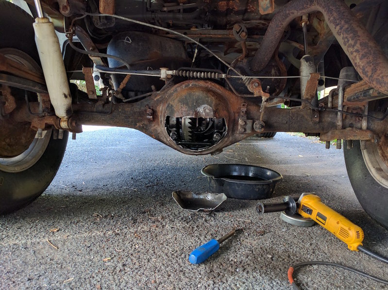

    Prep involved dropping the spare tire, draining the diff, attempting to removed the rear brake line, and plugging in my angle grinder.
    After breaking 2 of the bolts holding the brake line clips? in place my grinder was put to first use cutting the rest. I didn't disconnect the line, but eased it up out of the way a bit.
    I wasn't sure how it would go, so I started easy. My fear was cutting too deep and hitting something inside.
    first cut was the easiest to reach.

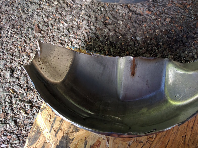

    as bad as the axle looks, the cover was actually pretty solid. below is one of 2 spots that were leaking, you can barely see the hole from the inside:
    MTopp likes this.

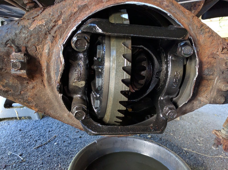

    After the first cut I realized I needed a bit more room to work with. I disconnected the e-brake cables at each hub and pushed it out of the way. I also unbolted the load sensor arm for the BPV and wired it out of the way. Then I jacked up the truck and let the axle droop down so I would have more space above the diff.
    Second big cut got the top half of the cover
    The hardest parts to reach were at 3 and 9 o'clock due to the brake line brackets which prevent a 90 degree approach with the grinder (I should have just cut them off as both are fairly useless at this point.)
    In order to get a bit more of the leftovers at these points, I scored the remaining cover at an angle as deep as I could (easier to approach at an angle) and bent the pieces off.
    I still had about 1/2 inch of cover all the way around. The metal gets thicker at the edge and was harder to cut. With the edge exposed, I was a lot more confident about what I was cutting and so trimmed the final ring around the diff without too much difficulty.
    I still have to grind it flat and prep for welding, but this was about 4 hrs work and I called it quits.
    Stay tuned in a couple days for the big finish.
    Anyone have suggestions for the best method to clean out the inside of the diff when I am done
    I was thinking spray with some thin oil while its open, then perhaps brake cleaner/solvent? Then another oil bath and drain before shutting it up to weld. What do you think?
    Reh5108 likes this.

    I could be wrong here, but given what the rest of the axle housing looks like I'd replace it.

    Yep, you're wrong!
    The cover was $100, priced a new axle housing lately? Even a whole used axle is 1k and up with shipping, unless you find one local. Anything local to me will look much the same.
    Besides, the 1/8 thick diff cover, as seen in the pics, is very solid but for 2 pin holes. It's the thinnest part of the whole rear assembly. Unless I plan to race in Baja, it's got plenty of life left.
