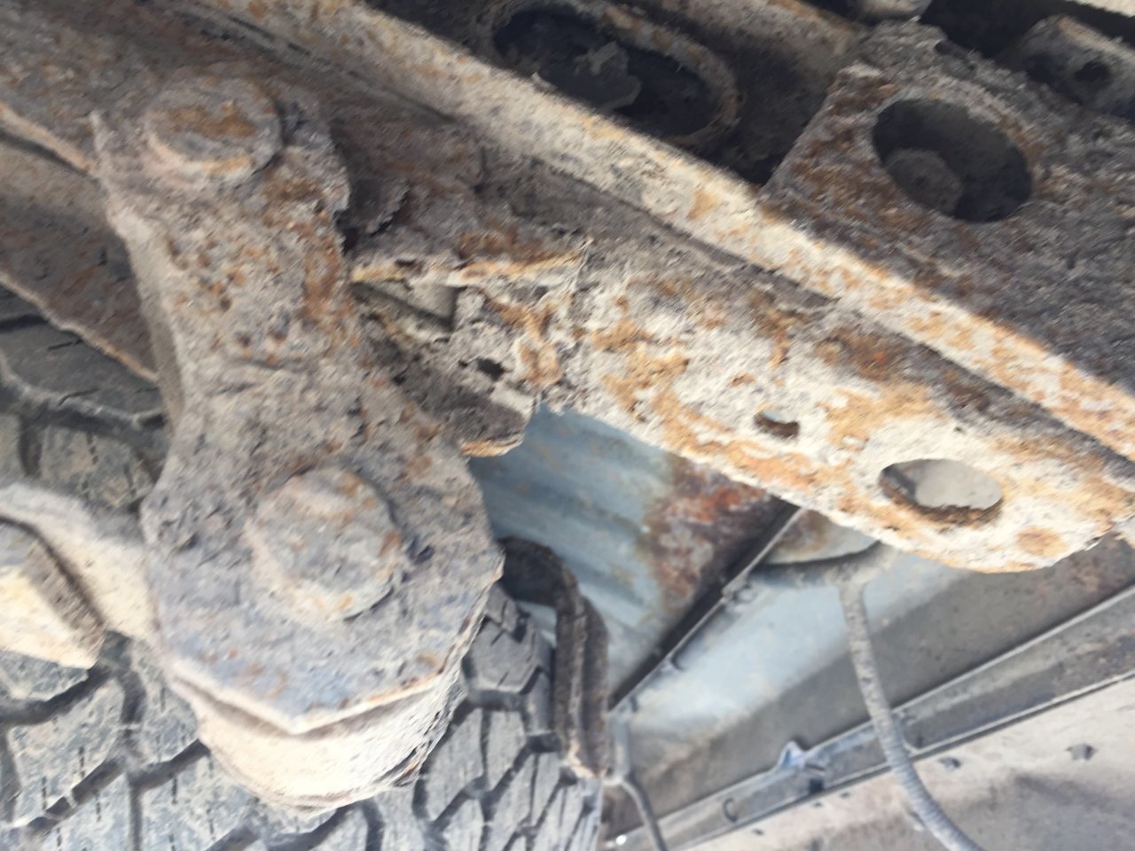

    Jesus christ Marie....yeah those rear shackles look like they're about to give out and then you're in trouble. Careful driving that thing if you must

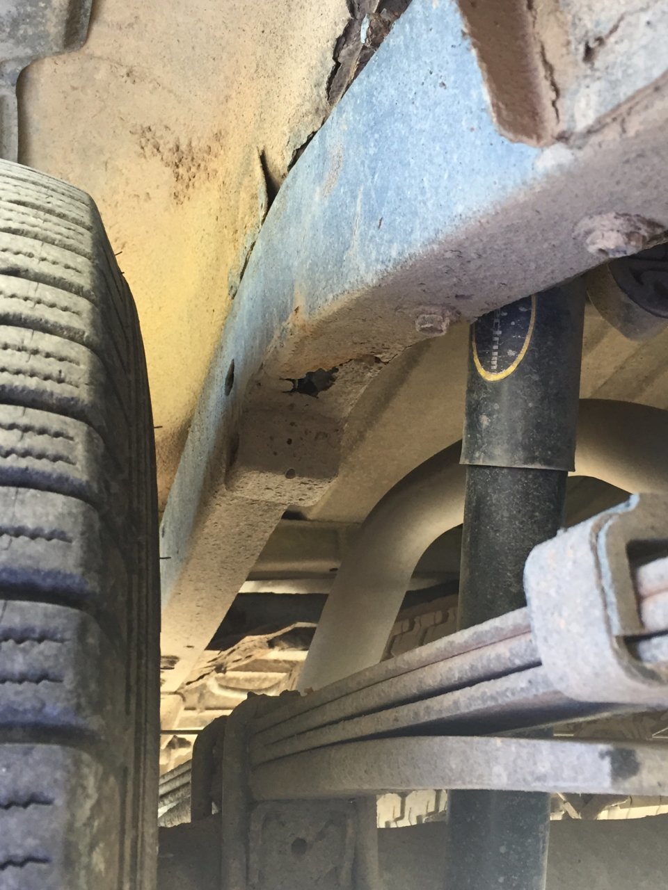

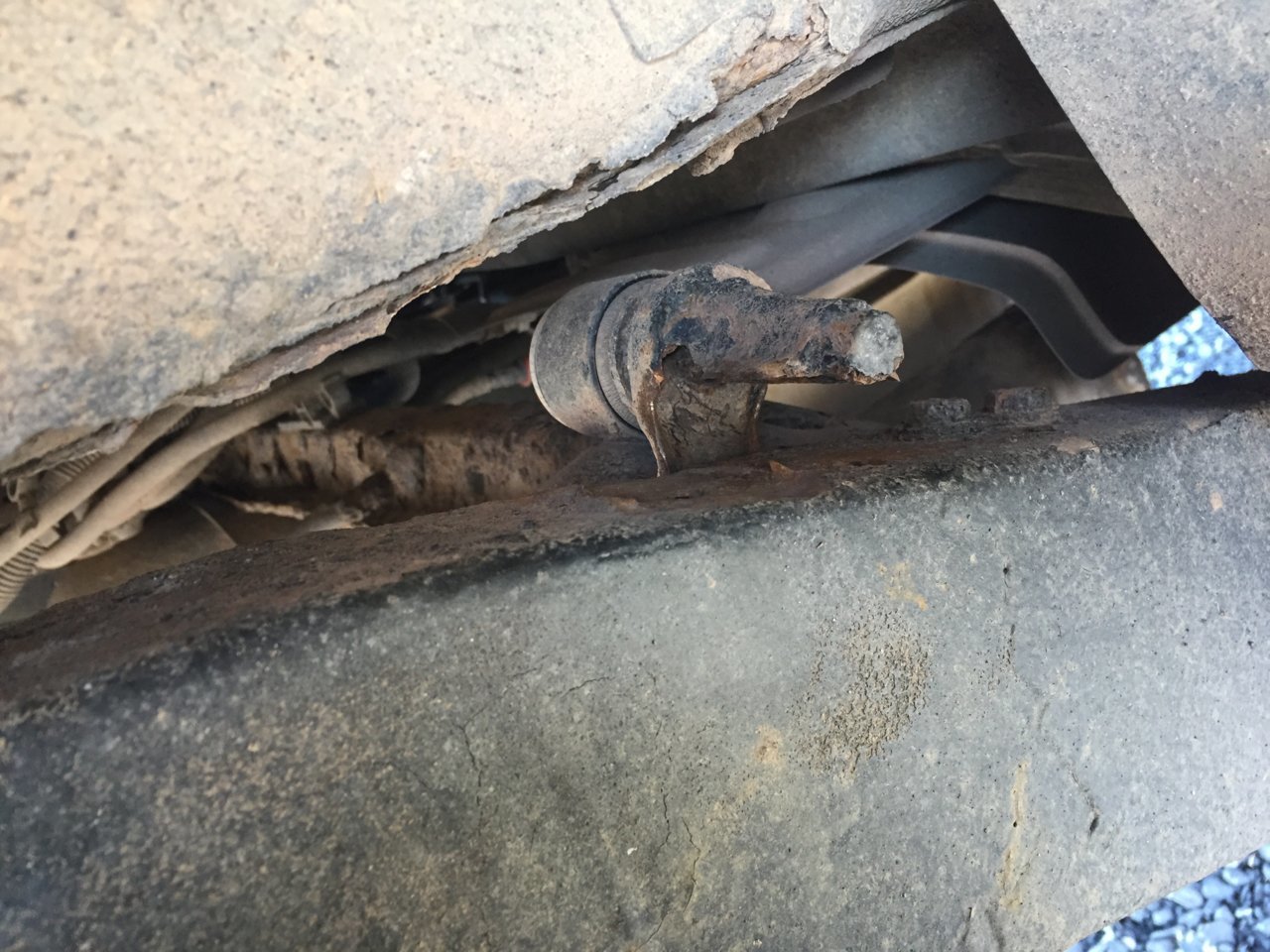

    Did fine up to 98 on road. Was fine off-roading until shock broke loose. Lot of rust everywhere, it’s cold so those are a couple pics. Gets a little out of control if you hit bumps when crossing bridges

    Yeah I bet...honestly the first pic you posted doesn't look bad at all, but those rear shackles are rusted bad especially where the mounts were welded to the frame...if that snaps off while driving you're going to lose your rear axle, and that won't be good especially if you're going fast. I would take it to a competent welder and see what they say they can do...be prepared to pay for quality work though, assuming they want to take the risk of working on it.
