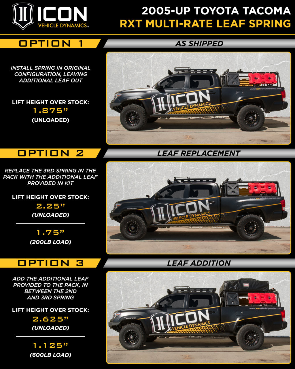

    I am currently running the Icon AAL with OME shocks. I noticed last weekend with the bed loaded with 2 dirt bikes and gear it is squatting pretty bad. The RXT springs would allow me to run more weight with less squat correct? What is everyone's opinion on the RXT as a stand alone spring?

    The RXT system will provide more wight carrying capability however the ride higher will be higher when the vehicle is unloaded.
    Here is a photo for reference:
    As you see the RXT can be set to accommodate different static loads @ different unloaded ride heights.
    Feel free to give me a call directly if you'd like to go over the specifics in for detail.

    Can I keep my OME shocks and run them with the RXT springs in the 2nd configuration?

    That is an option, you can run a stock OEM shock with the RXT Leaf System you just will not have access to the added wheel travel provided by the leaf pack.

    Anthing i should look out for adding sumosprings and a u-bolt flip on icon rxt's?

    All of them.
    J
    Just make sure you won't be limiting your up travel to much

    I have Rxt's with OME nitrochargers at the moment, if im correct the OME's already reduce there downward travel?

    I am actually right in the middle at 400 lbs. I have a canopy, Rtt and some camping gear totalling near 400. Would option 2 work. I do enjoy the rake look so 1" lift in the rear would be idea for me. Any shocks you recommend to take advantage of the extra travel? Thanks
