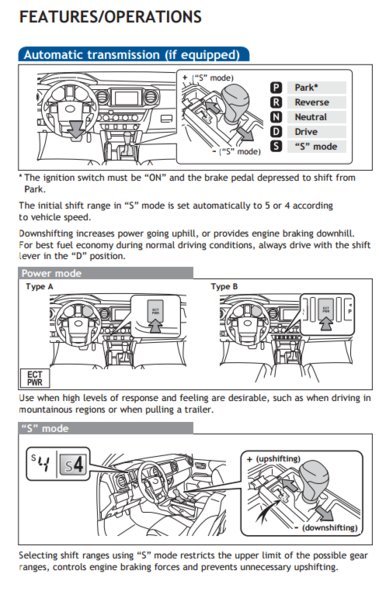

    The manual says it will go to S4 or S5 depending on the speed, you can try seeing if you can hit S5 at higher speeds if you want though.
    I usually keep it below 60 when I go D to S and it's always been S4.
