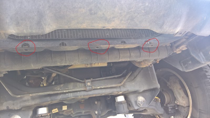

    I don't think so. Plus itd be a giant pain any time I had to pull the skid plates. Unless you wanna weld some new nuts in place for me lol. I'll have to play with it. I'm gonna call Toyota tomorrow and see if I can get the bolt specs to see if I can just run helicoils. I'm hoping I can put helicoils in with some locktight and be done with it
    google FTW
    if anyone needs to know, skid plate bolts are m8x1.25
    adding notes for myself tomorrow. A 21/64 drill bit is used for installing a helicoil for that bolt

    First thing first sorry for spammin up the thread. Second, I'm beyond a helicoil, the drill bit fits through the hole like a hot dog down a hallway :(. But if I'm looking at all the mounting spots right, it looks like there's nuts that are tacced to the mounting points. So hopefully I can heat em up, remove em, and have someone weld new ones in place

    There are two under the lower control mounting bolts
    There are three in front behind the front bumper

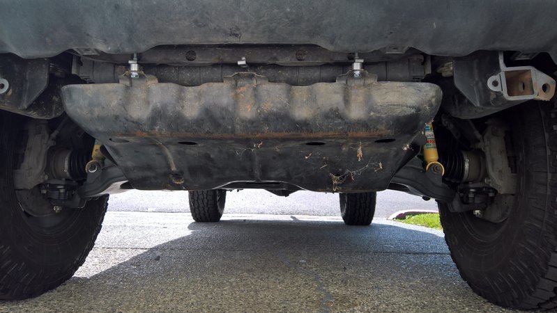

    Got my skids remounted. I don't think it will hold an aftermarket 3/16 plate skid, but it will work for now!

    If you want to look at it, by all means. I understand the busy schedule and wouldn't want to tear you from the more important things in life. I think all that would be needed to fix it would be new nuts. I used a propane torch and air hammer at work to bust the old nuts off. Since I have no welding skills, I bought a few j-nuts and mounted it with those. From what I can tell, it's pretty secure. Like I said though, not sure I'd trust those j-nuts with 3/16 plate

    Hello David... as long as when the new nuts are in position and I can get my tip of a wire feed welder in there also, shouldn't be a problem. I would up grade to a grade 8 nut for this.
