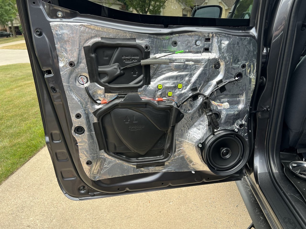

    Crutchfield said my AudioFrogs wouldn't fit either (Front or rear) and they ended up fitting just fine. I did have to create two of the four holes on the trim ring (for the 6 x 9's ), but that was cake.
    Here's a shot of the 6 1/2's. So don't always trust Crutchfield's configurator to be %100 all the time.
    jyblMDF3Vr-ZT27y2QrRCTttntWpELf1EYCsWBeK_326fd0922461275c2f5ad6743a4ec5affd08f011.jpg

    Yeah, the problem with their configurator is that they don't say why something doesn't fit. Some issues would be critical, while others would not.
