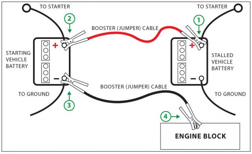

    I was taught to always hook the ground to the vehicle being jumped last and use any ground point other than the battery post.

    Sparks and a bad battery leaking gasses are no bueno. Start with the good battery and hook up in the following order to reduce sparking near batteries.
    Positive of good battery, positive of bad battery, negative of bad battery, finally ground of good vehicle.
    Remove cables on reverse order. Obviously ensure the clips on the other end aren't grounded when connecting.

    I can't tell you how many times it's gotten awkward because I've had to repeatedly say "hands off, I got it." (Seriously, I'm the donor, I don't know your level of expertise, don't fucking touch my cables). Some people have an innate psychological desire to not only lay hands on it, but they need to leap two steps ahead so that they don't feel so helpless or something.
    The jump pack protects the victim from rat-fucking my truck. My hood stays closed. And if they yank the alligator clips out of my hands (yes that has happened) then worst case, they fail to jump start.
    If cables are the tool you have, despite the proper sequence of neg-neg, pos-pos, trust me when I say walk those cables to their vehicle first. Wait until they're done touching it and already leaping into the driver's seat before you even walk the cable back to your truck.

    @tonered and @ColoradoTJ have already showed the way to do it, but I would like to add ALWAY double check polarity of the vehicles and batteries before making any connections. I once attempted to jump start a European vehicle in a dark parking lot for a coworker. I got better lighting when the clamps started glowing red hot!!! Turned out the damn thing was a Positive ground system!!!
