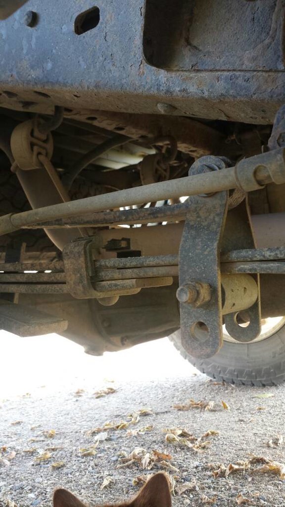

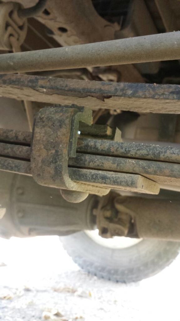

    Here's my 2011 TRD OR 4x4. I did have the rear leaf TSB done 2 yrs ago. Sorry for the bad angle...best I could do with the wheel on. I think it shows the clips. Oh...the recall currently doesn't apply to my vin.

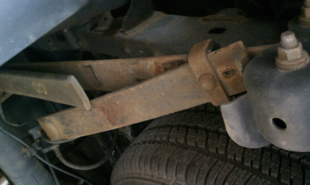

    Is this the clip they're talking about? This is on my 05

    I like how your cat is trying to assist you. And yes, that's the clip they are talking about. There needs to be a second clip on the overload leaf to prevent a broken leaf from shifting out of the pack.
