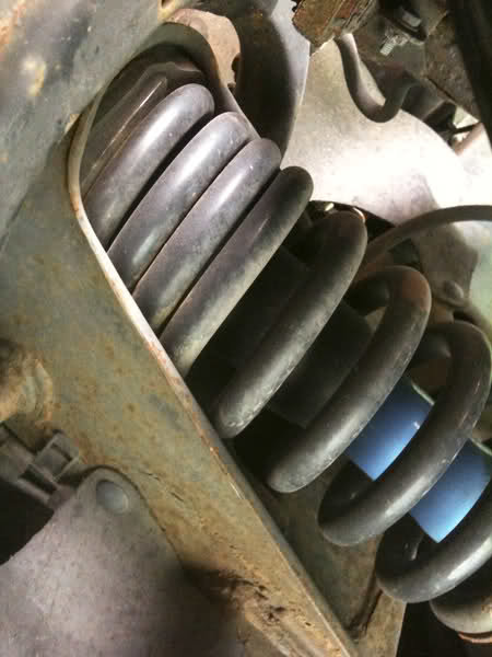

    I'm looking at buying an '04 DC TRD and noticed the front springs are sagging towards the top. Both sides are like this. The truck only has 46K miles on it though, so I'm just wondering if the springs will likely need replacement?

    That's normal. Those are progressive rate coils. They're suppose to look like that.

    I can understand progressive rate coils, but I've seen pictures of other springs from the 1st Gen DC TRD and they aren't that bad at the top of the coils.
    This is the space at the bump stop, doesnt seem like much travel:

    Those will need replaced. Mine were like that on my TRD when I got it, but not nearly as bad.

    The springs need to be replaced. There should be space about 1/4 inch or more at least between the top coils under weight. Progressive springs just have less space than others but there needs to be space for them to work. If that truck hits a bump there is no room left for the progressive coils to move.

    those need replace, progressive spring are at the bottom where they look compress not the top.

    yeah...those are sagging...lol
    Looks like its time for some OME suspension

    I've gone to check it out in person and it is super clean. Seems to drive fine too, but I've never owned a truck so idk what taco's drive like. The suspension is definitely done, but I have an OME light duty kit planned for it anyway.
