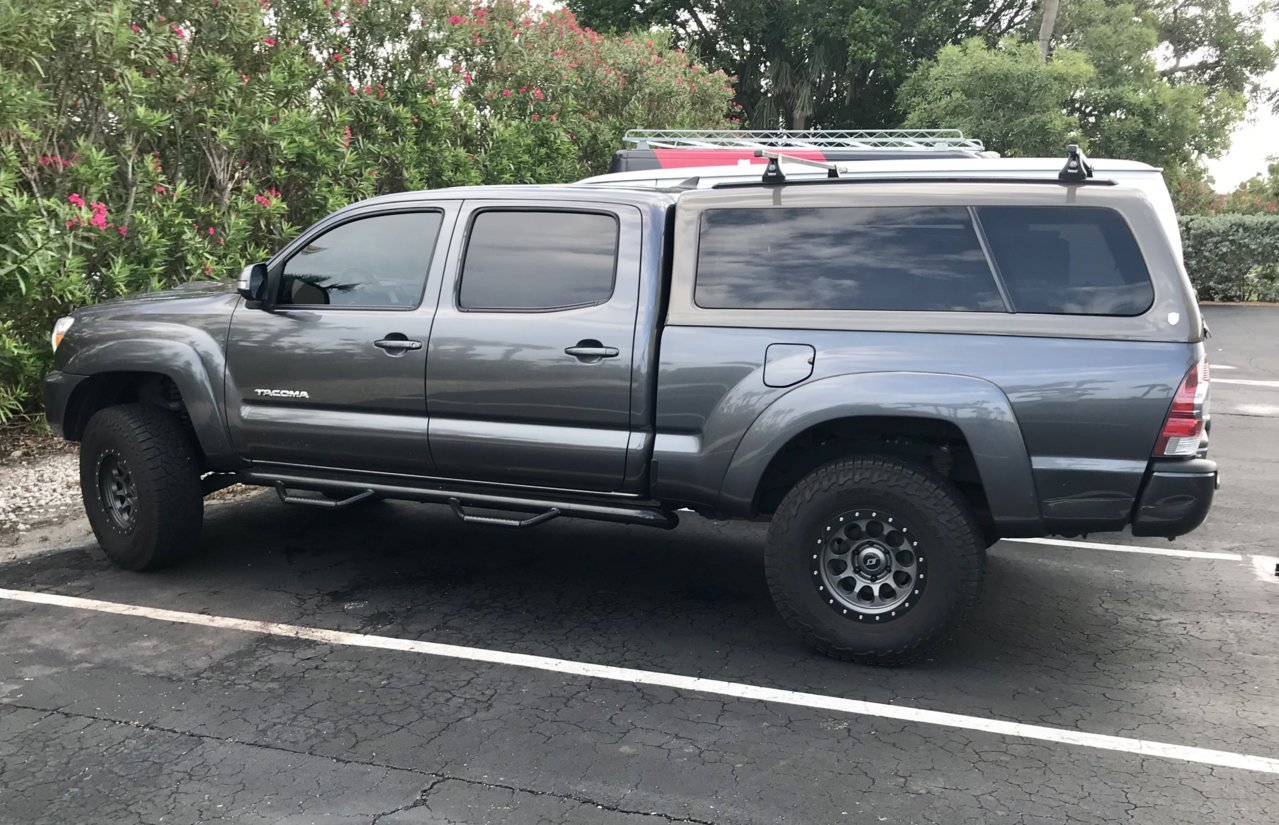

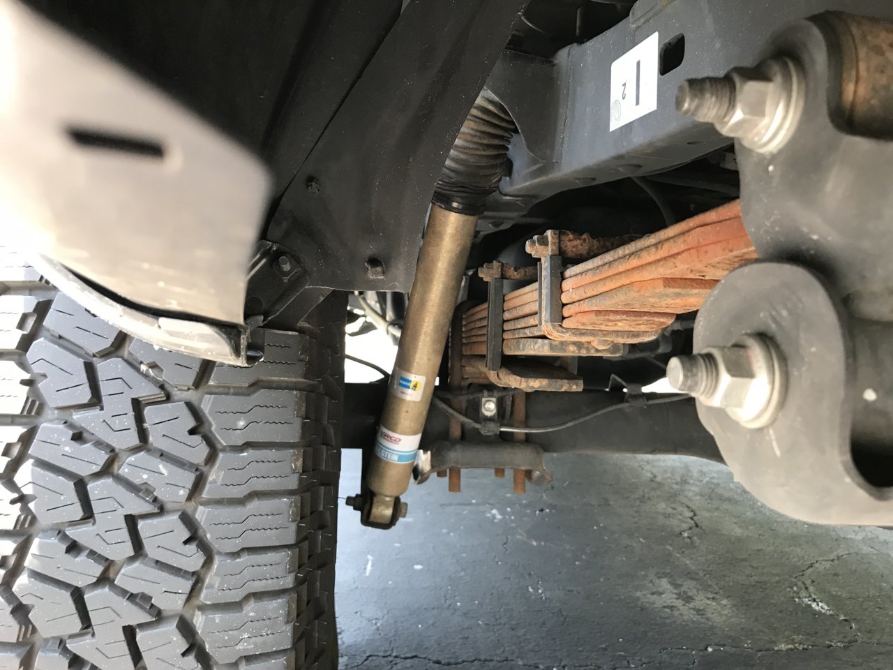

    Quick question for y’all.

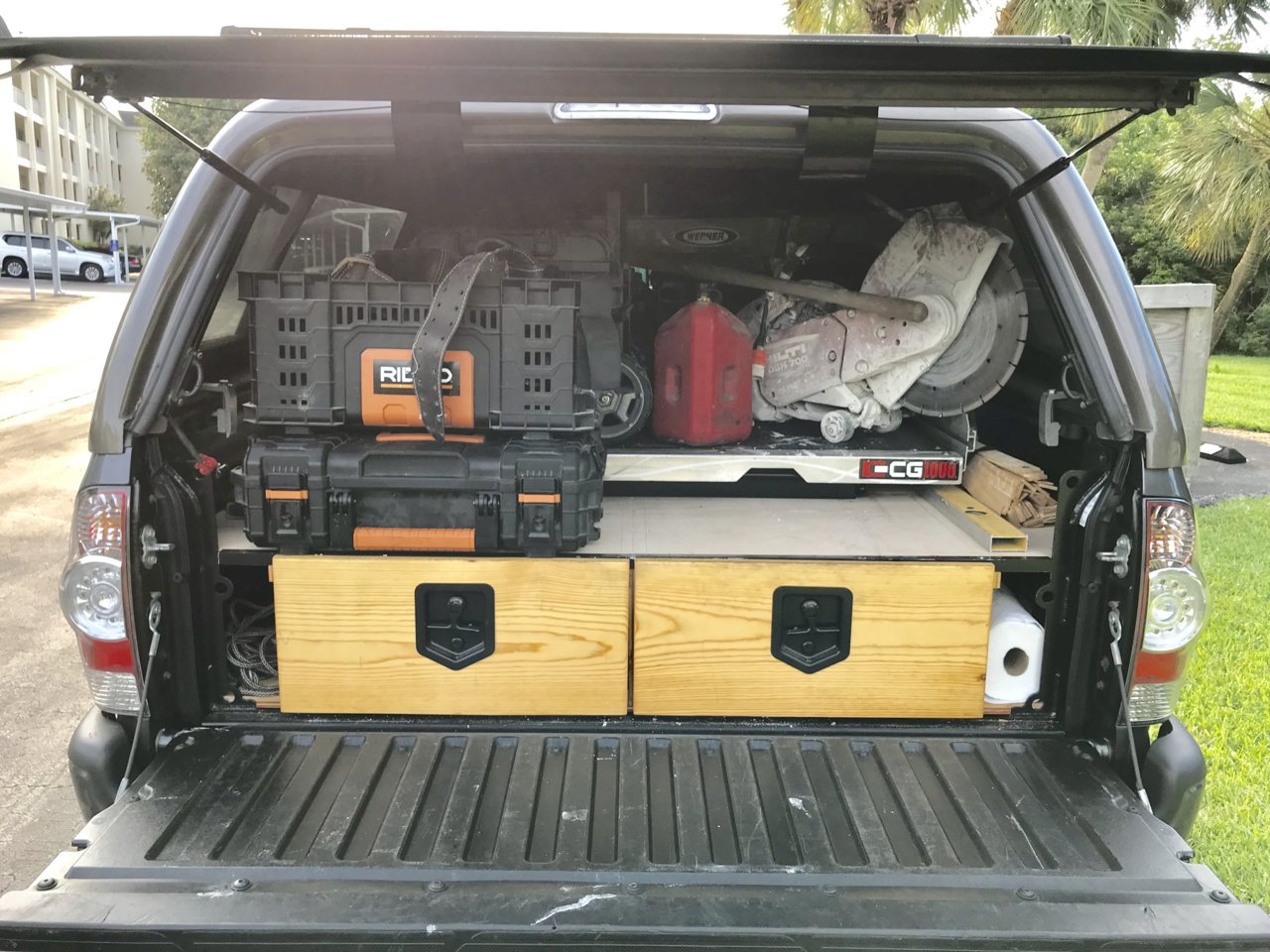

    I have HD Dakars but I have recently added a cap, drawer system, bedslide and a shitload of tools.
    I am not sitting level anymore. Can I add another leaf or do I bag it?

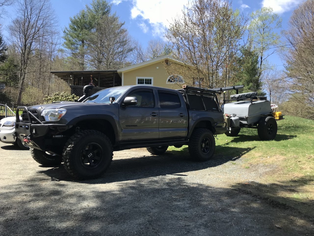

    You can add the Dakar add a leaf. That’s what I did.
    I have a lot of weight in the ass of my truck too.
    So, I have 6 leafs and two over loads now.

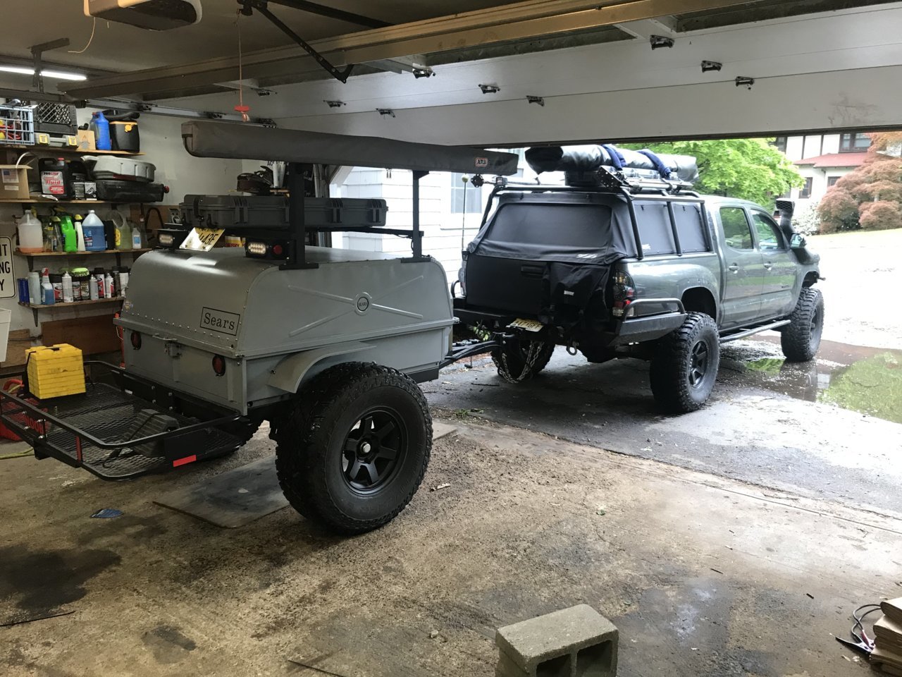

    That’s a bad angle...
    This is a little better.
    That’s with a full aux fuel tank in the bed, tools, spare parts, 35” spare, extra one piece driveshaft, recovery gear, High-lift, steel bed rack, etc, and my trailer on.

    how much weight are you hauling around? that pack is super flat

    i just put the el096r pack in mine. I have a cap, prinsu rack and 55" awning and it has road very well so far with the 200 lbs i have on the bed, not soft or bouncy. My drawers will go back in next week, i guess well see how it goes then. how many miles are on your old pack?
