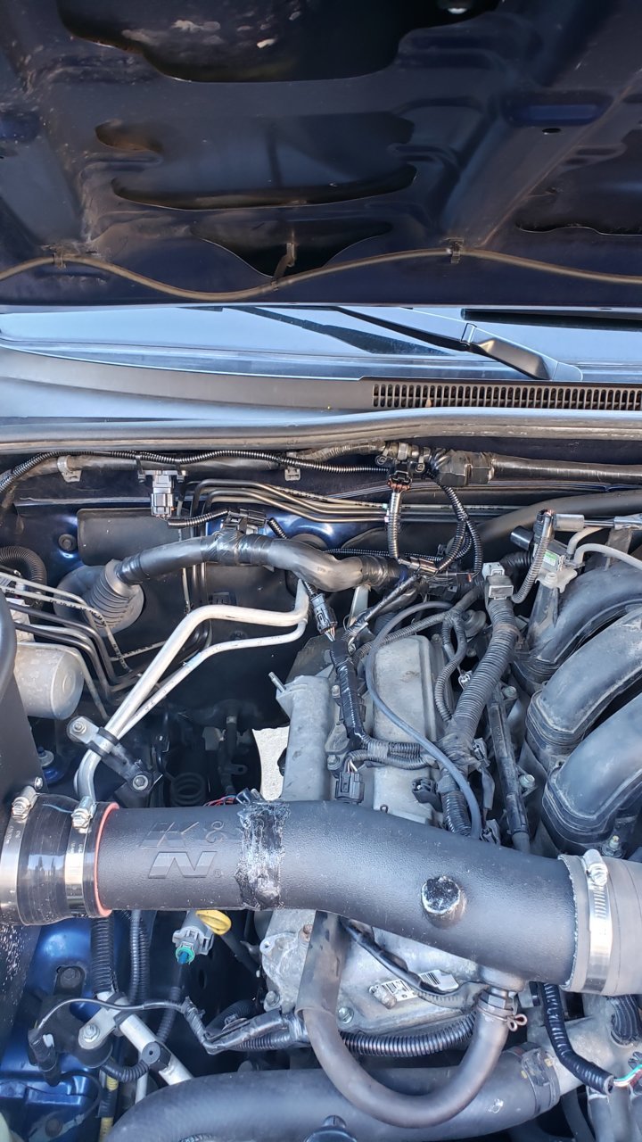

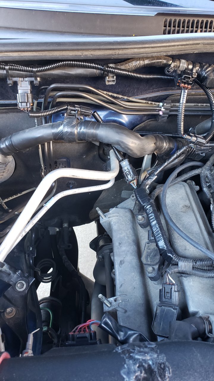

    Hi Guys, as I search the tread about this bypass and not much ppl in here use it and give review about them, may be I will be the first then.

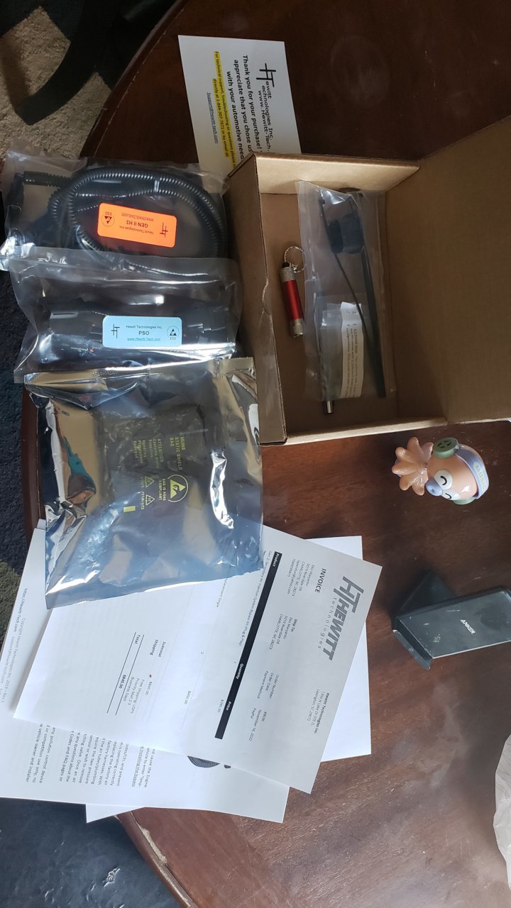

    As some member knows my taco got limp mode and got code P2433 and P2438 which malfunction air injection valve, my pump still work perfectly so I looking for the parts from dealership cost me $1200 and I read about HThewitt bypass sound promising plus way less then dealership price.
    So I order completely full delete SAI system bypass 20 days ago and I install it 2 week ago and once I installed completely that day, I don't even need to crack my engine just turn my key on position my engine light went off, work like champ!
    I had been talk to they tech support about how durability this product or do I need retape all the wire to protect from heat or water. They said it come life time warranty as long as you own the vehicle and the product meet the oem specs for wire as long as you following procedure installation.
    So far I'm happy with the product no more limp mode which is annoying bc sai system plus I really don't use this system as I use aftermarket headers so more room and my taco more quite no more pump noise.
    Hope this help you guys who's still have doubts to this product.

    Was it difficult to install? Definitely the route I’m going if mine takes a dump.

    Is plug & plug... just follow the instructions and u good to go.

    just a little feedback, I’ve been running my Hewitt tech bypass for two years now without a single issue. They even provide plug caps for the plugs that are no longer used. It’s a nice quality kit imo
