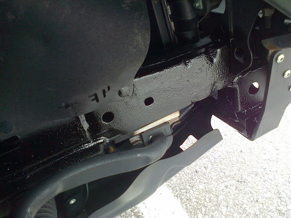

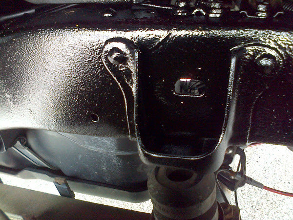

    I had the dealer spray the inside of the frame with the same stuff they used for the 1st gen recall, but without the etchant. On the outside of the frame, welds and exposed areas are sprayed with "normal" undercoating. Not touching the body - experience with 1st gens suggests the body will remain prestine for 15+ years while the frame can rot.
