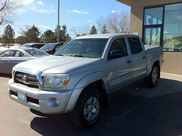

    The day I adopted Sam:

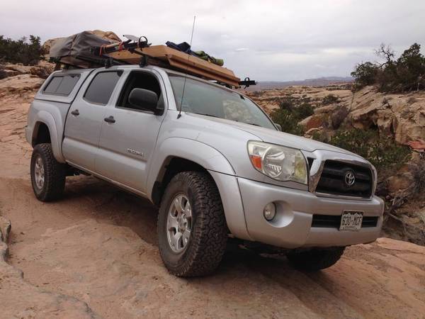

    Less than a month later I had some roof racks on the cab and drove Sam out to Moab:

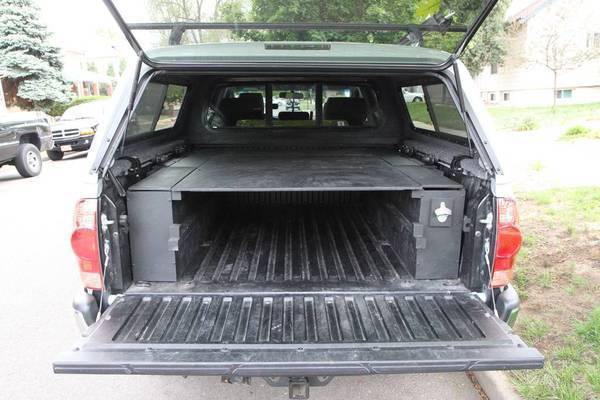

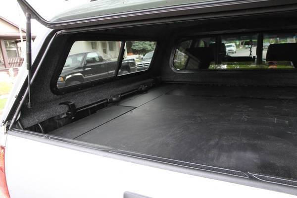

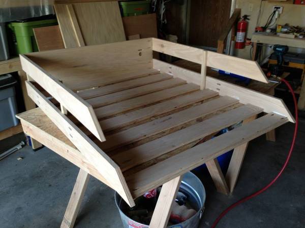

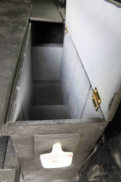

    So, then I got a topper (ARE) and built a cabinet/storage system:

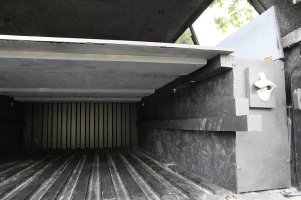

    The main goal was for it to look like the bed was empty when it's all closed up. I live in the city and unfortunately have to worry about someone helping themselves to anything I leave in the truck:

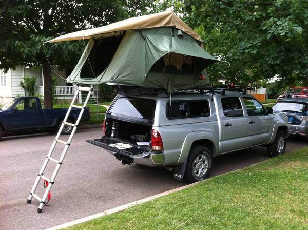

    Then I got a roof top tent from Tepui:

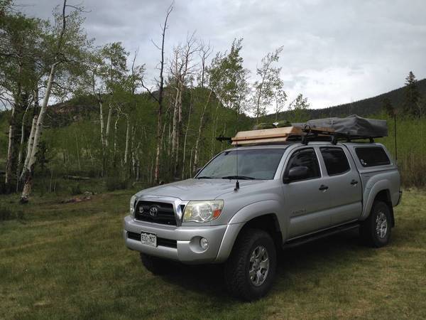

    So, my girlfriend, our dog, and I finally got to use the RTT. We headed up to a spot on the Switzerland Trail for the night.

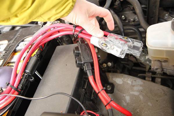

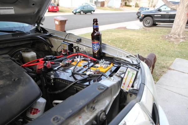

    It's been a while since I added anything to my truck... Over the last week I put in a dual battery system and some knick-knacks:
    Here's the system as it sits in the engine compartment:
    You can see the National Luna Intelligent Solenoid in the background. The controller now lives in the little coin tray on the right side of the steering wheel.
    There's a total of 3 lines coming off the aux battery thus far. One to a fuse box in the cab, one to a fuse box in the bed, and one to where the inverter will eventually be (under the passenger seat):

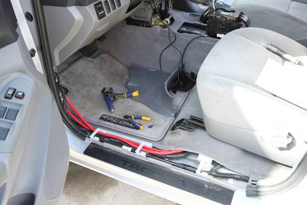

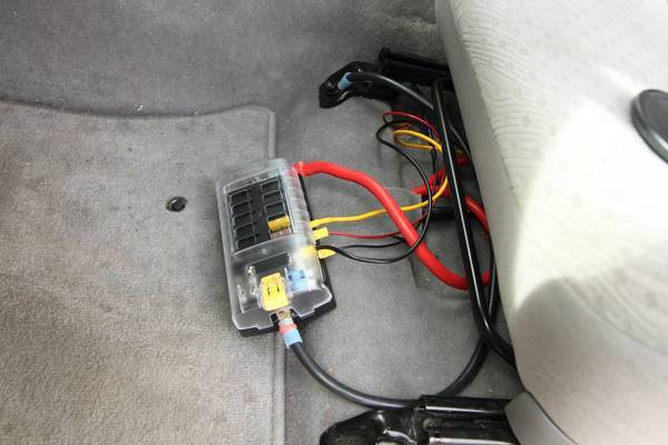

    Here's the fuse box in the cab. I just put it under the driver seat. It is grounded to the seat bolt:
    The wiring for the fuse box above and for the inverter that I don't have yet:

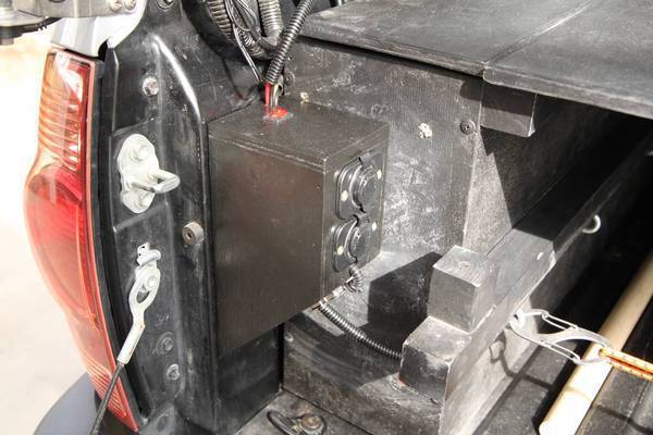

    The fuse box in the bed:

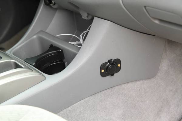

    A blue sea 12v cigarette lighter port and USB port. Both running to the fuse box under the driver's seat:

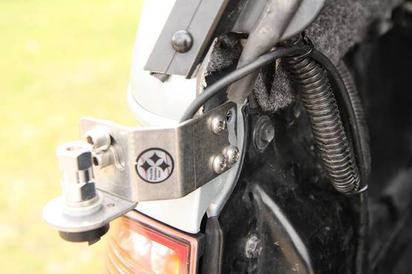

    While I was doing this, I went ahead and put in the wiring for the CB antenna. Will install the CB radio in the next couple weeks:

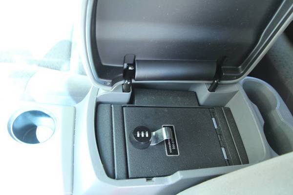

    Love my Console Safe:

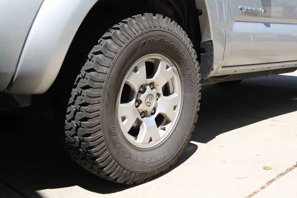

    New Shoes:

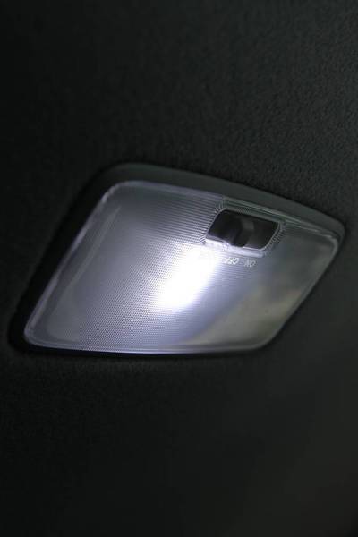

    LED Dome Light:

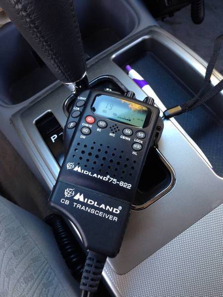

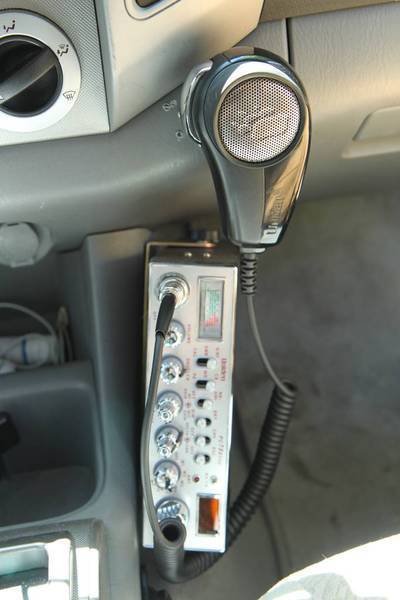

    CB:

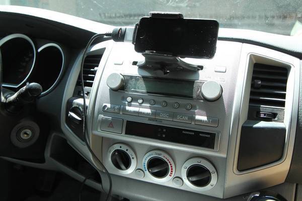

    Great little iPhone mount:

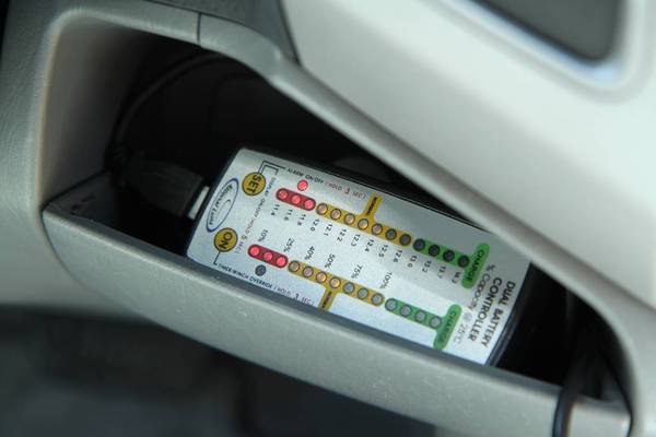

    Dual battery controller sits in the tray to the right of the steering wheel:
    Made a little junction box for the bed. It mounts to the exposed metal there w/ 4 rare earth magnets. Has a Blue Sea USB outlet, cig lighter outlet, the switch for the bed lights, and one of the LED units mounted there to illuminate the tailgate.

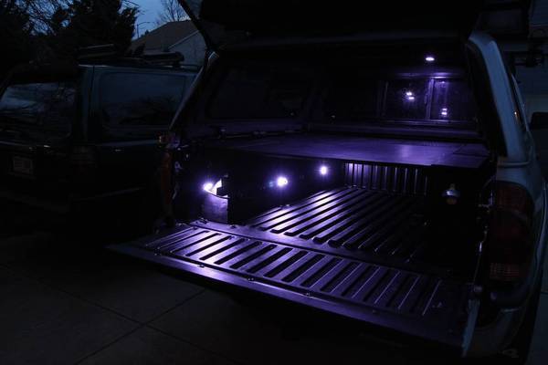

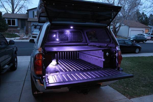

    Bed lights:

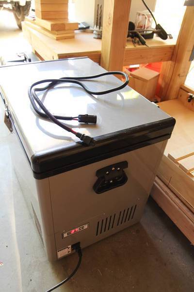

    Edgestar 43q fridge:

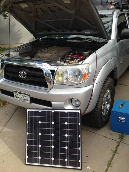

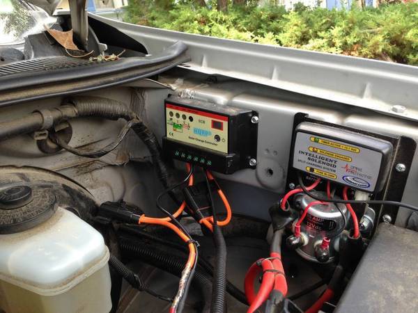

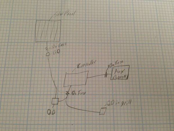

    The fridge was requiring me to run the truck for at least an hour everyday to keep the battery charged up. So, I decided to add solar.
    Testing out the system:
    Here's a crude wiring diagram:
    I mounted the solar controller next to the dual battery solenoid:

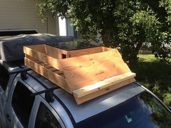

    Then I set about making a roof box to hold the solar controller and store things like camp furniture:
    And here's the completed project:
    The 2x4 across the front will eventually hold a 40" LED light bar.

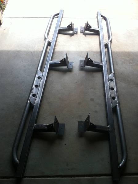

    Woot! Got a set of Metal Tech Sliders on the cheap! Let the real wheeling commence!

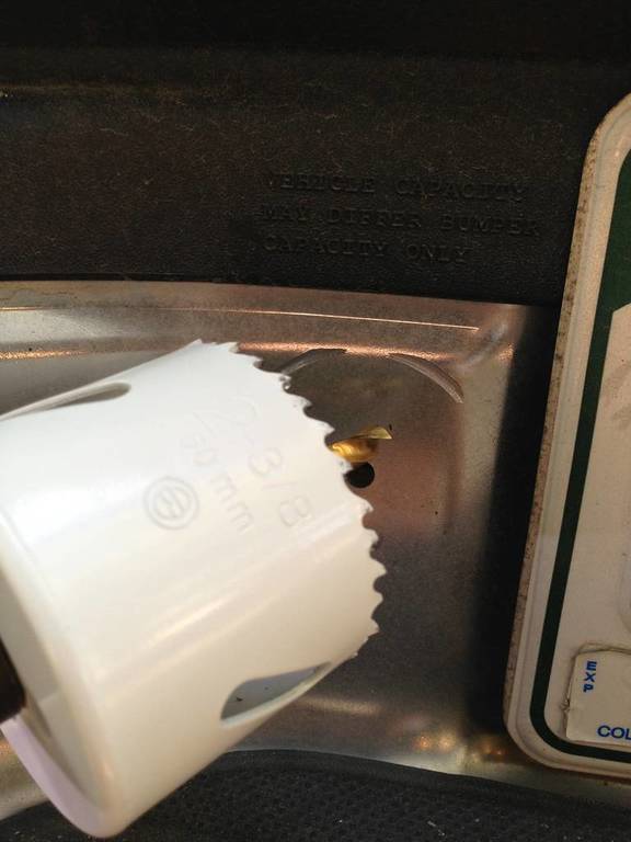

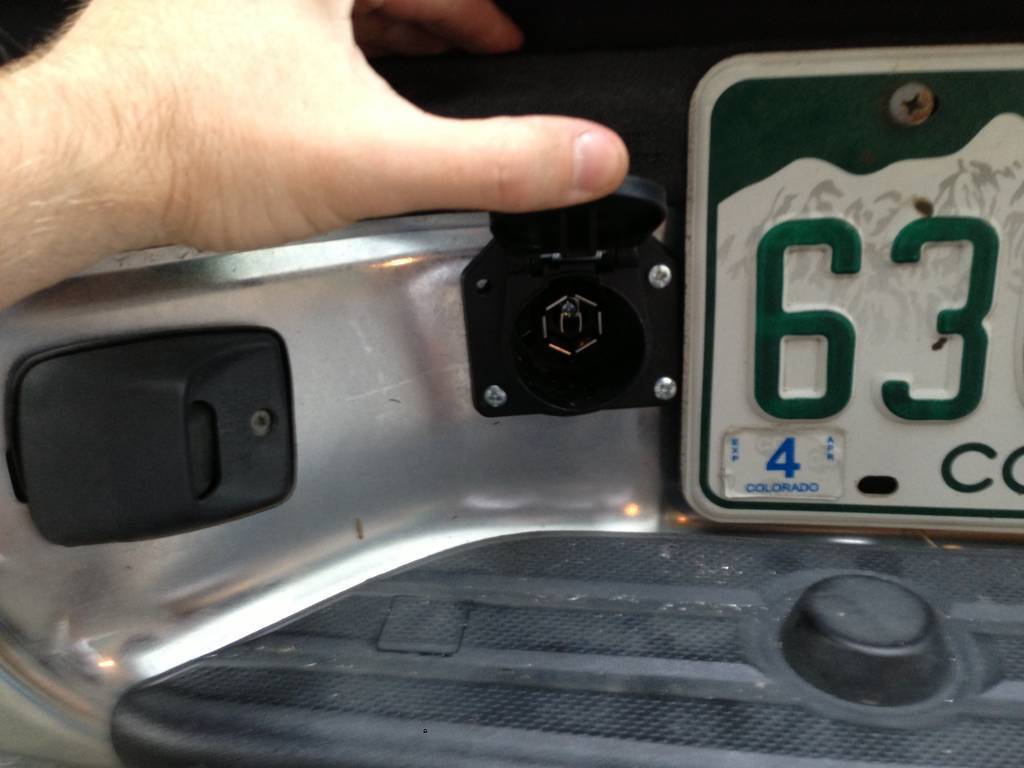

    Made a hole:
    And relocated the trailer wiring plug that was placed in a really stupid location:

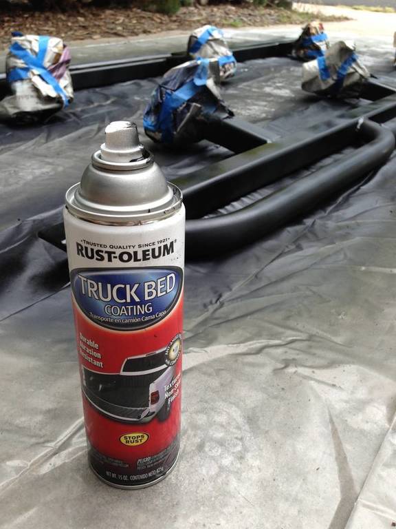

    And finally painted the sliders. Will hopefully get them mounted in the next couple weeks.

    So yeah… Those sliders were for a Long Bed, Double Cab… Back to the drawing board. $300 if anyone wants them.

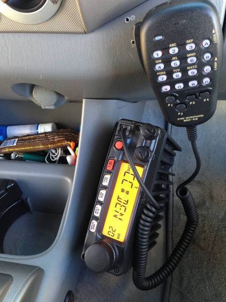

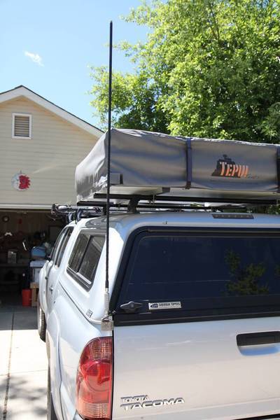

    Took out the Uniden Bearcat. Replaced it with this:
    I cut off the cig lighter plug and put on an Anderson Powerpole connector. It connects to the fuse box under my driver seat that runs to the auxiliary battery.
    And then got this awesome little gem installed:
    Super stoked and have been on a HAM binge all morning. Checked into a net on a repeater 30 miles away, talked to a guy up on SugarLoaf Mountain on Simplex (15 miles away), and just now talked to some friends who are hitting the Vail repeater (on the Colorado Connection) as they drive down I-70 (about 120 miles away). All this without using more than 10 Watts!
