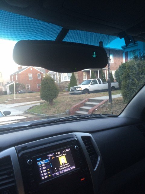

  20. Jan 5, 2015 at 3:59 AM
    #40
    mjackson92rs
    mjackson92rs Well-Known Member
    Aug 3, 2014
    #135360
    136
    SE PA
    '15 TRD Sport
    My '15 TRD sport came with a boring mirror. Upgraded it to this:
