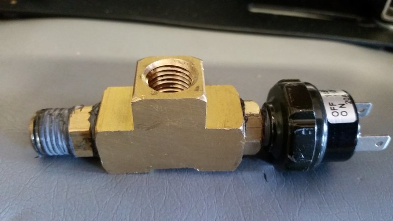

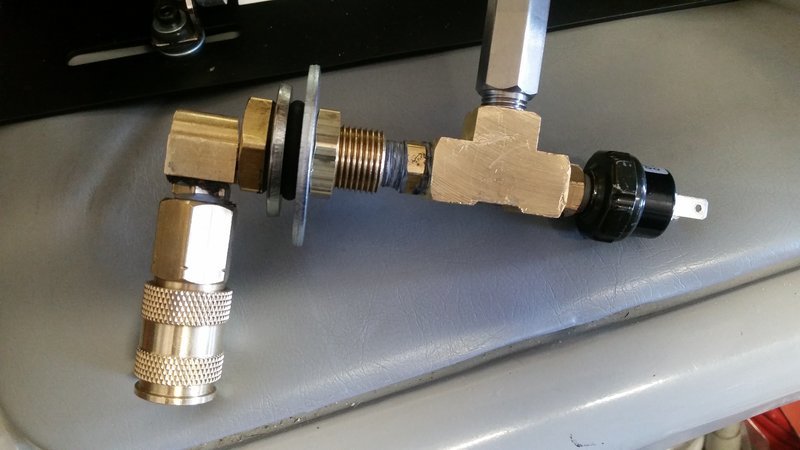

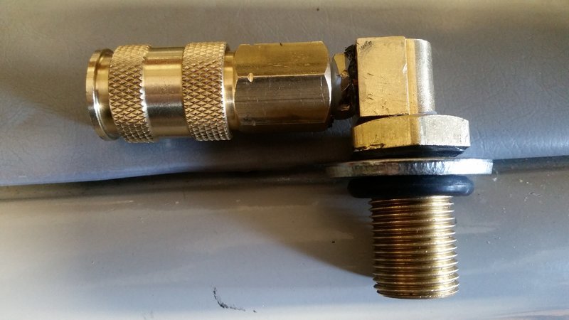

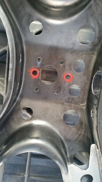

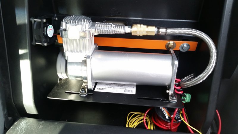

    A bit of progress with the OBA.
    The tank will be mounted in the spare tire location with the winch removed. New holes have been drilled.

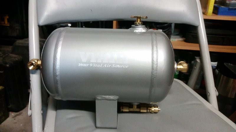

    Fittings attached to the tank.
    I put a small bend in the Viair mount to help with potential clearance issues, and installed larger rubber feet on the backside of the mount.
    I hope to have the compressor and tank mounted up within the next few days, then run electrical.

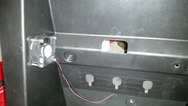

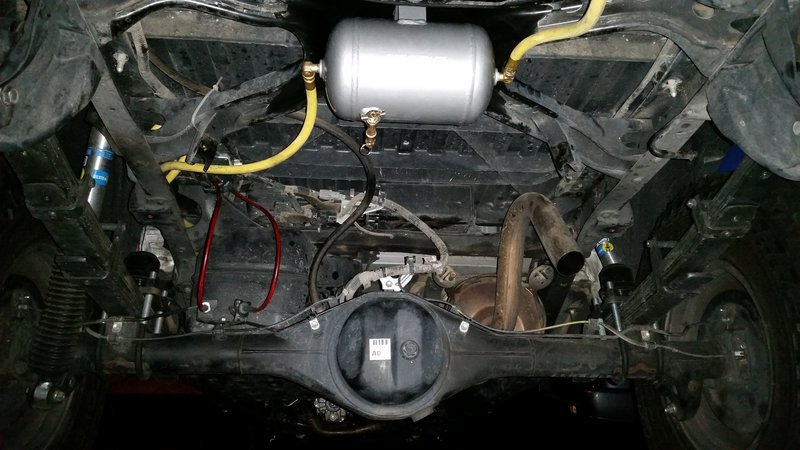

    It took the entire day to get the plumbing and trimming done. Note the cooling fan.
    Axion, omaguz and Crom like this.

    #57
    Crom
    Crom Super-Deluxe Member
    Jun 22, 2009
    #18782
    9,637
    Nick
    San Diego, CA
    2009 4x4 DCSB Camp Supreme
    Millions
    Looks sharp! Cooling fan is a really nice touch! :)

  18. Apr 24, 2016 at 8:00 PM
    #58
    samiam
    samiam [OP] Always here, never there
    Apr 7, 2011
    #54533
    3,151
    Sam
    Stinky Vegas
    2008 TRD OR DCSB 4.0 6MT 1E7 Alu Cab
    Workin' on Workin' on it
    Thanks. This was the most difficult part of it all. I test fitted the plastic bin countless times. My desire to retain the bin nearly ended the entire project...so difficult when trying to fit the line through the back of the cab.

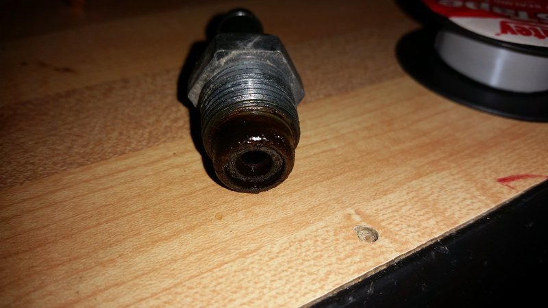

    I changed the PCV last night. It still had rattle, but much less than the new one. Truck starts easier and runs smoother.

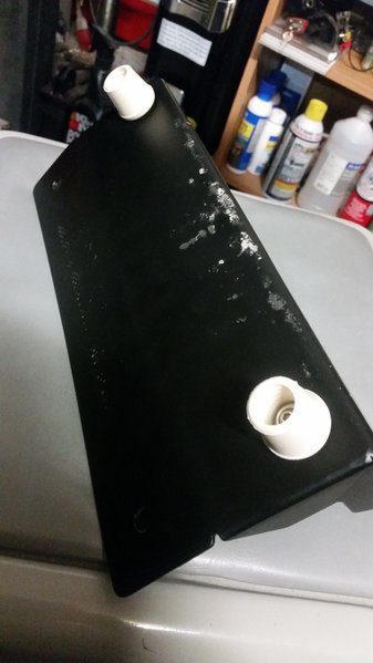

    Old
    Crom likes this.

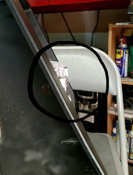

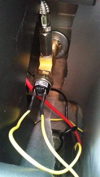

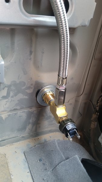

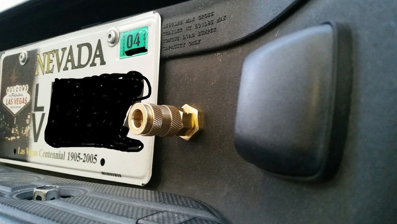

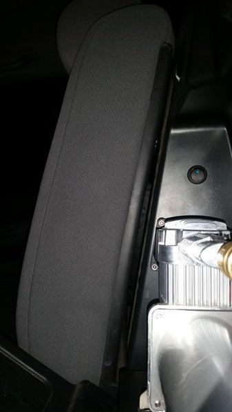

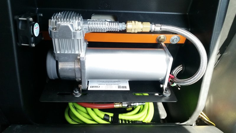

    My OBA project is virtually complete. Special thanks go out to @Crom and the OBA thread for ideas, problem solving and inspiration.
    I became obsessed with the idea of retaining the plastic cubby behind the rear seat (mounting the 450C would've been far easier without it).
    I had to bend the Viair mounting plate for proper clearance.
    I also became obsessed with using a tank. I decided on a Viair 1 gallon. The spare tire location was the perfect spot. It was very difficult to get the tank bolted there.
    I need to make a rock shield for it.
    Now putting the pieces together.

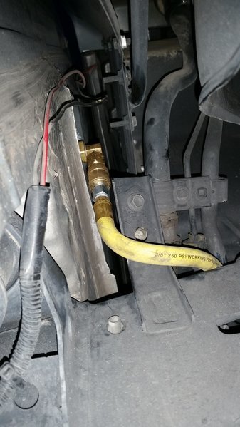

    I thought cooling might be an issue so I added an exhaust fan.
    Getting it wired up and tested.
    The result.
    ^This is a fantastic result of the mounting location; space below for the hose and associated accessories.
    Initial performance test: 20 - 40psi 2:08 (255/85/16 tire).
