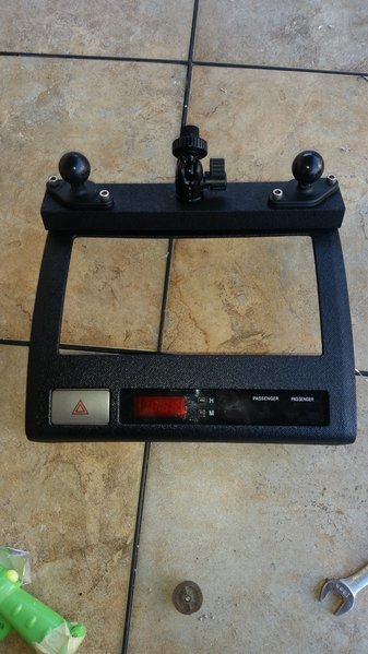

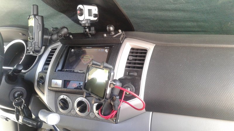

    A sneak peek at my phone, gps, action cam mounting system.
    Crom and TacoSTIG like this.

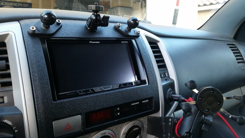

    All finished up, but I'm sure if I like it. Maybe I'll get used to it.
    ready6delta and Crom like this.

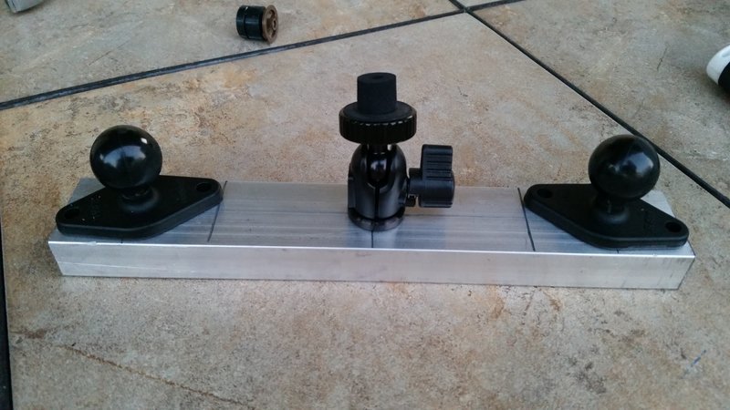

    A couple more pics.

    I hated this setup. It was ugly as hell, terribly difficult to bolt up, and the bolts in the back made contact with the framework causing a rattle.
    Now I'll try this setup (makes more sense), but I have other ideas wandering around in my brain.

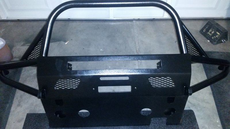

    ...and I pick up my bumper from PC tomorrow.:woot:

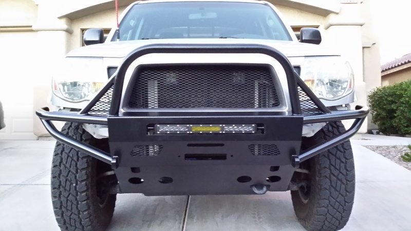

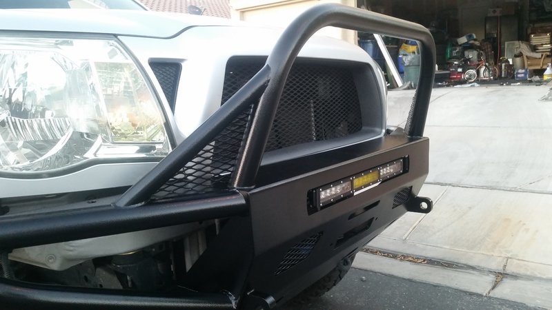

    I've had my bumper sitting in my garage for more than a year, and I finally installed it today.
    3:00pm - picked up the bumper from PC
    4:00pm - started teardown of OEM bumper
    7:00pm - all done
    Pelfreybilt hybrid - 107.5 lbs
    OEM bumper - 28 lbs
    Net change in weight - 79.5 lbs
    Suspension only dropped 1/4" - 3/8"
    I need to do some blackout painting, but I couldn't wait another moment to install.
    ready6delta, skidooman and Crom like this.
