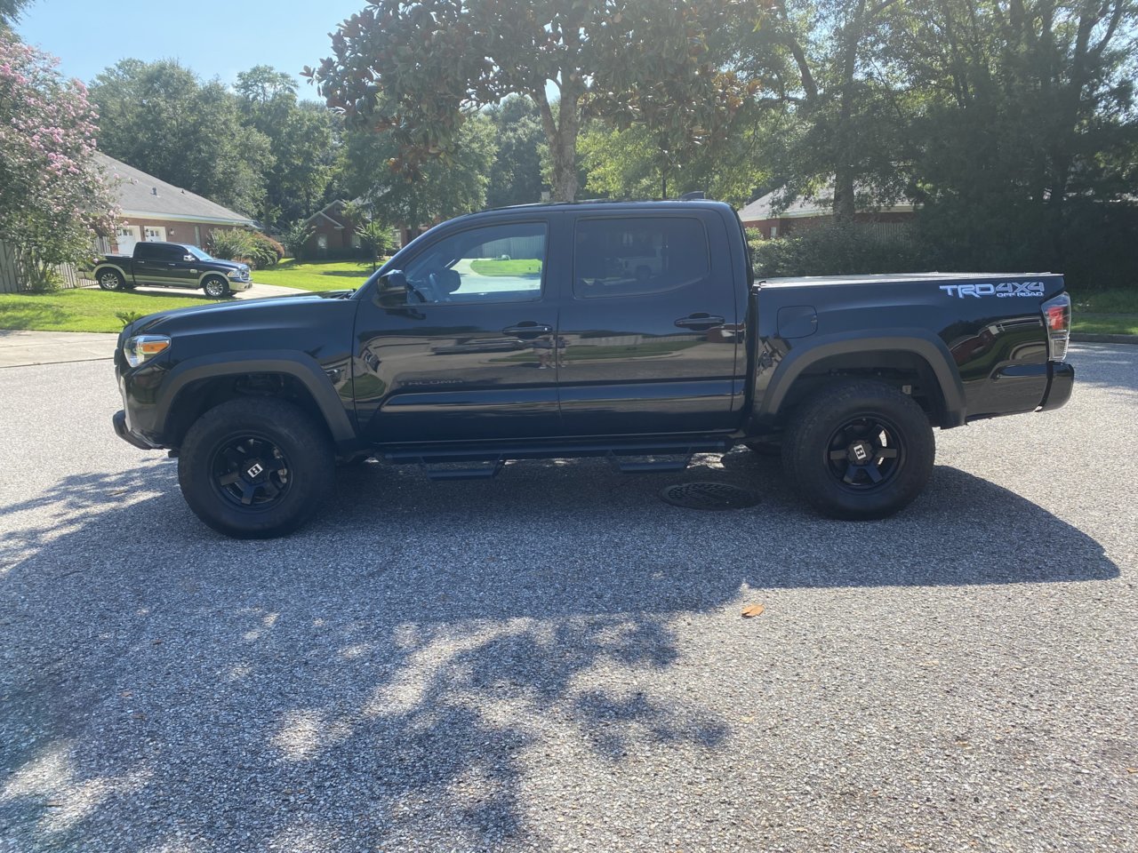

    Now fast forward to present day, here are some pics of the Taco throughout my ownership:
    After purchasing. Clean, bone stock

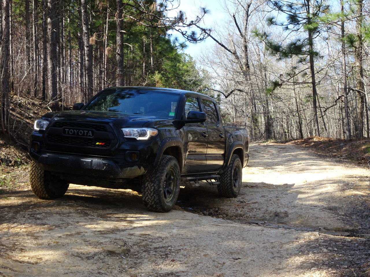

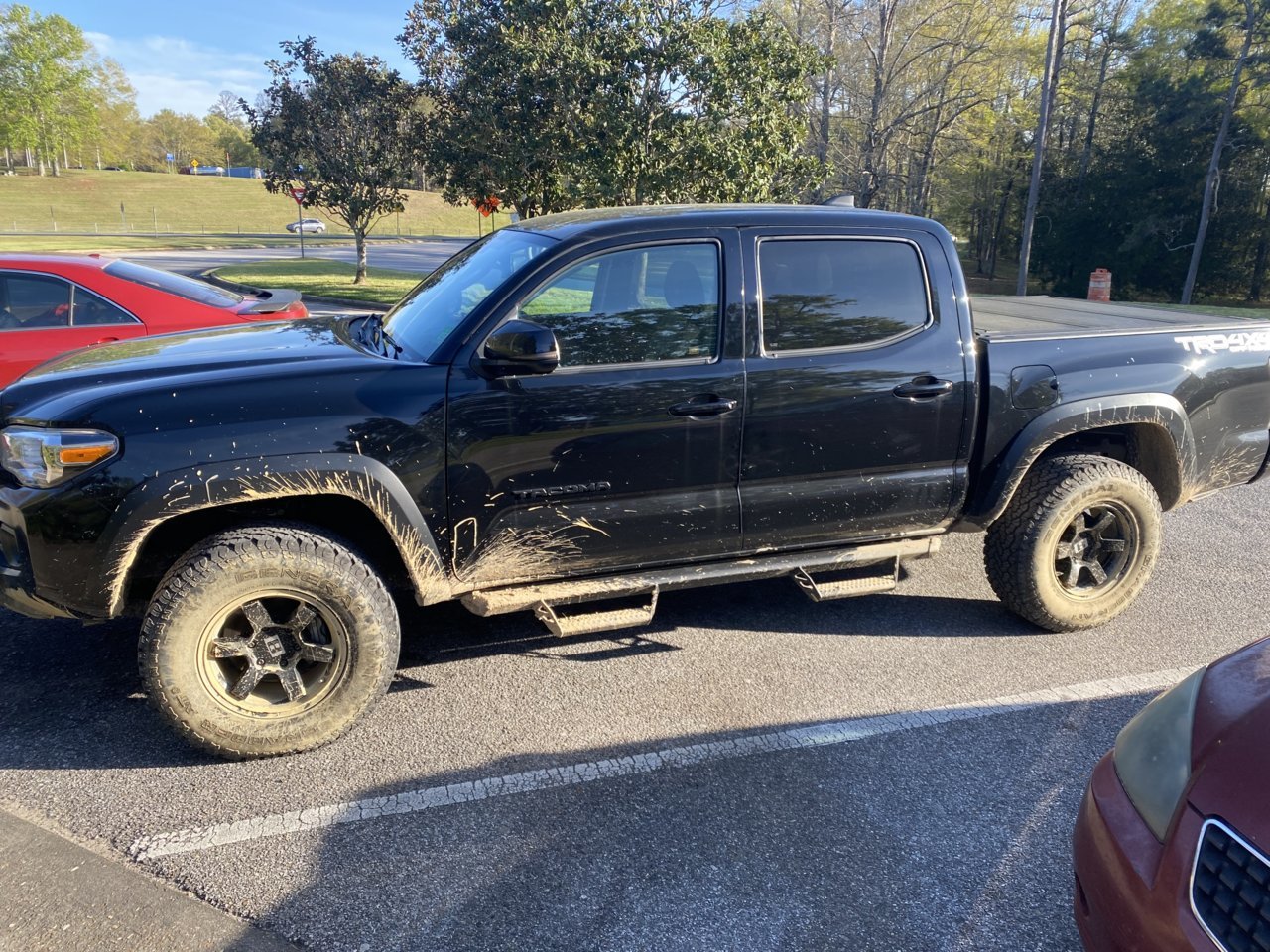

    First time going offroad: Talladega National Forest / Cheaha State Park (North AL, March '23)
    Still completely stock suspension at this point Only issue on the trails was front bumper ground clearance

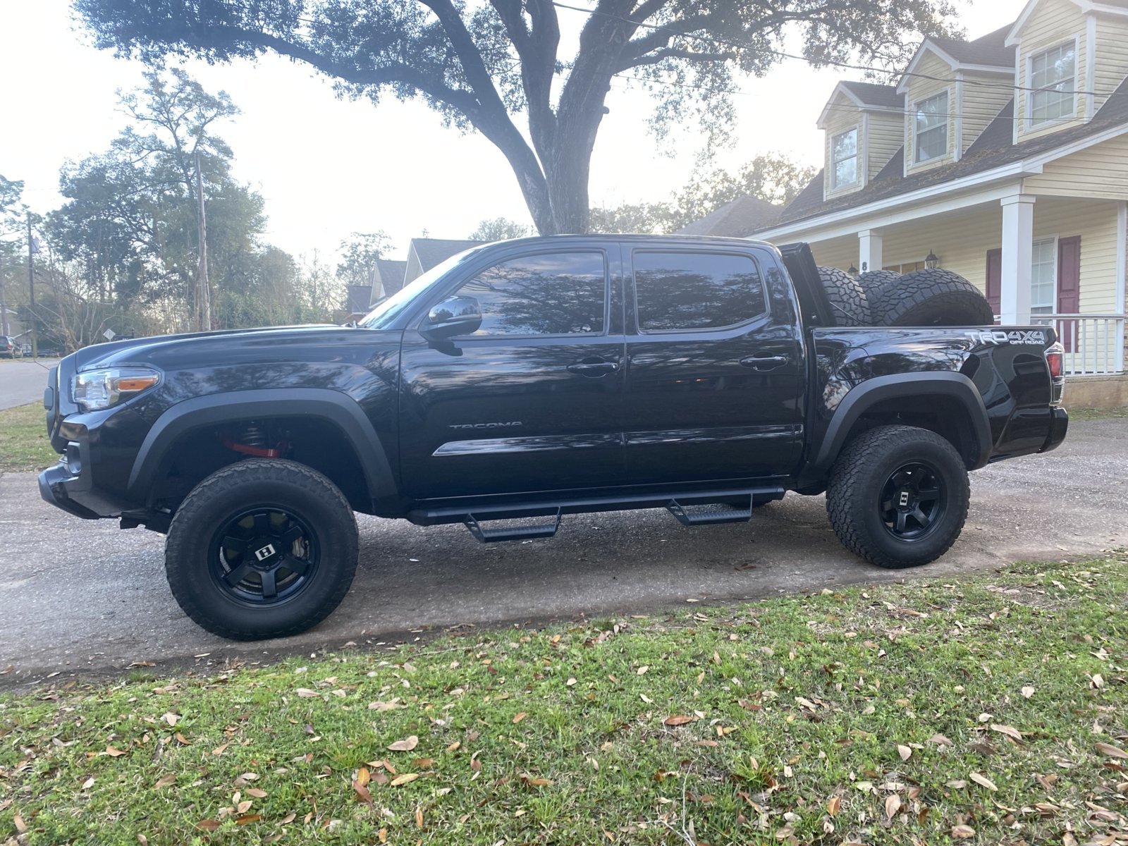

    After installing Eibach Stage 2 Lift Kit (August '23)

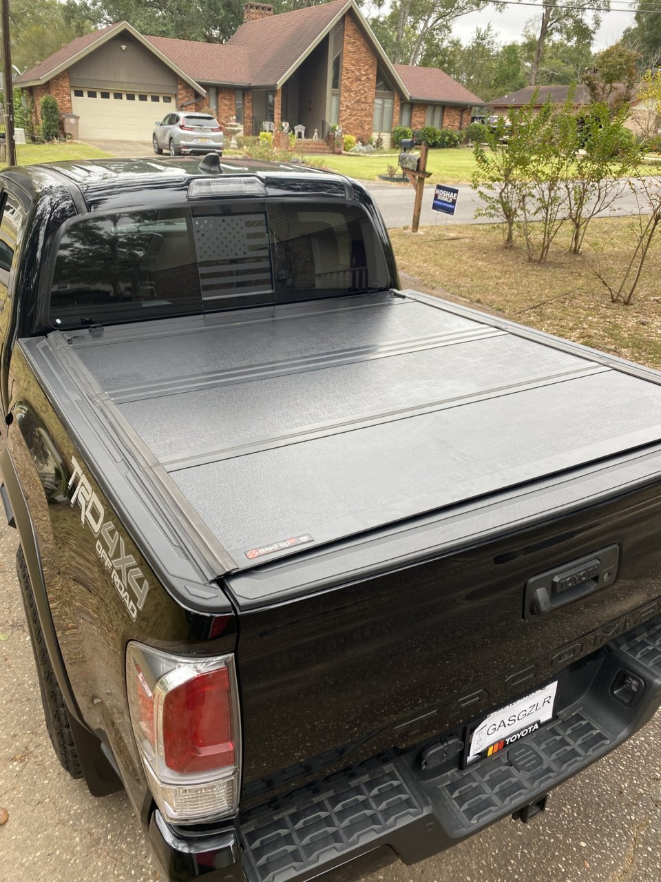

    The first mod I got for the Taco was a Bakflip G2 cover on the bed. A brand new Bakflip at roughly $900 was not an option (this build thread contains the word "budget") for a reason.
    I found a gently used G2 cover on Facebook Marketplace about 2hrs from my house. 4hrs of driving and $300 later it was mine. The cover was in almost new condition, as the previous owner had it on his Tacoma for less than 2 years. He had the cover listed for over 6 months without finding a buyer, hence why I was able to get such a good deal.
    It was missing 1 support strut and 1 buckle strap, both of which I was able to buy new from Bakflip directly for less than $20 total.
    Pros:
    - keeps the bed almost watertight (I'd say 98%). If the truck is stationary/parked during a heavy rain, or I go through a car wash some water will get in through the corners
    - super convenient and easy to flip up the panels / secure them in the open position
    Cons:
    - that black aluminum gets HOT in the sun
    - with the cover installed, my Yeti Roadie 24 won't fit in the bed under the cover. It's about a half inch too tall. Kind of a bummer, but not a deal breaker.
    Installed:

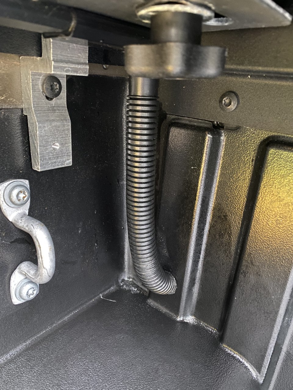

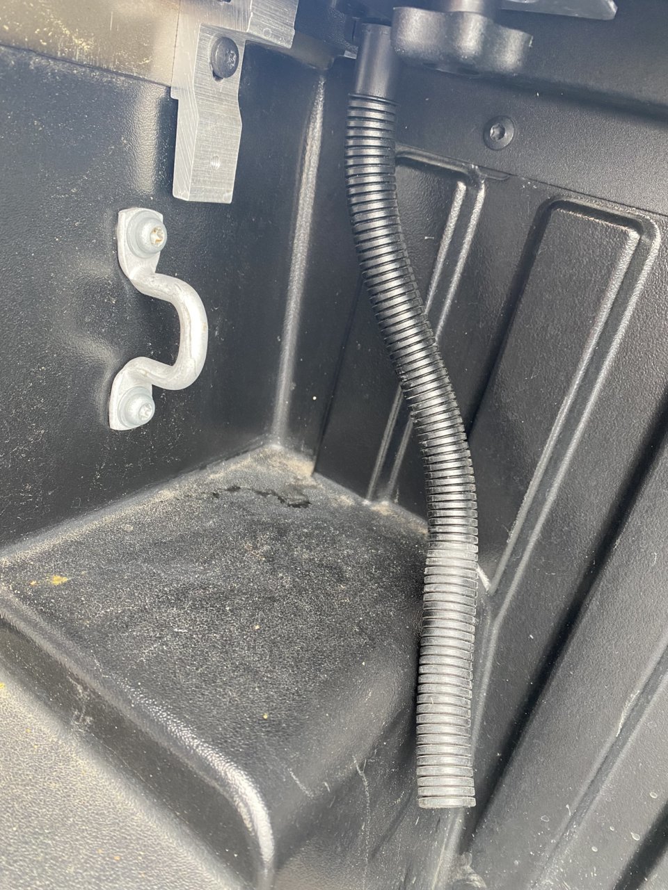

    The previous owner had already cut the drain tubes to drain into his fender well, so routing them out the bottom of the bed was not an option. Cutting into the bed of my new truck made me anxious, but I took my time and have been well pleased with the result.

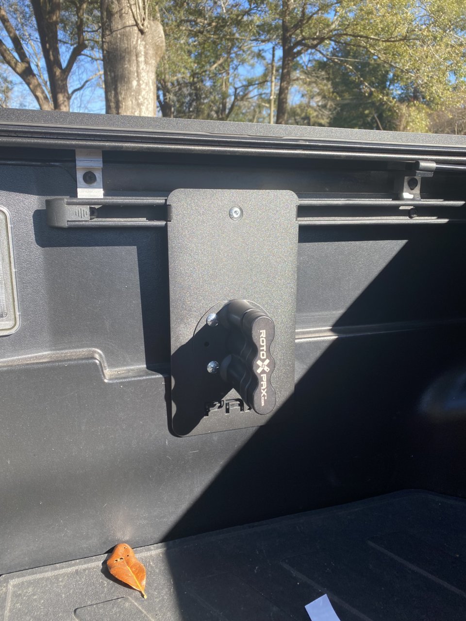

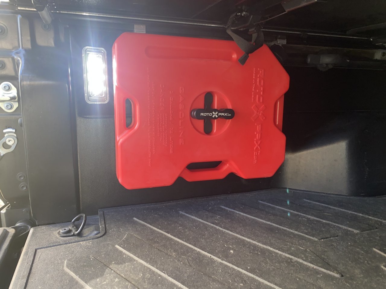

    The fuel gauge on the Jeep I owned before this Taco was broken, and as a consequence of that I ran out of gas 3 separate times. 2 of the 3 times I was stranded in the middle of a 4-lane road, blocking traffic. The third time I was next in line at the gas station :rofl:
    I decided I wasn't going to let that happen in the Taco. I installed a 2 gallon rotopax on the rear driver side bed rail with a Rotopax "Truck Plate" and DLX mount.
    With the exception of a header rail at the front of the bed, the rear driver side bed rail is the only location appropriate for this install. If installed on the passenger side it would block the cubby & outlet.
    Mounted horizontally, the rotopax fits nicely under my Bakflip cover and only protrudes about 5" from the bedside. It does obstruct the driver side bed light, but not enough to make a significant difference.
    Toyota/Nissan "Truck Plate" from RotoPax website, with DLX mount
    Rotopax Installed

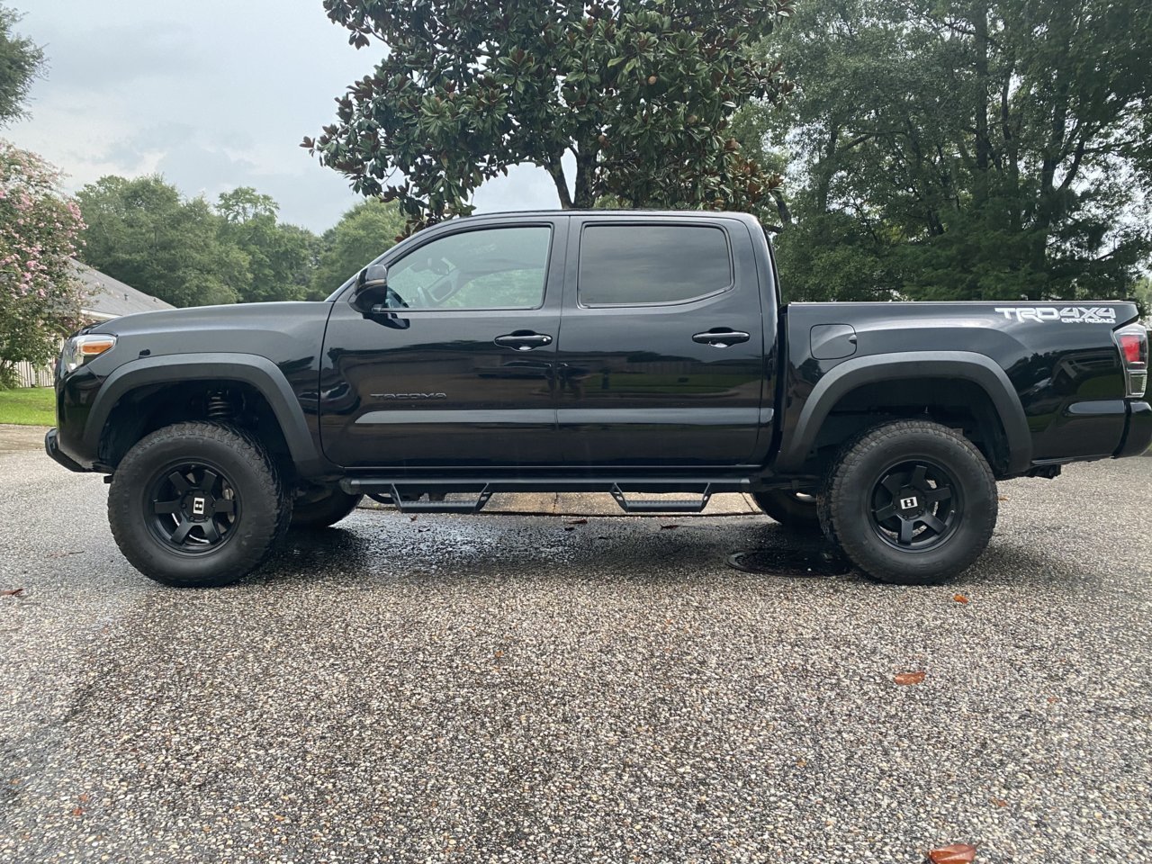

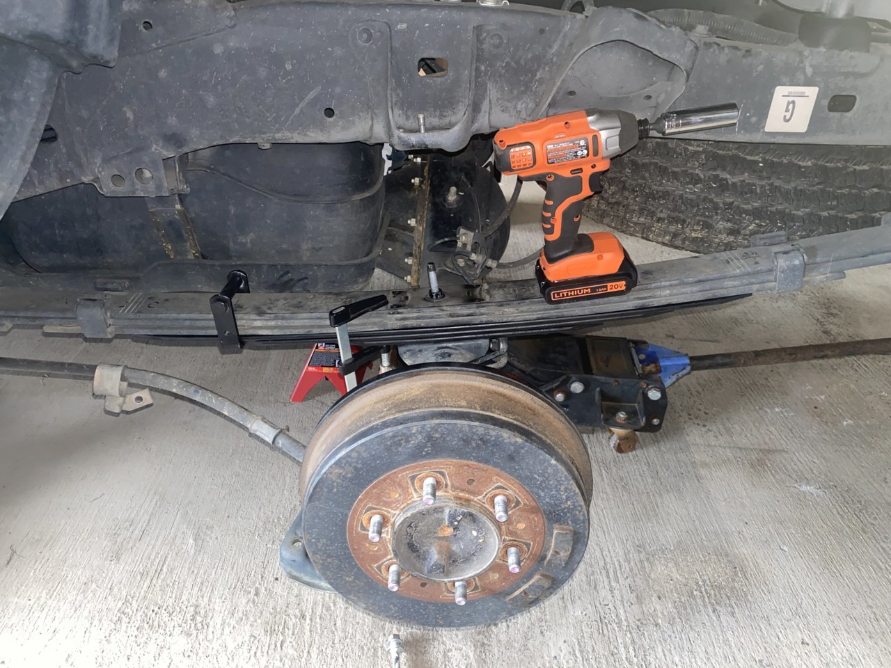

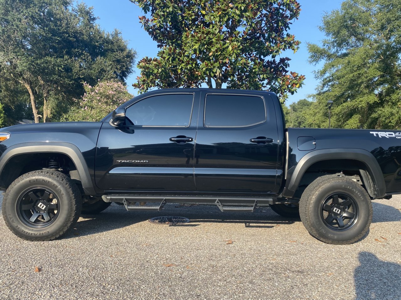

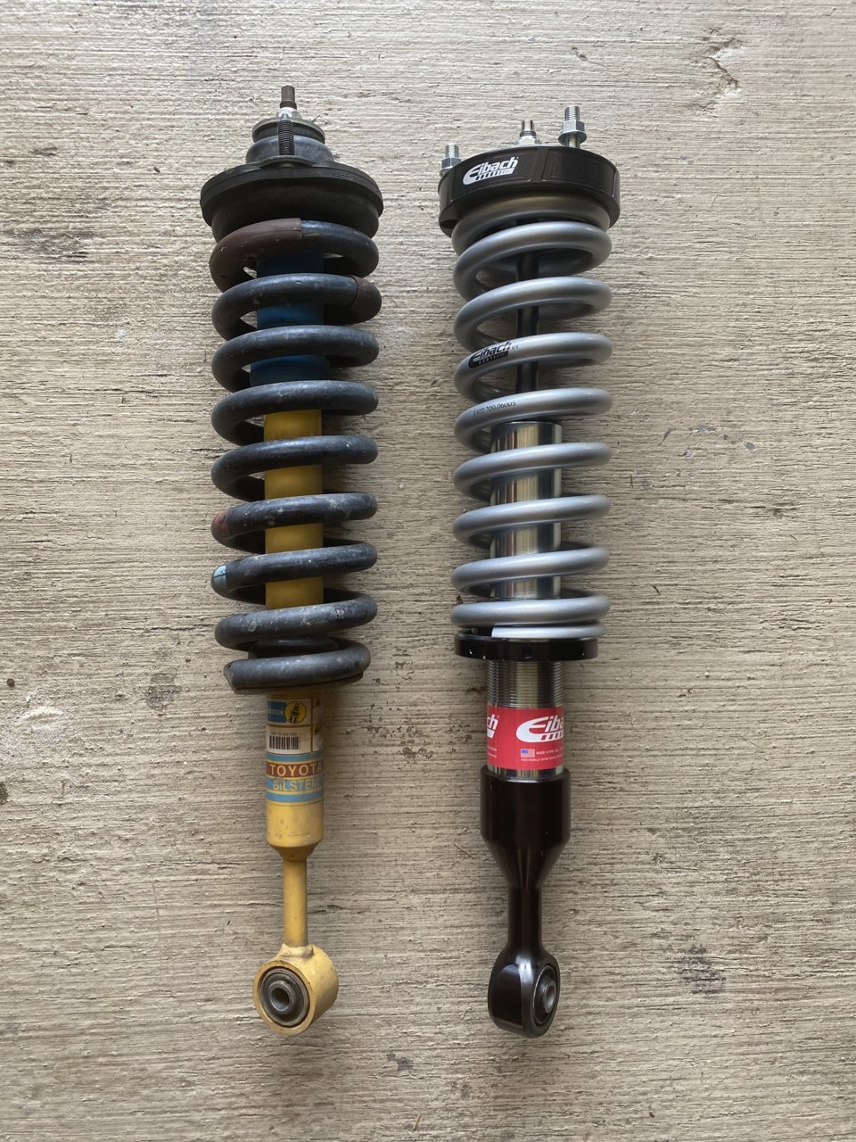

    Write Up of Eibach Stage 2 Lift Kit install (installed 8/5/23)
    I spent months reading threads, researching, and trying to determine which lift kit would best suit my needs.
    My needs were:
    - around $1,000 all-in
    - between 2-2.5" lift in front and 1.5-2" lift in rear
    - smooth ride on the highway
    - suitable for occasional off-road use, light trails, light mud, light crawling, etc. but mostly on-road driving.
    - reputable brand / products
    - easily replaceable or rebuildable (thinking long term)
    - capable of being installed with OEM UCA's (to keep budget in line)
    I was torn between the OME RTR Bilstein 5100 kit from YotaMafia (their Holt, FL shop is about an hour from my house) and the Eibach Stage 2 Kit. As you can see, I went with Eibach.
    I got the kit new in box from a guy on Facebook Marketplace. All in, I got the kit for $1,000 (saving about $400 from buying new)
    The kit was from @HeadStrong Off-Road and included a sway bar relocation bracket, 3 leaf AAL, and longer U-bolts. I only got ~1.5" of lift from the coilovers (stock front end, no extra weight), so I cranked them up until I was at an even 2.5" of lift on both sides (that meant cranking the drivers side about 1/4" more). I was very happy with Headstrong's AAL and the instructions they provided on their website, however if the centering pin was a bit shorter it would definitely make the install easier. I had almost 2" of excess that I had to grind off to fit the factory bump stops back on. The ride quality is almost the same as stock, just a tad firmer. My wife said she couldn't even notice a difference.
    A local shop quoted me $600 to install the kit. I wanted to save that money, but I am by no means a mechanic. Up until this point, all I had self-performed was fluid & filter changes and 1 tire rotation. I've always paid my local stealership to do everything else, which I was tired of doing. Instead of simply spending the $600 and be done with it, I did my homework, spent ~$100 on the necessary tools that I didn't already have, borrowed a floor jack and jack stands from a buddy, commandeered my parents garage for the day, and spent my entire day (~11 hours) installing the kit. The install went well overall. The hardest part for me was getting the tie rod ends and control joint knuckles to bust free, as all I had to work with was a 16oz claw hammer. The rusted cotter pins on those nuts were a bitch and a half too. I also accidentally installed the AAL's backwards at first, so that added an extra hour of work :rofl:. I'm very happy with the way my truck looks now, but I am far happier that I was able to do the work myself, save a net amount of $500, and learn a LOT in the process. Here's to trying new things and learning new skills :cheers:
    Pics below are before and after. My 265/70/16 tires look small now lol

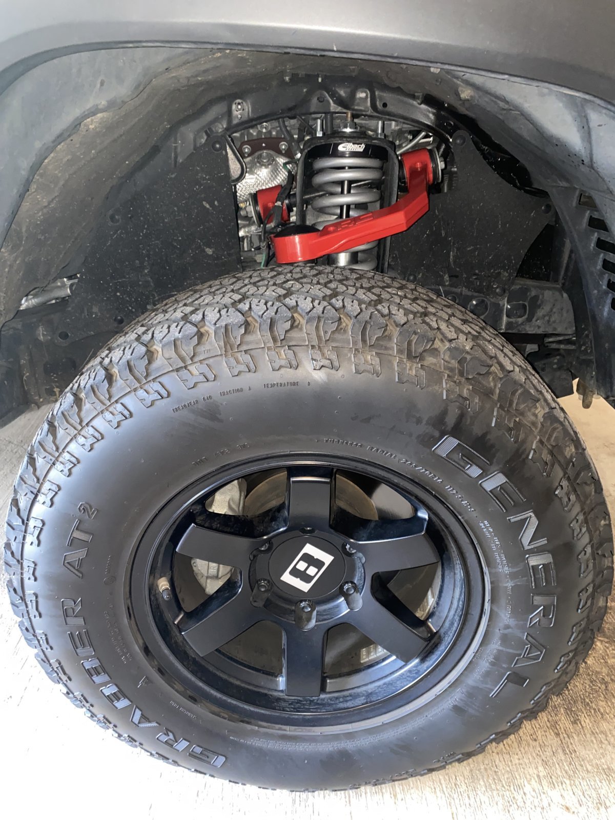

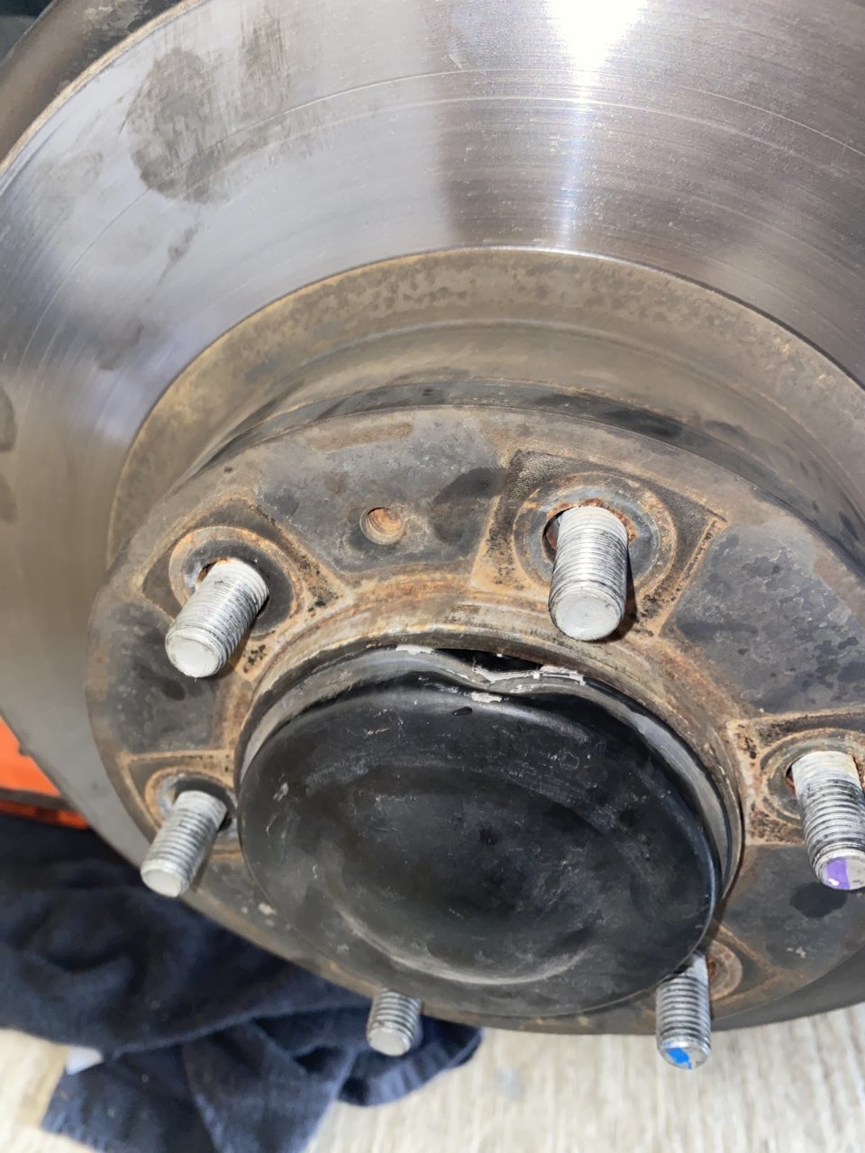

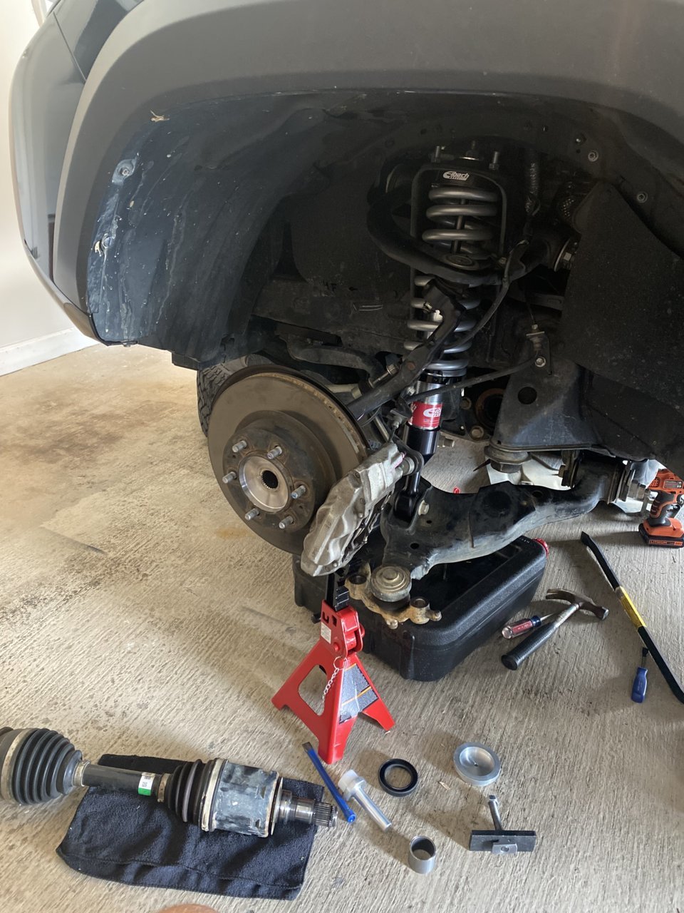

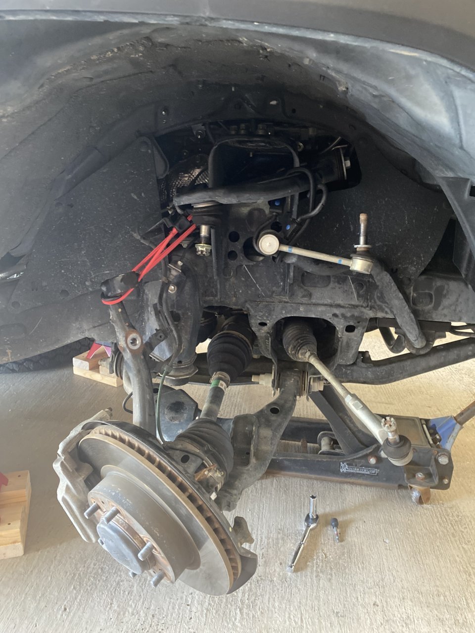

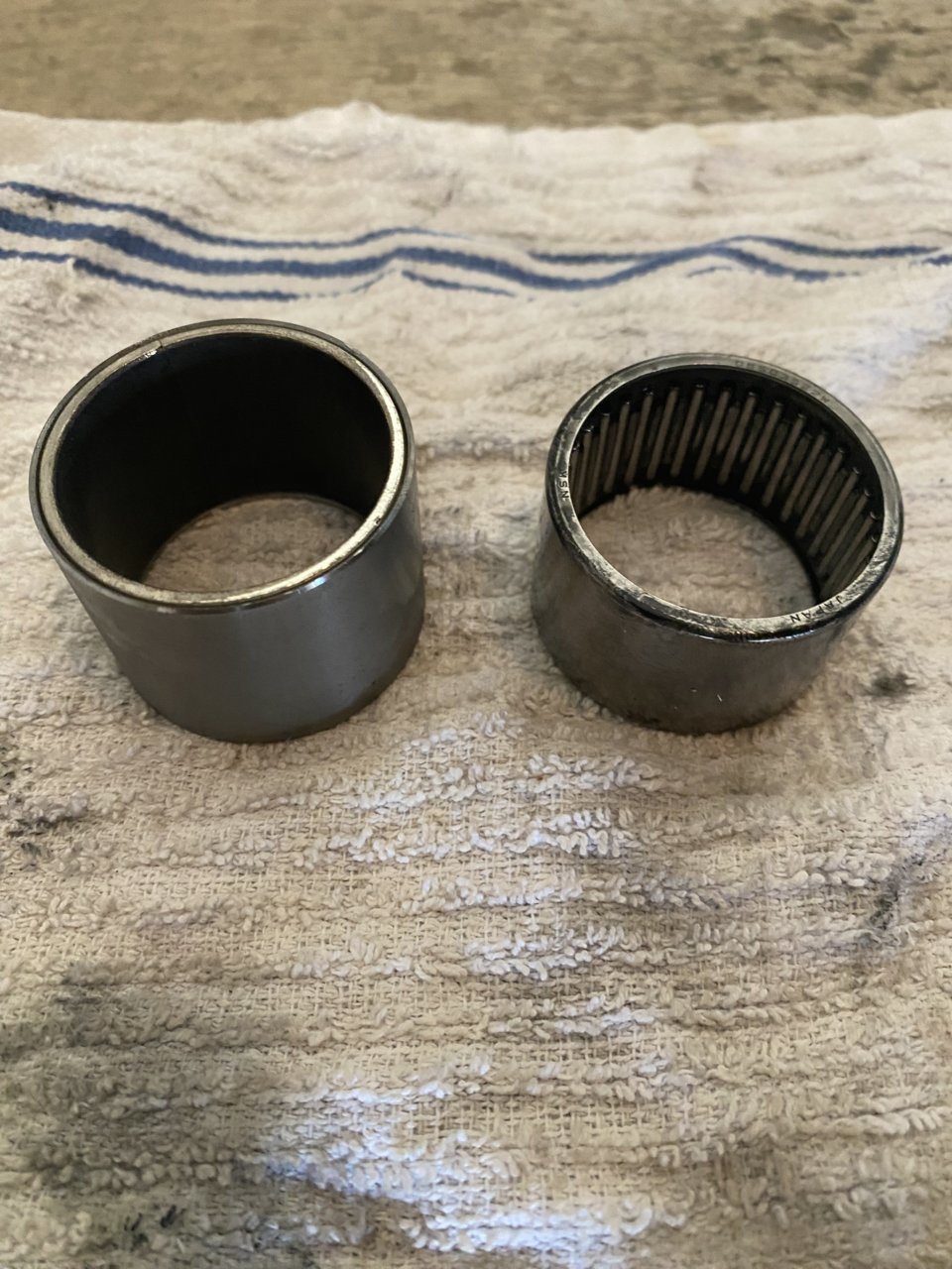

    Write Up of ECGS Bushing Swap (performed 8/19/23)

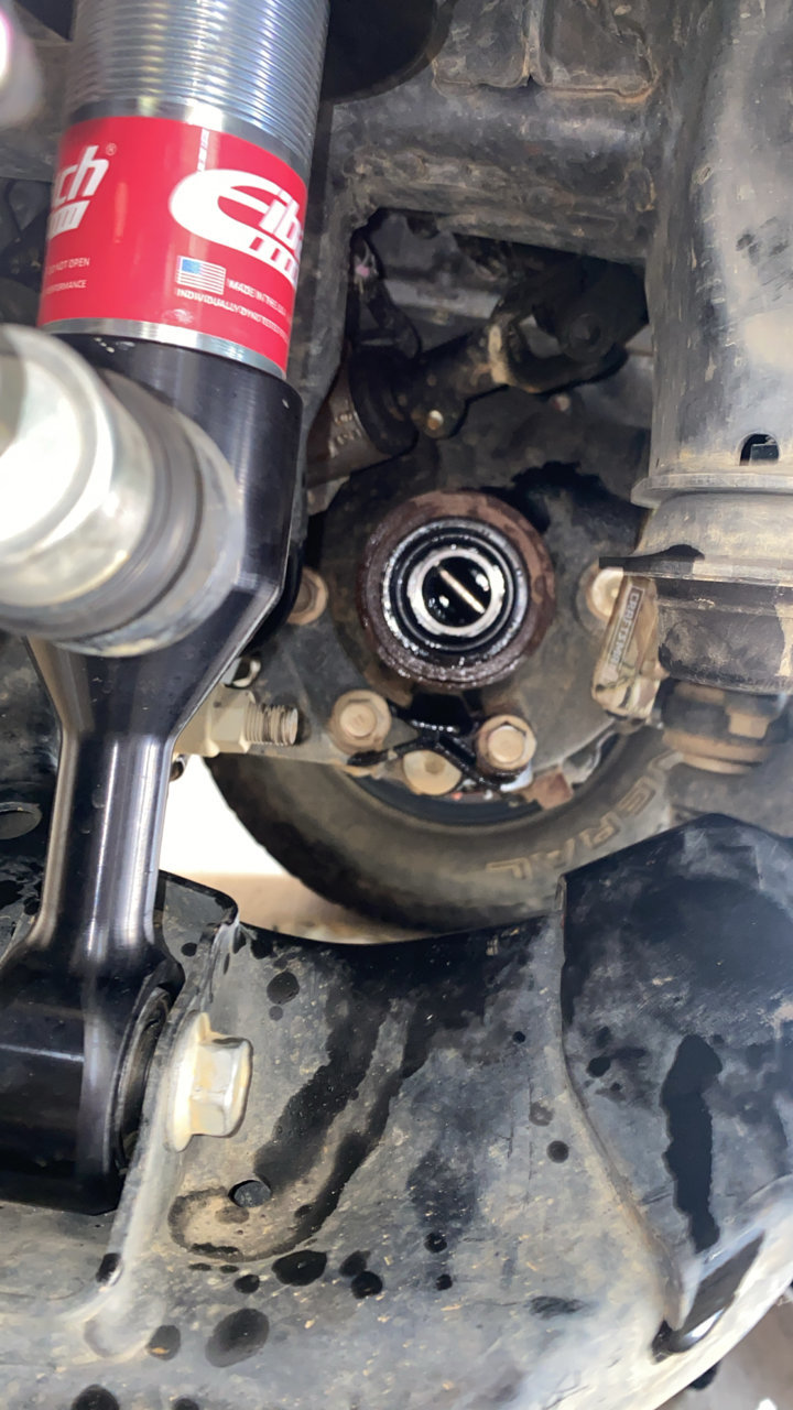

    Did not receive any needle-bearing related feedback or vibrations in the driver side front area after installing my Eibach Stage 2 lift kit. Went ahead and performed the ECGS bushing swap, since I had already ordered it prior to buying the lift. Since I plan to own this truck well past 250k miles, I figured why not do it now and prevent any future headache. Preventative maintenance, you could call it.
    I was still riding my high horse after installing the lift kit 2 weekends prior, but did not come prepared to install this bushing. Woke up late, hungover, and stumbled to my tools to begin working. Consequences of my lingering intoxication was a dented axle nut cover. Already ordered a new one from Longo Toyota (best price I could find)
    Nobody told me how much of a booger the CV axle was going to be to get in and out. Wow that sucked. Even using a ratchet strap to suspend the CV from the UCA, I spent about an hour with a 8" chisel and hammer before borrowing the neighbors car to go to Ace and buy a 24" pry bar. Overall successful install with a couple minor hiccups, but those hiccups are worth the peace of mind that my needle bearing won't ever spontaneously grenade inside the diff.
    Observations:
    - Needle bearing was fully intact (thankfully)
    - Diff oil smelled like farts and fermented pee. That smell LINGERS too.
    - That is not diff oil in the 2nd photo - that is sweat. It was 100 degrees with 90% humidity in the furnace that is lower Alabama.
    - I lost less than half a quart of diff oil overall. Haven't topped it off yet. Was going to wait until 60k diff service (I'm at almost 50k) but probably should go ahead and top it off.
    71416544373--299426EA-4D59-4D64-B789-D63F1DD77AD0.jpg 3A67BB5D-8684-4F47-A144-6435CBEA286C.jpg IMG-1727.jpg

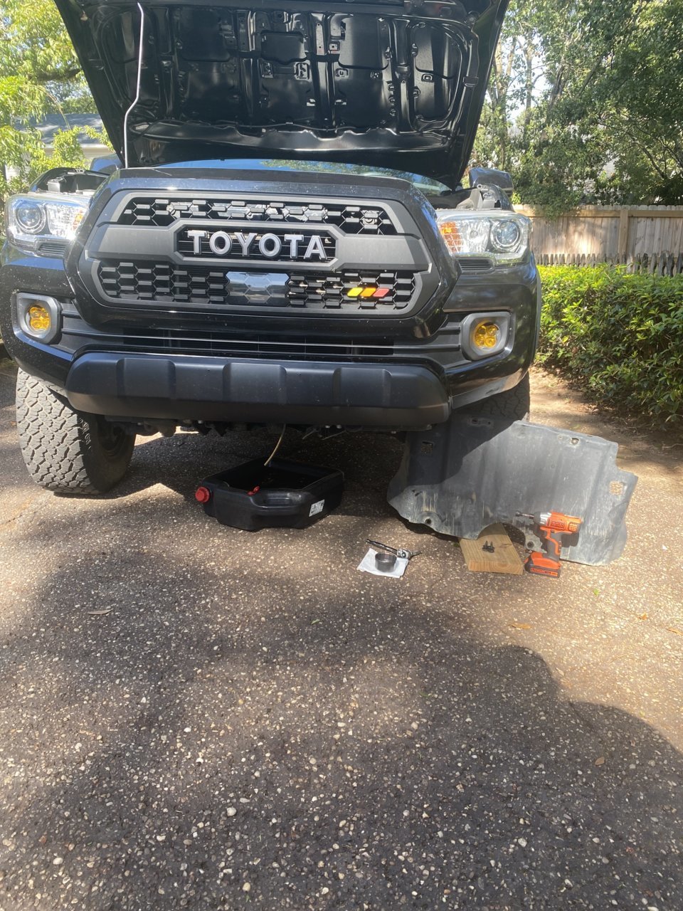

    Changed engine oil and oil filter yesterday (9/4/23).
    49,147 on the ODO
    5,037.1 on Trip B (which I use to measure oil change intervals)
    3rd time changing the oil since I purchased it, and I still can't seem to remember what size the skid plate bolts are until I get under the truck and realize I have the wrong size :rofl:
    Oil was in decent shape for 5k miles. Typical dark brown color, no visible particulates. Only spilled about 3 drops. The MotivX kit helps a ton, particularly the oil filter socket.
    Noticed a few drops of dried/stained oil on the back of my skid plate from the drivers side CV area. It was not fresh and nothing was actively leaking. Certain it was from the ECGS swap a couple weeks ago, not worried.

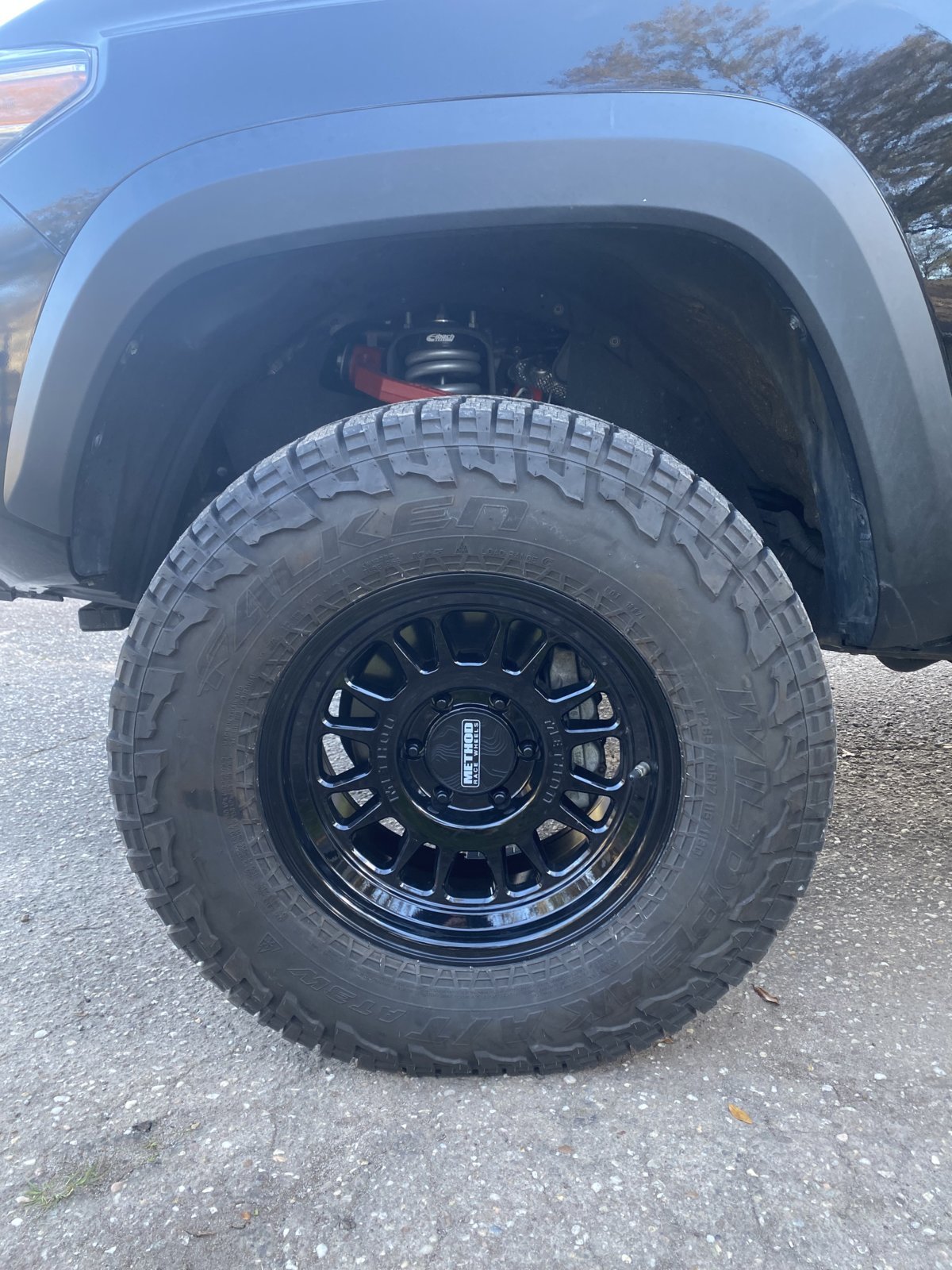

    Brief Write Up of aftermarket UCA install (10/7/23)
    Installed Rough Country Forged UCAs that I got from one of the admins of the Alabama Tacomas group on FB. I know Rough Country gets some hate, but these utilize OEM style bushings and joints, and are available at a great price point. They are only $300 new, and I got them for $200 secondhand, although the guy who bought them never even took them out of the box.
    The overall quality of the UCAs impressed me. They are pretty hefty (they are aluminum and still outweigh the factory UCAs)
    Install went smoothly. Drivers side UCA bolt was a pain to get out due to the wiring harness / box adjacent to the battery tray. Passengers side was a breeze and only took about 30 mins start to finish. Got an alignment the next day because the toe was out pretty bad. Alignment is back in spec and I've got just about the maximum caster that spec will allow (which I'm happy with).
    Now time for some 33's!

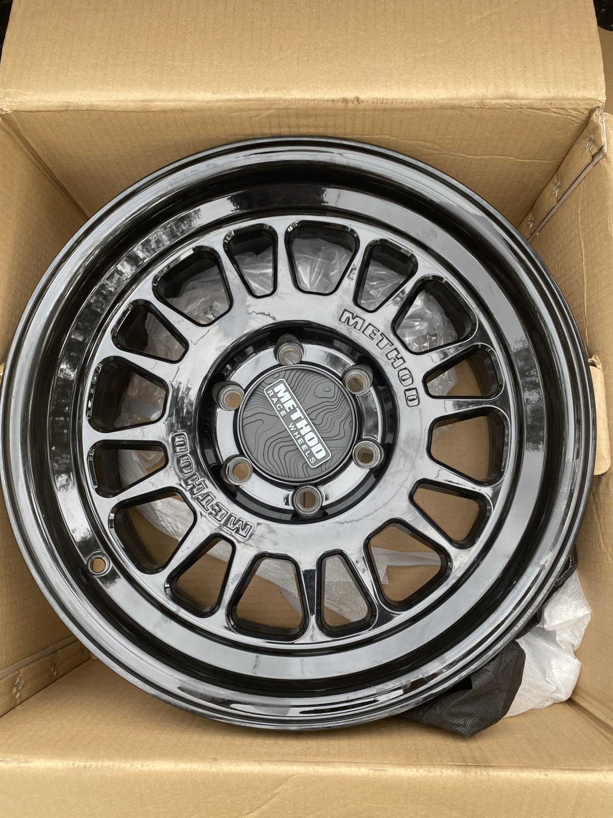

    Picked up a set of Method 318s for less than $200/wheel locally. Guy had ran them for less than 5k miles and decided he didn't like them. Score!

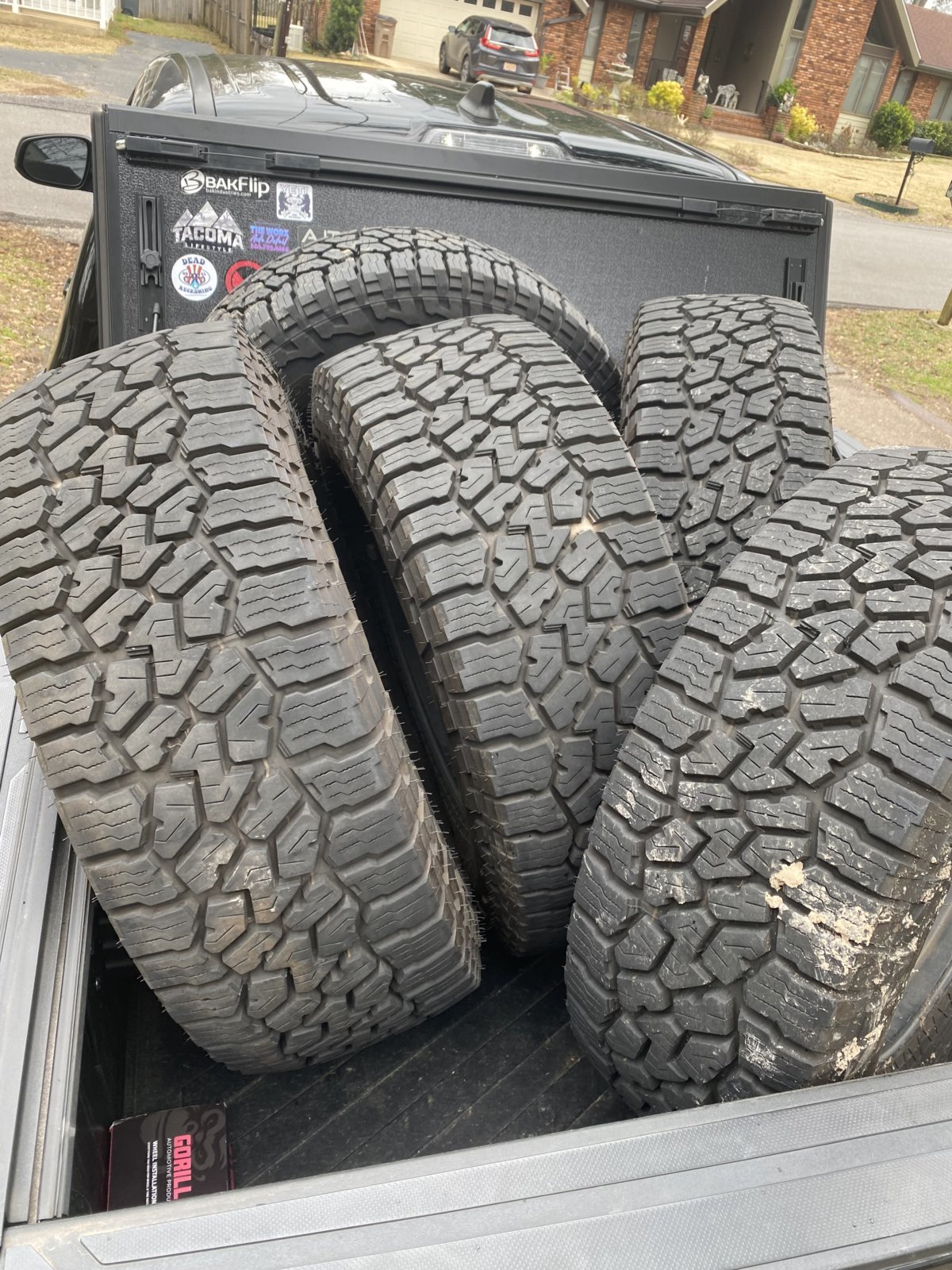

    Next up I wanted some bigger tires, but didn't want to pay full price for a brand new set. Found a set of (5) 285/70/17 Falken Wildpeak AT3W's locally for $800. They have less than 8k miles on them and even came on 2022 Jeep Gladiator wheels with TPMS, which I am going to turn around and resell. Score #2!
    Now to wait on the lugs I ordered from Method to get here and I can get them on! Will have to sweet talk the tire shop to break the beads on my current setup so they can retrieve my TPMS and swap them over.

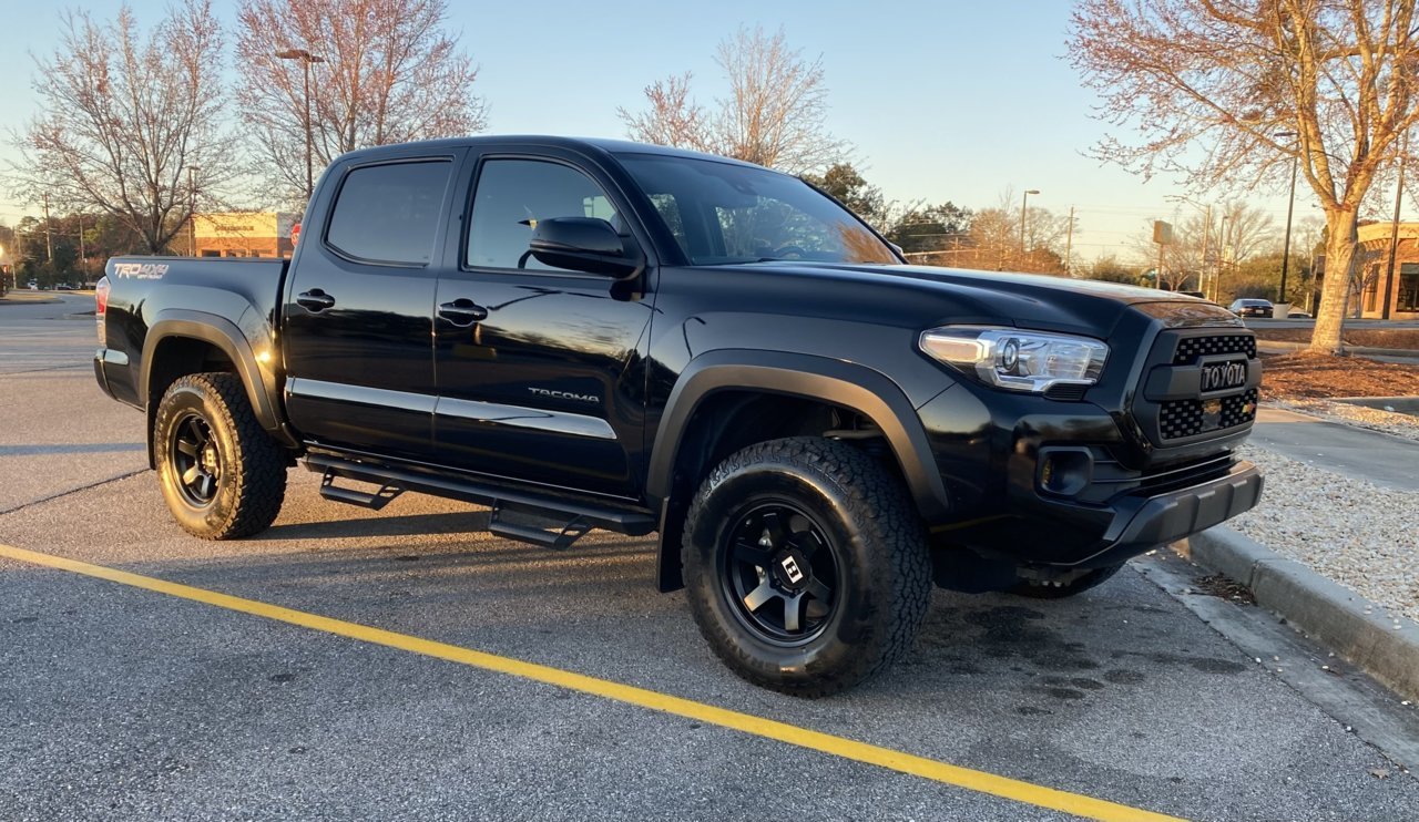

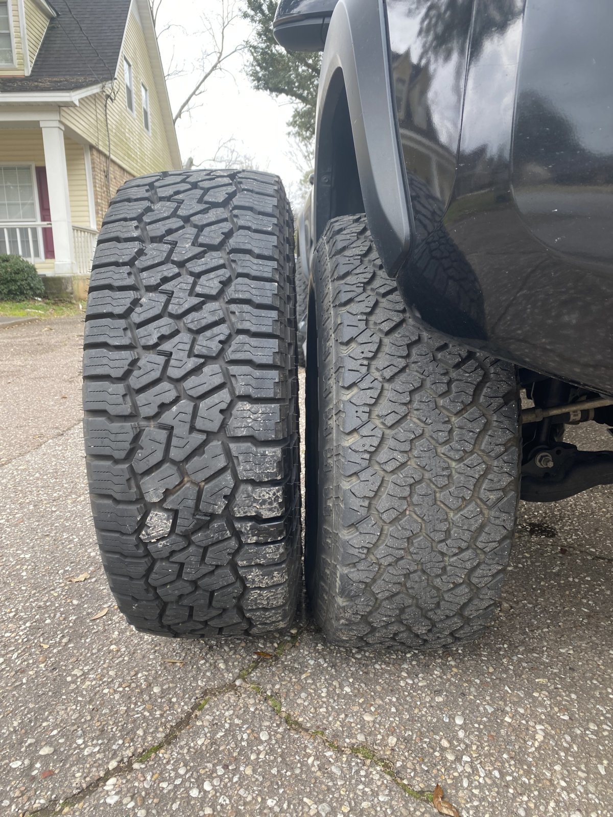

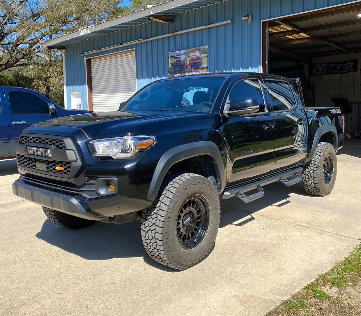

    Finally got 285s and Method 318s thrown on yesterday. Shop swapped over my TPMS sensors too. Love the look and ride! They are actually quieter on the road than my 265 grabbers.
    Front does rub on both sides before getting to full lock. Haven't taken time to look at exactly where it is rubbing yet. Will have to get out the dremel and the heat gun this weekend.
    Before:
    After:
