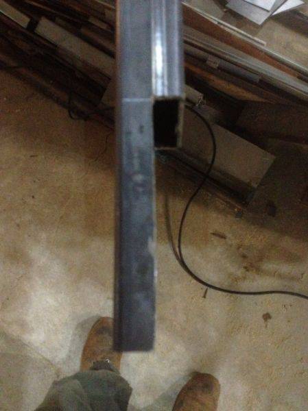

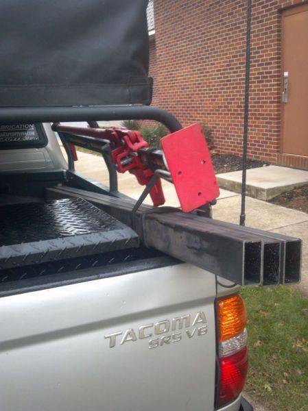

    trying to :drunk:.... I still have to get the tubing , I can get next day free shipping from mcmaster carr but I cant find the right size tubing on there site

    I wish i wouldnt of, it was $5.51/ft :eek:

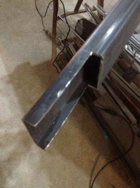

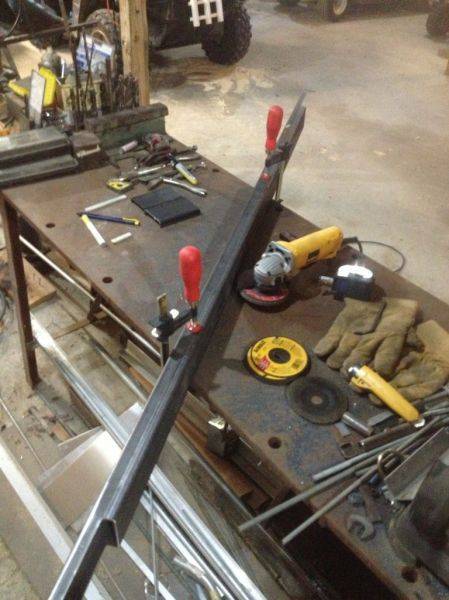

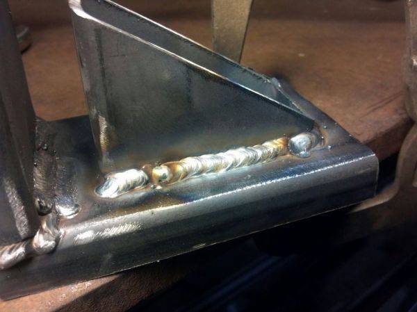

    Started working on the tire gate all I did so far was cut 2 notches in the tube for where the two swings outs meet
    Used some scrap to mess with the welder some more
    I won't be able to get to it again till Wednesday

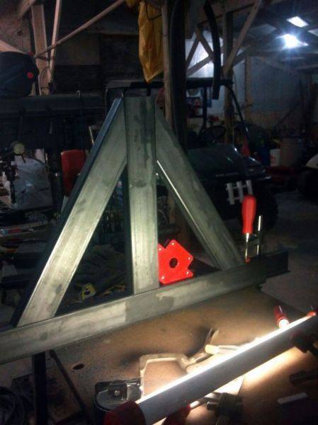

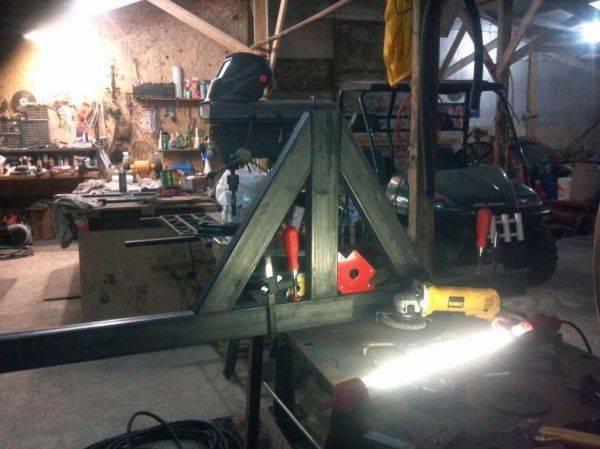

    Okay so I had some free time after work and cut some metal :cool:
    Nothing is tacked or welded yet but this where I'm at so far
    practiced some more with the scrap metal
    and this is the welder.... I'm starting to doubt whether it will be able to do the job seeing as its only a 120V welder... any thoughts?
  16. Dec 4, 2013 at 4:27 PM
    #456
    Box Rocket
    Box Rocket Well-Known Member
    Mar 1, 2010
    #32389
    7,184
    Adam
    Syracuse, Utah
    1995 FZJ80 Land Cruiser
    3xLocked, lifted, well used
    The welder should be able to do what you need it to do. You might need to crank up the heat a bit. It's hard to tell for sure but a couple of those test welds look a little cold. i.e. puddle building up in a pile rather than burning in and penetrating.
  17. Dec 4, 2013 at 4:33 PM
    #457
    sander1036
    sander1036 [OP] Well-Known Member
    Mar 28, 2011
    #53870
    5,055
    Steve
    Snack Food Capital of the World
    02 SR5 TRD Double Cab 4x4
    THULE Roof Rack, Color matched grille w/ GrilleCraft, Toytec Ultimate, 33 x 12.5 Duratracs, Bushwacker Cut Out Flares, Cvt Mt Shasta, Cvt Awning, LEER Cap
    the heat was cranked to the last setting it has.... 7Ga or .187 thickness
    the puddles are probably due to me I'm still trying to get used to the whole thing I'll try to take my good camera out tomorrow and take some pictures of some welds
  18. Dec 4, 2013 at 6:03 PM
    #458
    Box Rocket
    Mar 1, 2010
    #32389
    7,184
    Adam
    Syracuse, Utah
    if your heat is cranked up, then you might be moving too slow or have the wire speed to fast. That could be causing the build up.

    Yea should be able to do anything with that welder. Just need to get used to it.

    Now that you say that I do kinda think im going pretty slow... Ill try to go a little faster and if that doesn't look better ill put the wire speed down some. Ill just have to keep messing with it and report back.
    Thanks for the tips guys I really appreciate ... I don't want this thing to fall off and hurt someone :eek:
