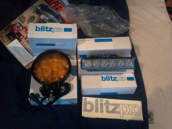

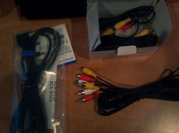

    Got my fogs and two more bed rack lights
    Also got everything I need to finish the head unit up for good
    I also stopped in at Goodyear on the way home and I'm never going back there again :roll eyes: asked the guy if he had any 33's in stock and he immediately says well your shit out of luck and proceeds to tell me he can get one for tomorrow but it will cost $227 :eek:
    So I guess I'm going to try another tire store that deals with goodyear tomorrow.
    However TireRack.com gave me a quote of 183 per tire and 115 per rim only downfall is shipping is 25 for one tire and 45 for two so i wanna see what the other place gives me for a price before I order

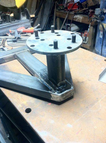

    So I have now completely finished the tire side of the dual swing out, the jerry can side is done for now. Sooo all I need to do is cut my bumper weld the spindles on then weld the swing outs on to the spindles
  9. Jan 25, 2014 at 6:42 PM
    #649
    Black Pipe
    Black Pipe Well-Known Member
    Dec 20, 2013
    #118939
    122
    I'd install a triangle gusset on the underside of the rectangle tube that holds the tire mount to the swing out. The tire will produce a good amount of force when the back of the truck bounces around.
    ~Black Pipe
  10. Jan 25, 2014 at 8:43 PM
    #650
    JLink
    JLink Well-Known Member
    May 9, 2010
    #36795
    12,582
    Josh
    Ocean, NJ
    Lifted, Locked, Armored. Ready To Wheel.
    And while were gusseting, how about you gusset the plate to the rectangular tube :D
  11. Jan 25, 2014 at 8:46 PM
    #651
    HomerTaco
    Mar 28, 2010
    #34129
    45,874
    HomerTaco
    HomerTaco
    HomerTaco
    and don't forget to gusset the gusset... very important.
  12. Jan 25, 2014 at 8:59 PM
    #652
    Black Pipe
    Dec 20, 2013
    #118939
    122

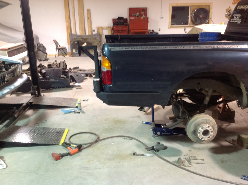

  13. Jan 25, 2014 at 9:55 PM
    #653
    Blackdawg
    Blackdawg Dr. Frankenstein
    Dec 31, 2010
    #48500
    81,638
    Monte
    Wyoming/St. Louis
    The Trifecta of Taco's
    Disagree. Not needed. Thats what the two side arms are for. Be just adding pointless weight doing that.
    He will have bigger problems with the weight just moving the entire swing out in general without a second latch holding it down to the bumper.
  14. Jan 25, 2014 at 10:04 PM
    #654
    Black Pipe
    Dec 20, 2013
    #118939
    122
    All tire carriers I've seen build have that gusset. I guess all you do is then move the failure point to a smaller part of the swing out if you choose not to gusset that area. I'm assuming it would be better for the tire to fall off the swing arm than to lose the whole swing out, either way your out of a spare tire/wheel setup and somebody behind you is gonna be pissed off. I've got a double swing out setup with bushings and a grade 8 bolt holding it in place and have had no movement what so ever, two latches would be overkill IMO.
  15. Jan 25, 2014 at 10:07 PM
    #655
    Blackdawg
    Dec 31, 2010
    #48500
    81,638
    Monte
    Wyoming/St. Louis
    I have no such gusset and have no issues at all.
    He needs a second latch due to how he designed his first latch. Its very smart. But flawed in location.
  16. Jan 25, 2014 at 10:14 PM
    #656
    Box Rocket
    Box Rocket Well-Known Member
    Mar 1, 2010
    #32389
    7,184
    Adam
    Syracuse, Utah
    1995 FZJ80 Land Cruiser
    3xLocked, lifted, well used
    I agree with the suggestion for a gusset under the tire mount. I also agree with the gusset from the plate to the tube. But that's just me.
  17. Jan 25, 2014 at 10:15 PM
    #657
    Black Pipe
    Dec 20, 2013
    #118939
    122
    Just because you don't have a problem yet doesn't mean the design couldn't be improved upon. That's alot of weight on the swingout and a small gusset that weighs less than 1/2 lb goes along way in that design. Just think a typical wheel/tire setup is around 100 lbs so if the length of the tube connecting the swingarm to tire mount is 5" long that's roughly 500 ft-lbs of force being applied at that point.
  18. Jan 25, 2014 at 10:20 PM
    #658
    Blackdawg
    Dec 31, 2010
    #48500
    81,638
    Monte
    Wyoming/St. Louis
    i guess i don't have issues as mine is like this.
  19. Jan 25, 2014 at 10:33 PM
    #659
    Box Rocket
    Mar 1, 2010
    #32389
    7,184
    Adam
    Syracuse, Utah
    Pretty sure that's the type of gusset that Black Pipe is talking about
  20. Jan 25, 2014 at 10:35 PM
    #660
    Blackdawg
    Dec 31, 2010
    #48500
    81,638
    Monte
    Wyoming/St. Louis
    yea maybe i read something odd...been a long day. If i did. I apologize, my bad haha
