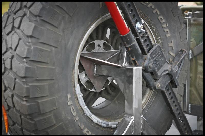

    Yes that's what I was getting at, and after I see Monte's design that is what I would be calling the "gusset" but I've seen other swingouts made with round tube that use something a little less strength wise but get the job done. Went back 2 pages in live and found this

    ahh gotcha. Okay. Just a bit of miss understanding then, so yes, i agree. Something needs to help support that up.

    Thanks for the gusset ideas.... I'll see if I have any 1/4" steel plate to add the gusset to the plate and I'll just cut a short piece of tube for the other gusset
    If I have any 1/2" steel I'll gusset my gussets ;)

    1/4" is overkill on the plate. But if you've got it, use it. I used 3/16" on mine.

    I'll see what I have laying around not sure what I have on the scrap pile... Is one gusset enough for the plate, or is 2 on opposite corners a better idea

    A single gusset on the plate should be enough. The more important one is the triangulated piece to support the horizontal piece that the plate is welded to.

    Awesome thanks a lot Adam and everyone else it's nice to have some expertise on the subject... Since I'm sorta guessing here

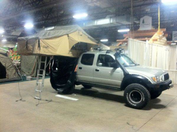

    and I dropped my truck off last night at the Great American Outdoor Show. Bobby from CVT is going to use it as a display. Bobby wasn't in town yet so i set everything up at his booth for today.

    I'll be there a few times…. wish i could've finished it but it was just too cold to work on
