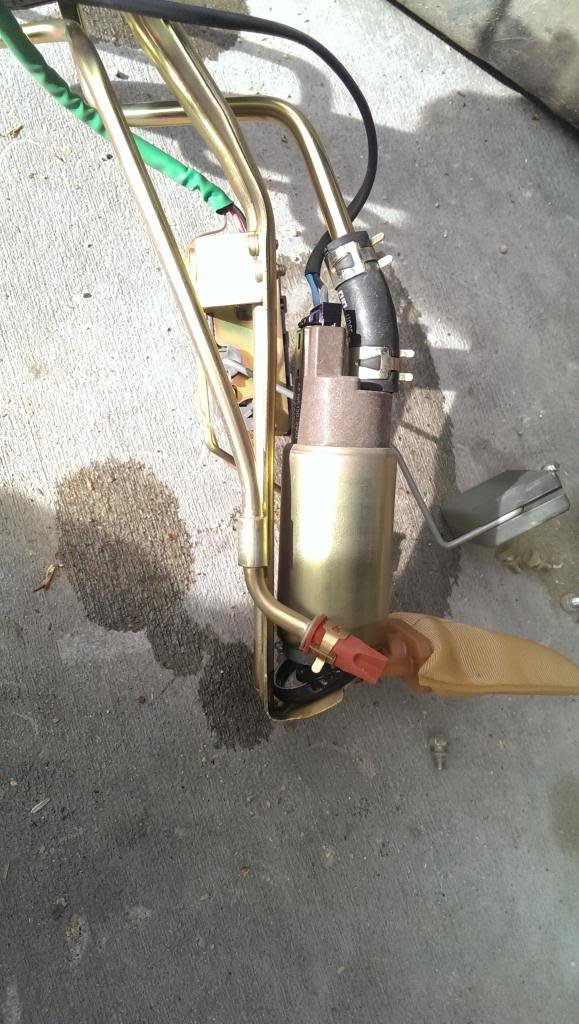

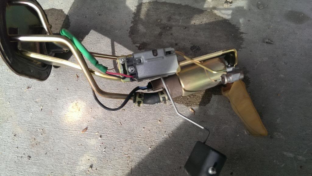

    Didn't read enough to see if you did anything to your tank, but figured I'd explain the little I know. I guess it could be some sort of electrical problem with the sender, in which case this isn't really applicable.
    I had all sorts of issues with my gas gauge after denting the tank pretty bad. First off, the low fuel light sensor is a completely separate device from the gas gauge float.
    Here's some pictures of my (very bent) sending unit.
    In the first picture, the little silver round thing is the low fuel sensor, and the float is pretty obvious. My original problem with the gas gauge was that it worked from full to about 5/8 of a tank and stopped. What I ended up doing was dropping my tank, which is actually pretty easy.
    With the tank out and the sending unit out, you should be able to see what it's getting stuck on. There is a square plastic baffle in the tank that the sending unit sits it, and the float is very tight against this baffle. With my bent sending unit, the float would get stuck. I bent it a little the first time, mainly in an attempt to get the fuel pump back to the bottom of the tank, and after that, my gas gauge only worked from like 1/8 tank down. Dropped it again and really studied it, this time, looked at the sending unit through the other hole in the top of the tank (vent?) and was able to bend everything back so that it works.
    Sorry if this isn't pertinent to your issue, but though it might be helpful.

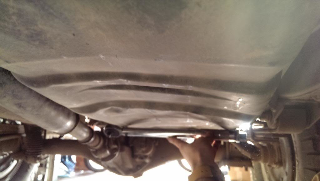

    Here's what my tank looked like after I smashed it (and the carrier bearing).
    Sending unit was very easy to bend back. Also manged to pop quite a bit of the dent out of the tank though the sending unit opening. Just take your time, look the through the other hole in the tank, and get everything lined up so the pump is at the bottom, and the float has full range of motion. I tied a string to my float, set the sending unit in place, and pulled while watching through the other hole.
    Also, don't think a new sending unit would help as it won't match your dented tank. Could always go with a junkyard tank too. If you charcoal canister is on top of your tank, you're going to have a harder time finding one though. IIRC, the charcoal canister is only on the top of the tank in late 02-04, all the rest had them under the hood.
    Also, I heard some mention of pulling the bed. You'll get arguments about this, but I dropped my tank a few times, and could probably do it in less than 30 minutes. With it dropped, you'll also has better access to fix your issues.
