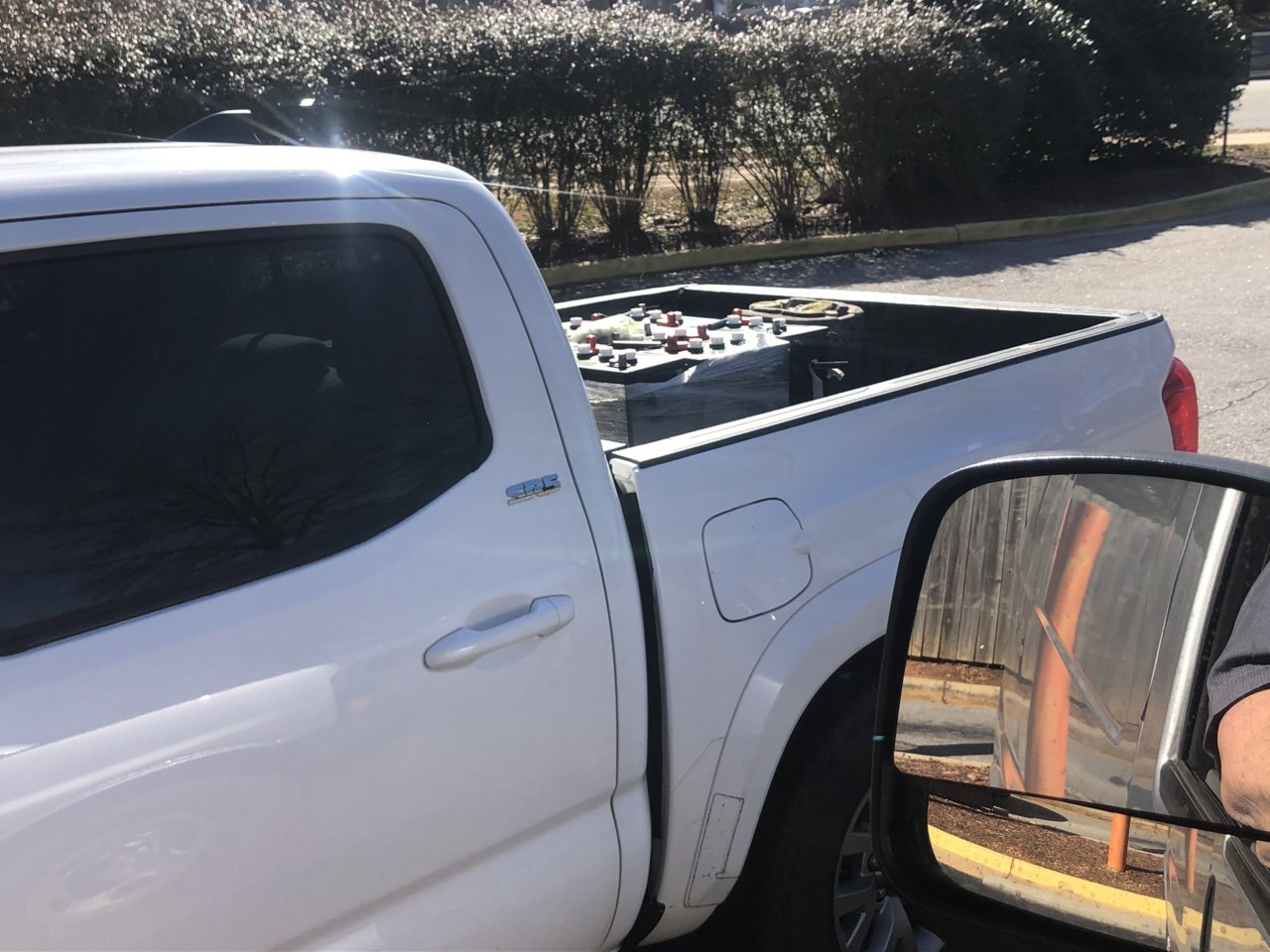

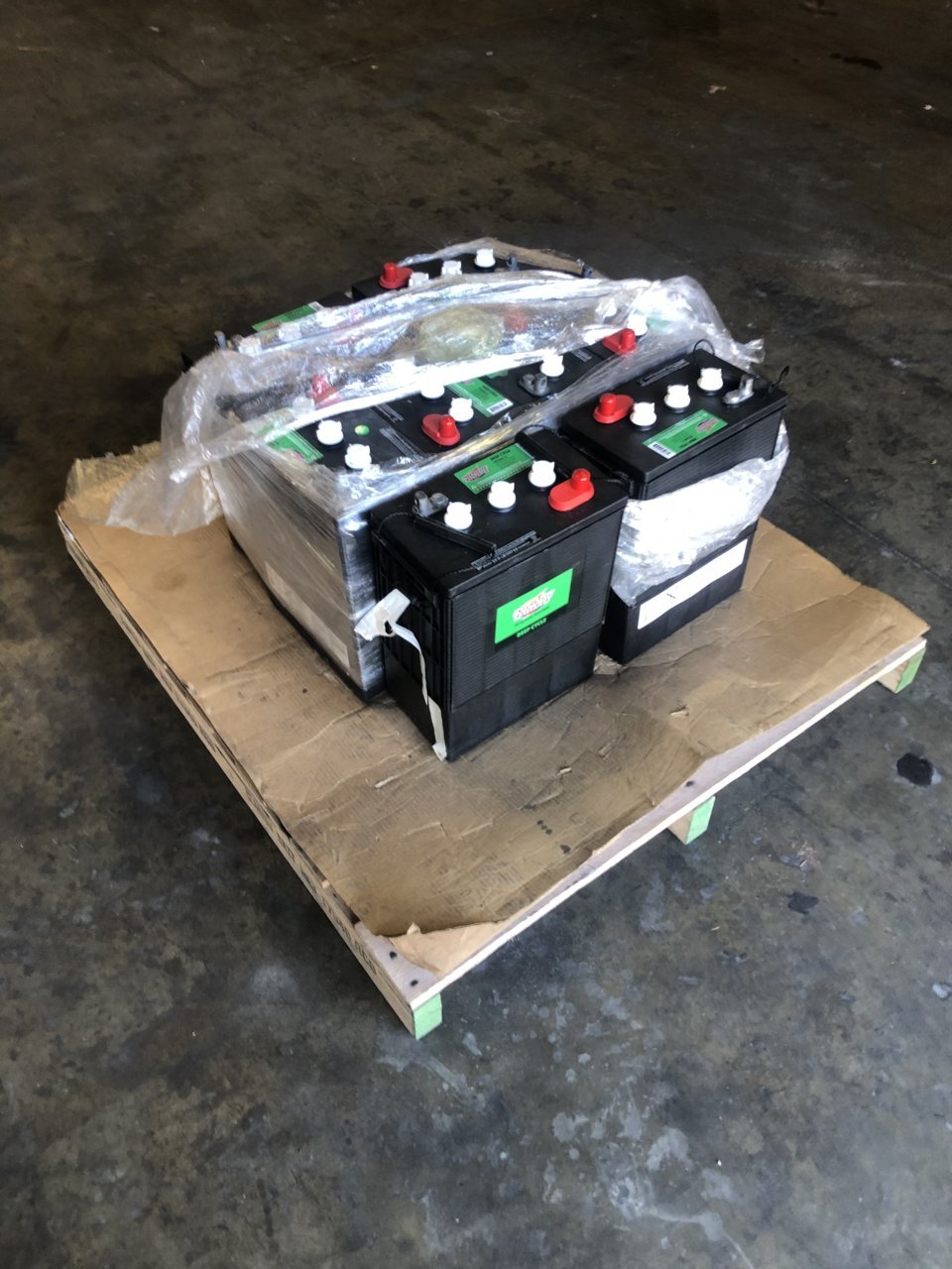

    Pretty sure most folks don’t have a load like this in the bed a few times a month WHICH WAS NORMAL for my truck prior to my getting it along with pulling a 16ft enclosed trailer
    that’s 8 415ah 6v batteries about 120lb ea they9EEBEEB7-97E8-4876-BF9A-8FD2FCE87B17.jpg 23E9E317-14FE-4C84-B451-9CFCC3624F30.jpg are sitting in the rear of a 2016

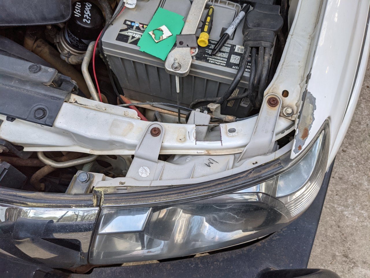

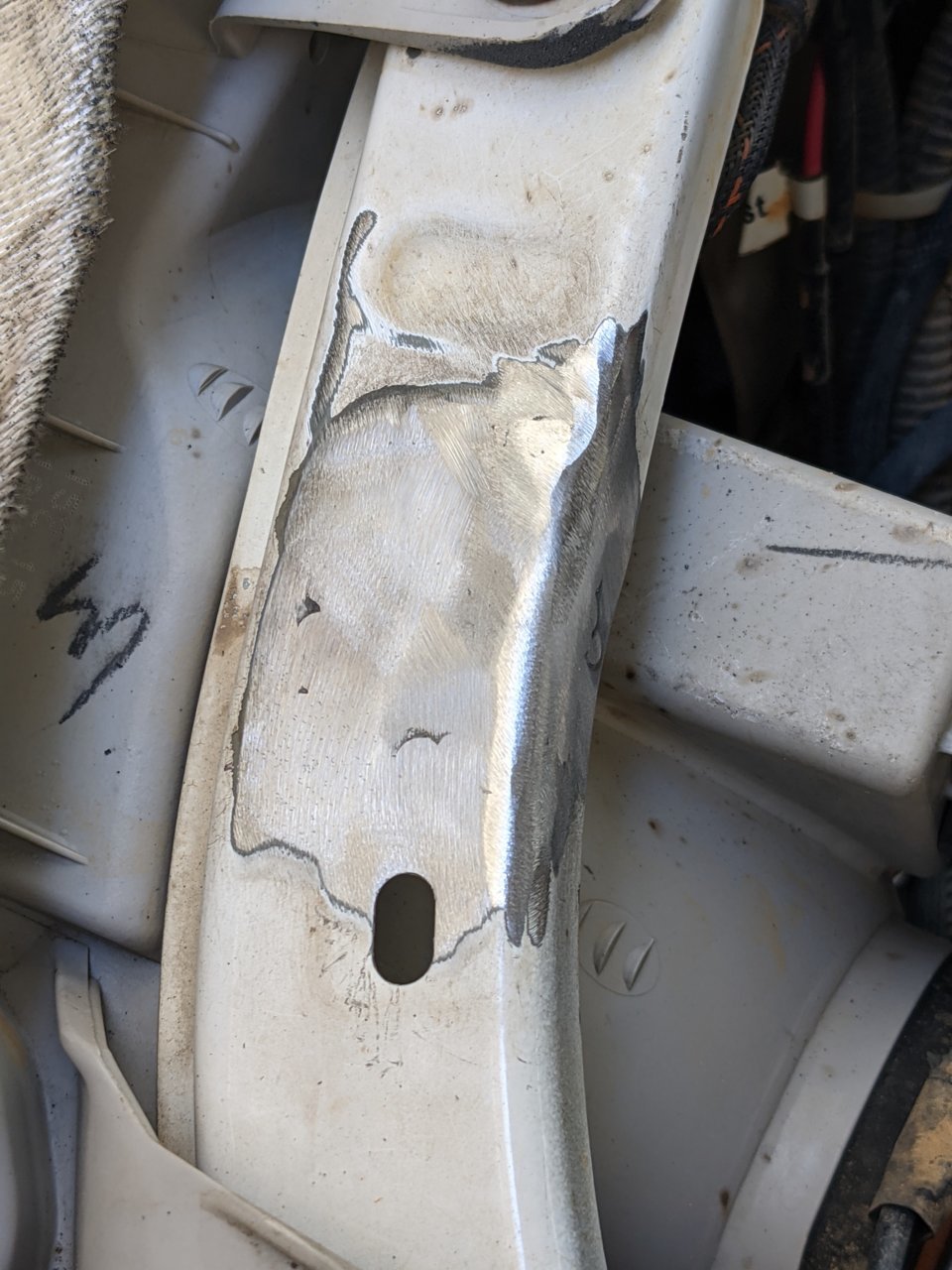

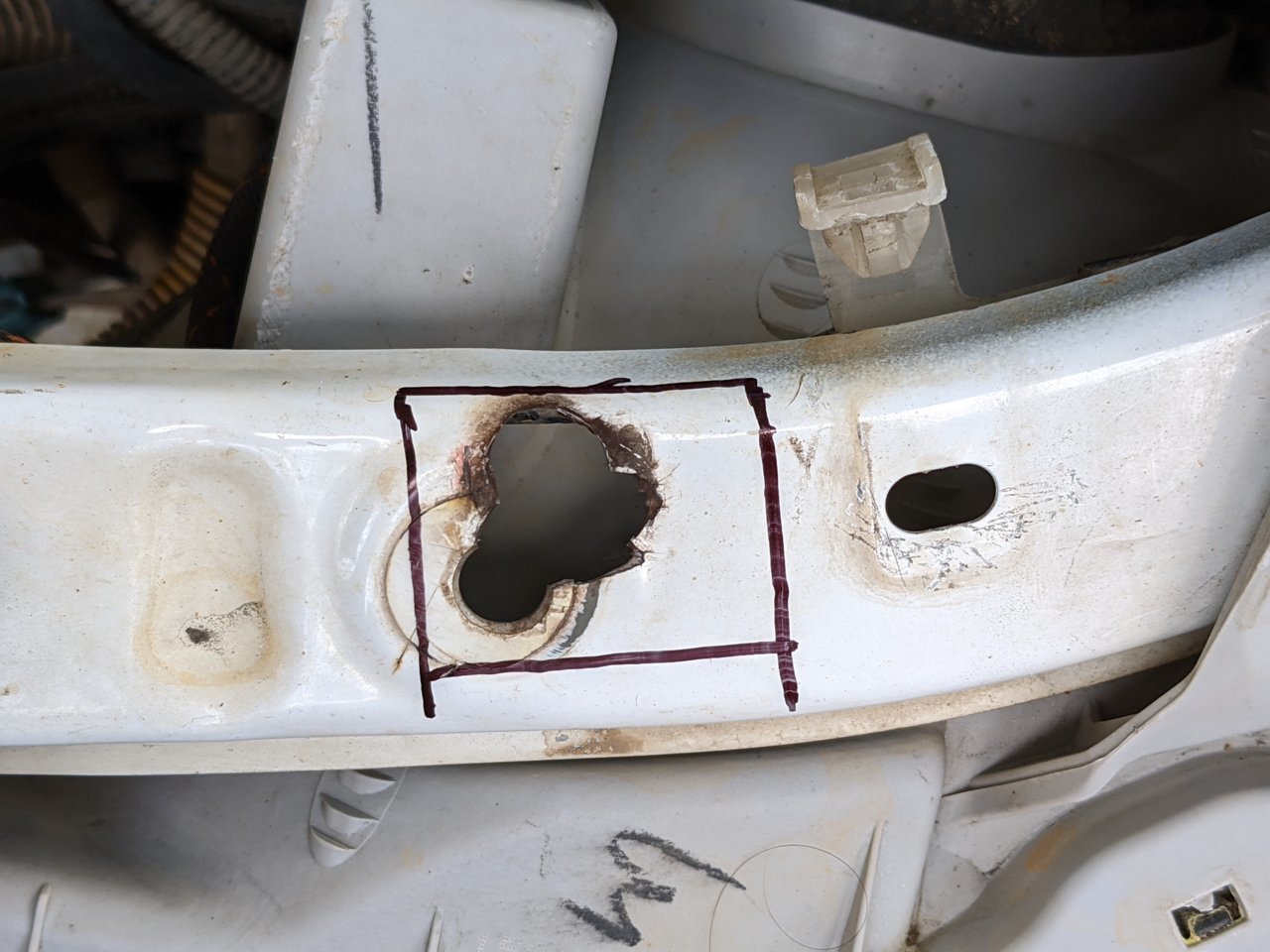

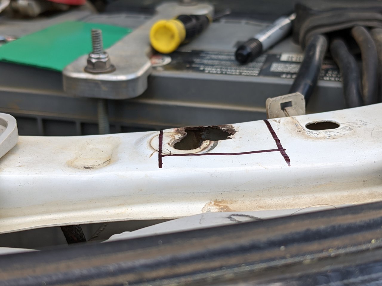

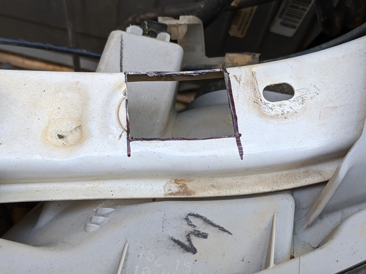

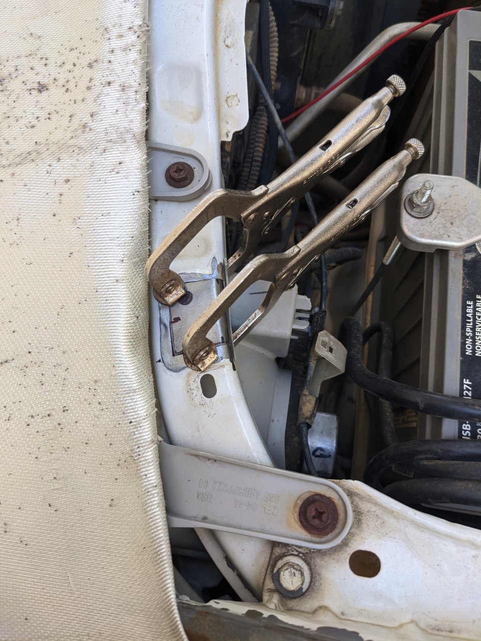

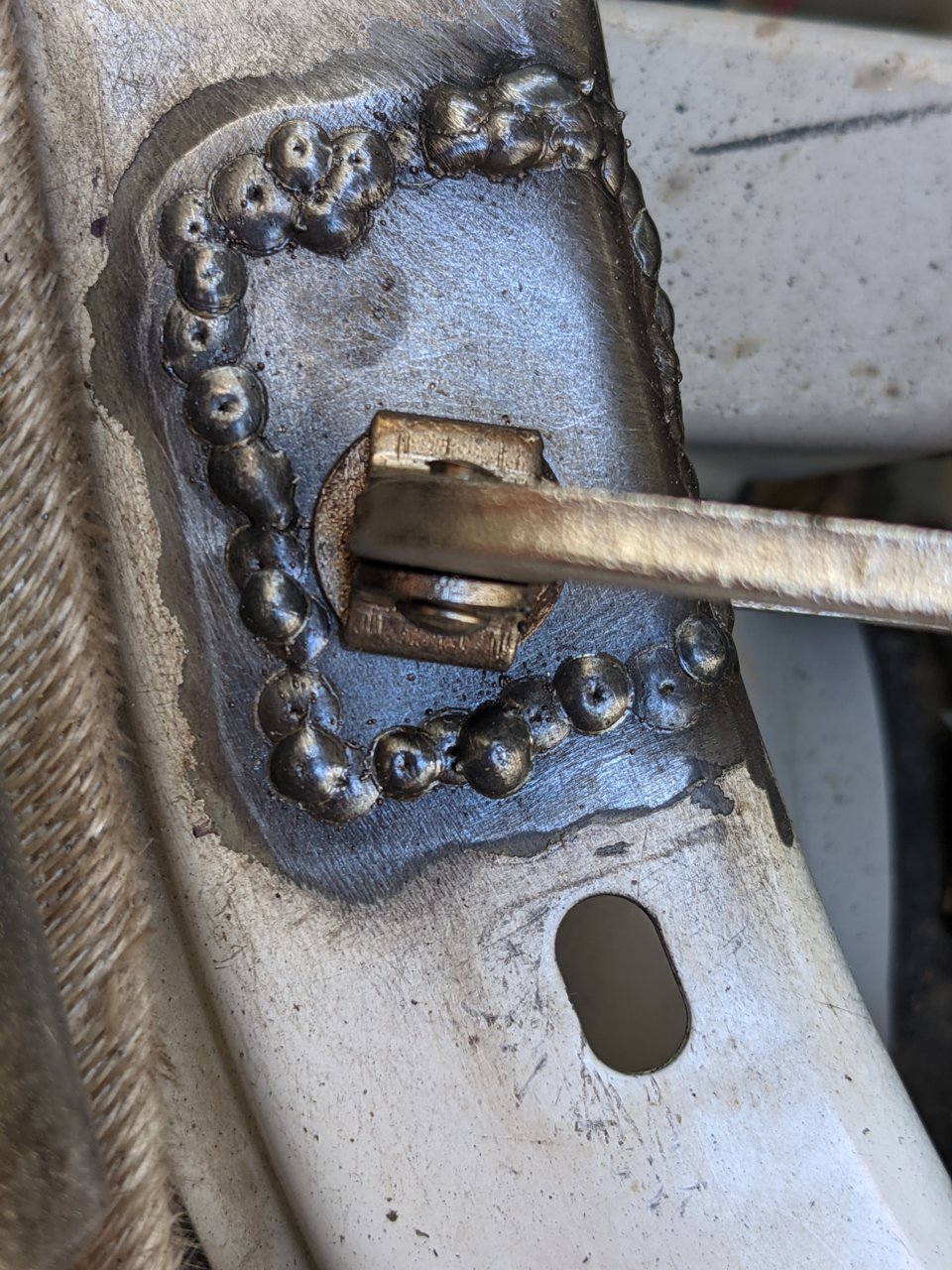

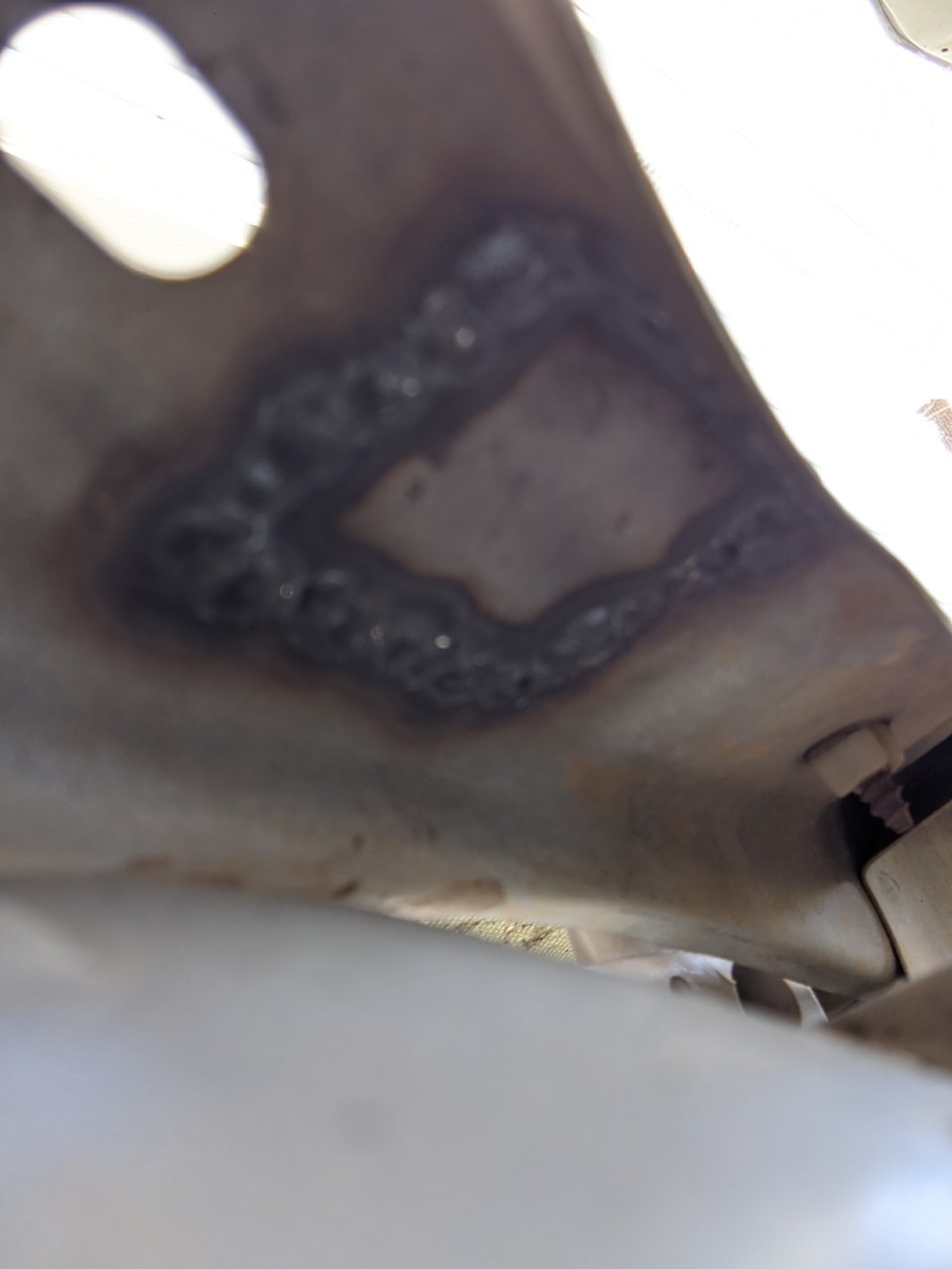

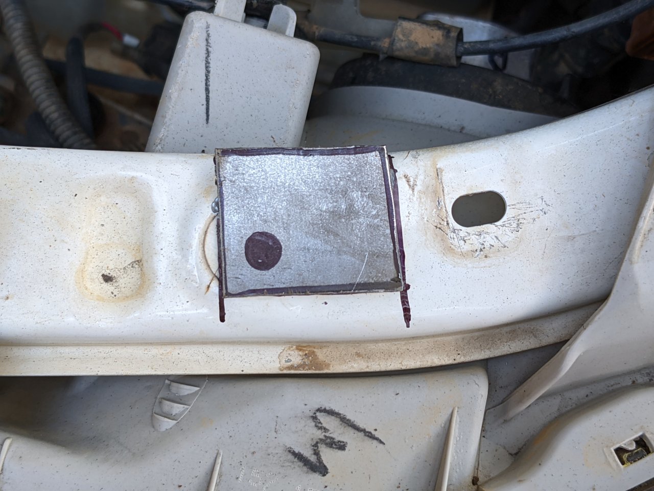

    A short story in pictures titled Hood Pin

    Did your hood pin tear through? Nice job.

    Yea, several years of offroad I guess was too much for the factory metal. I plan to plate over this to reinforce it some more.

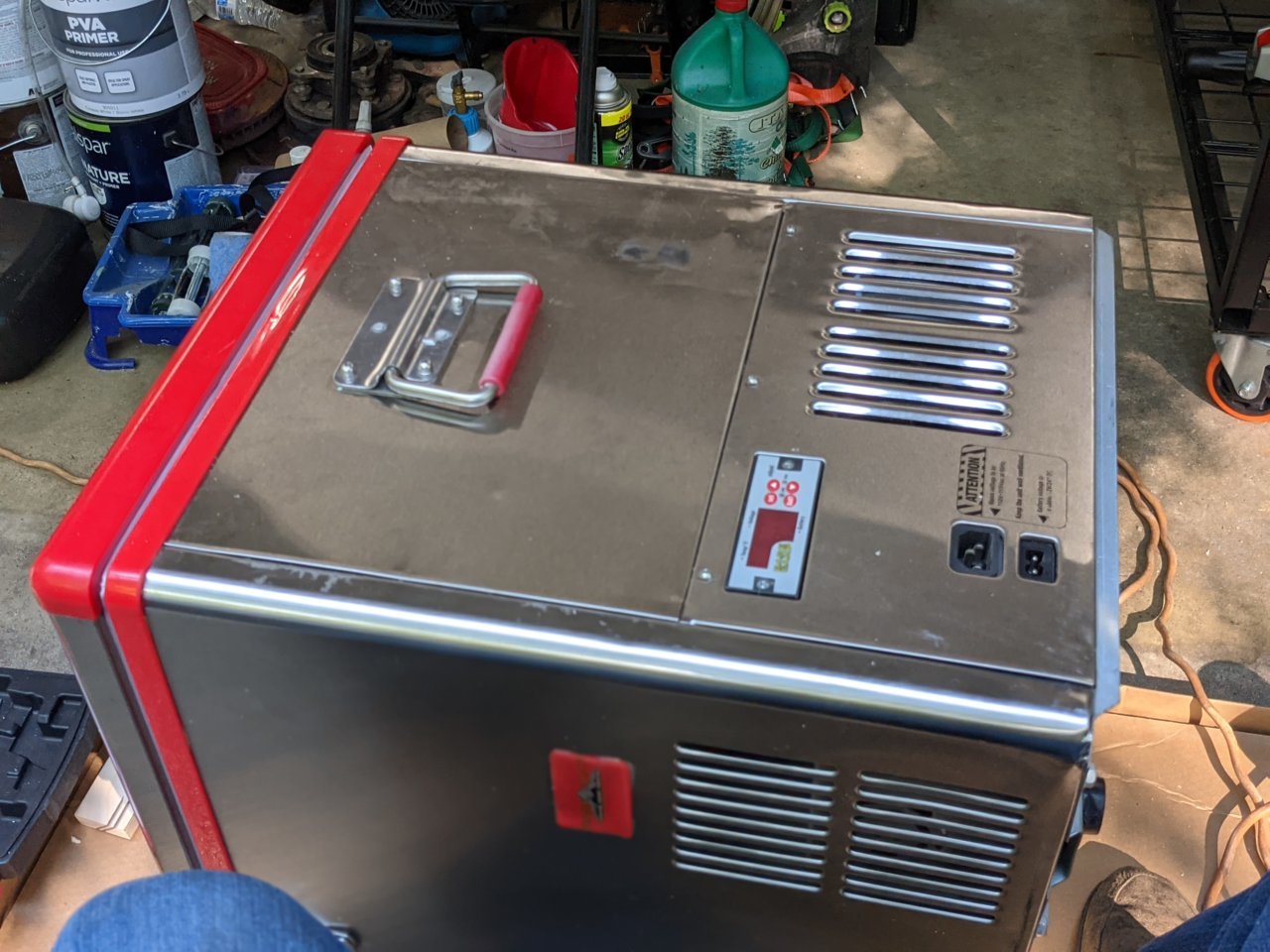

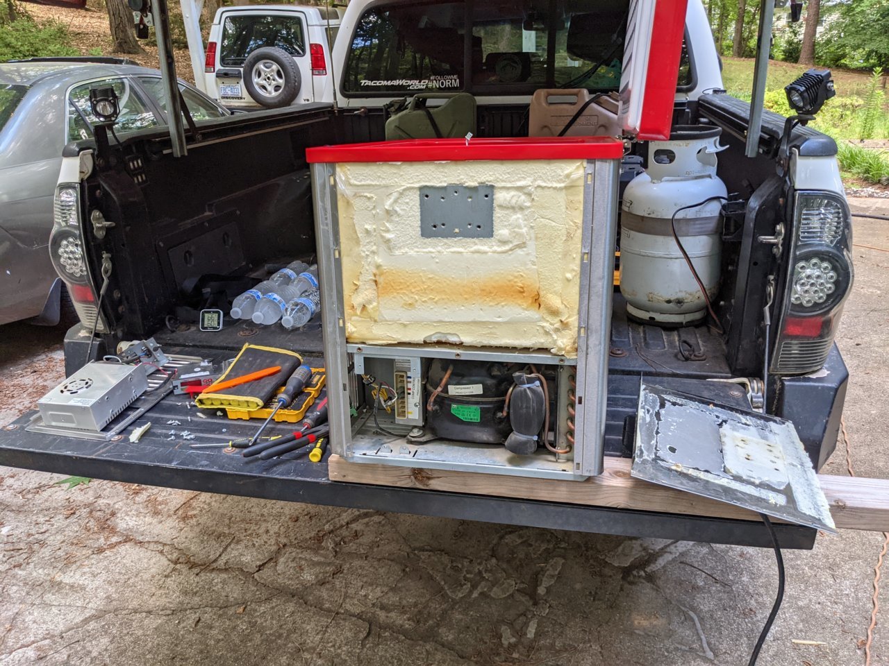

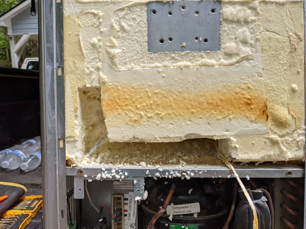

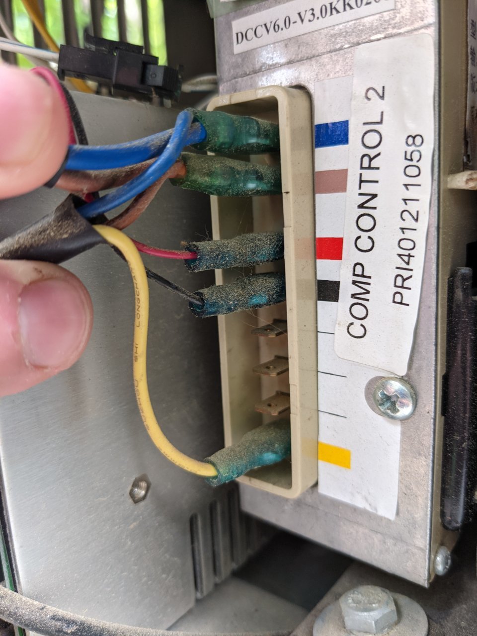

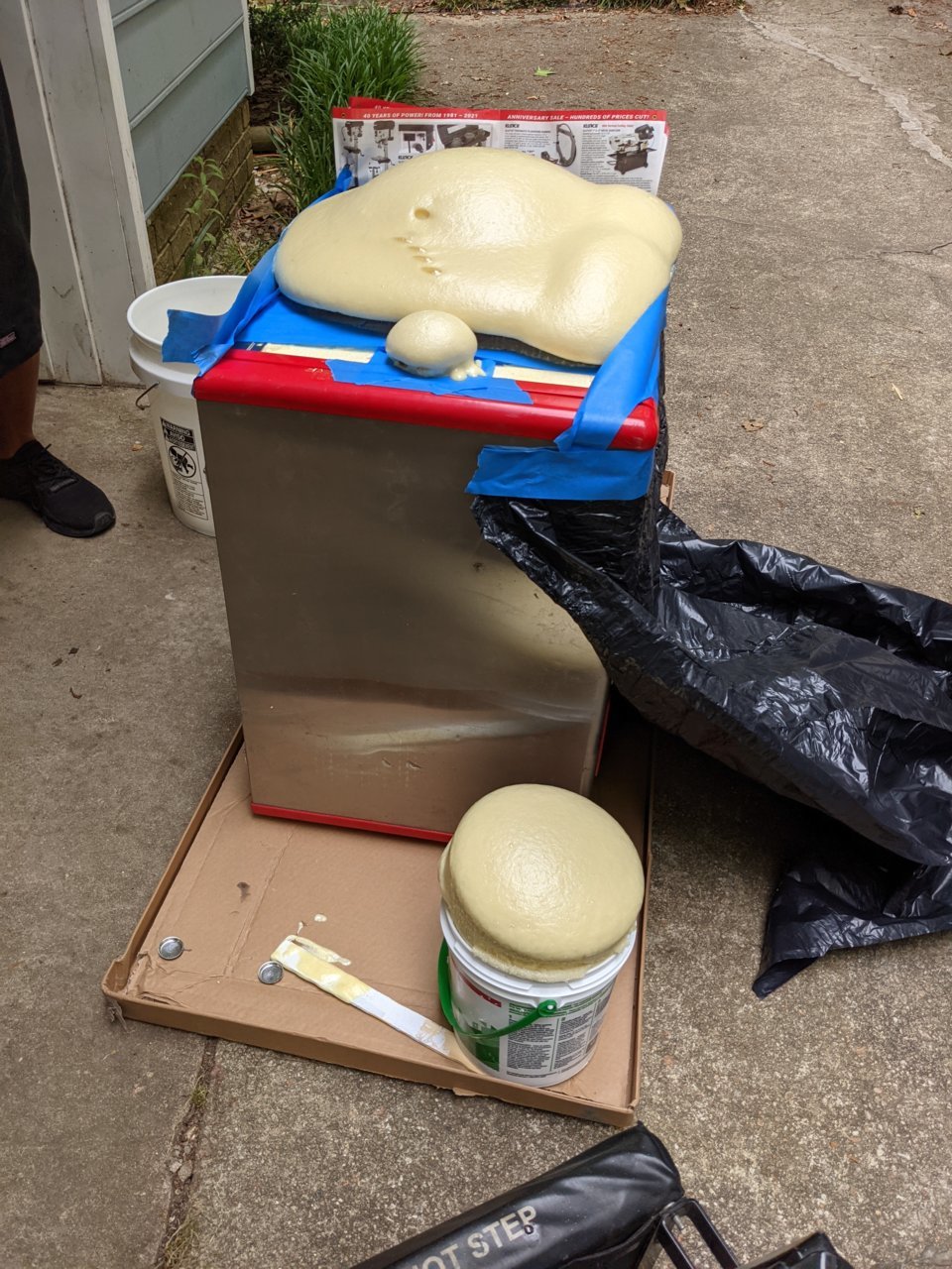

    This should finally make the fridge run right again. PSA don't forget to put your tailgate back up... Installed new thermistors.

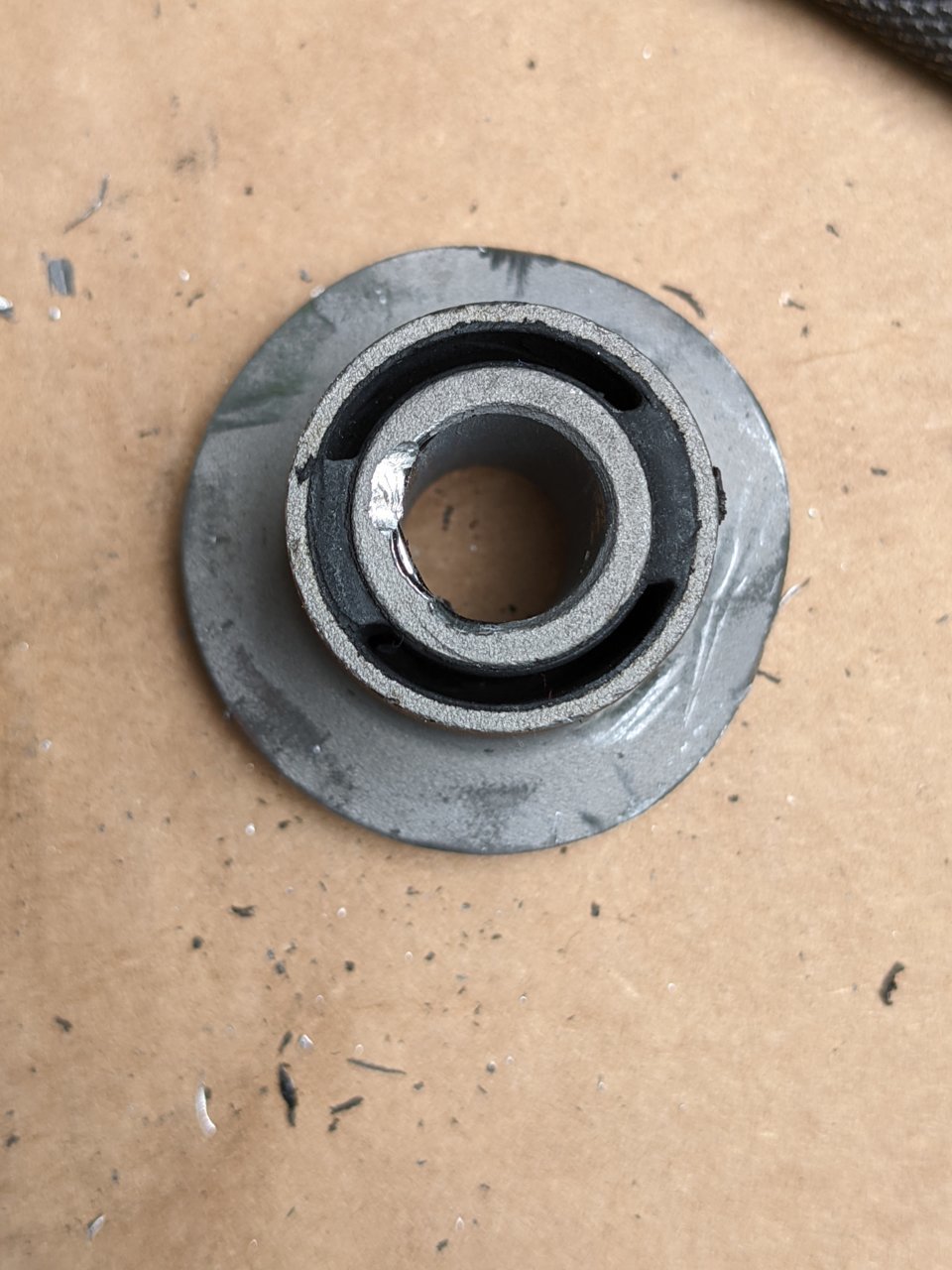

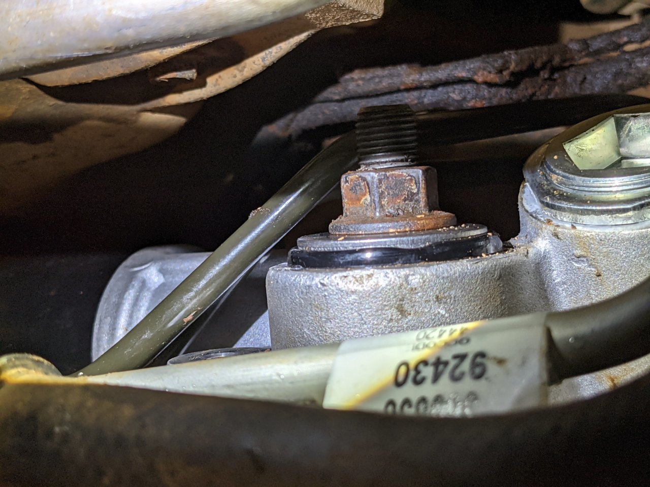

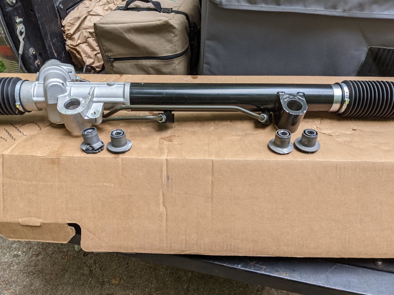

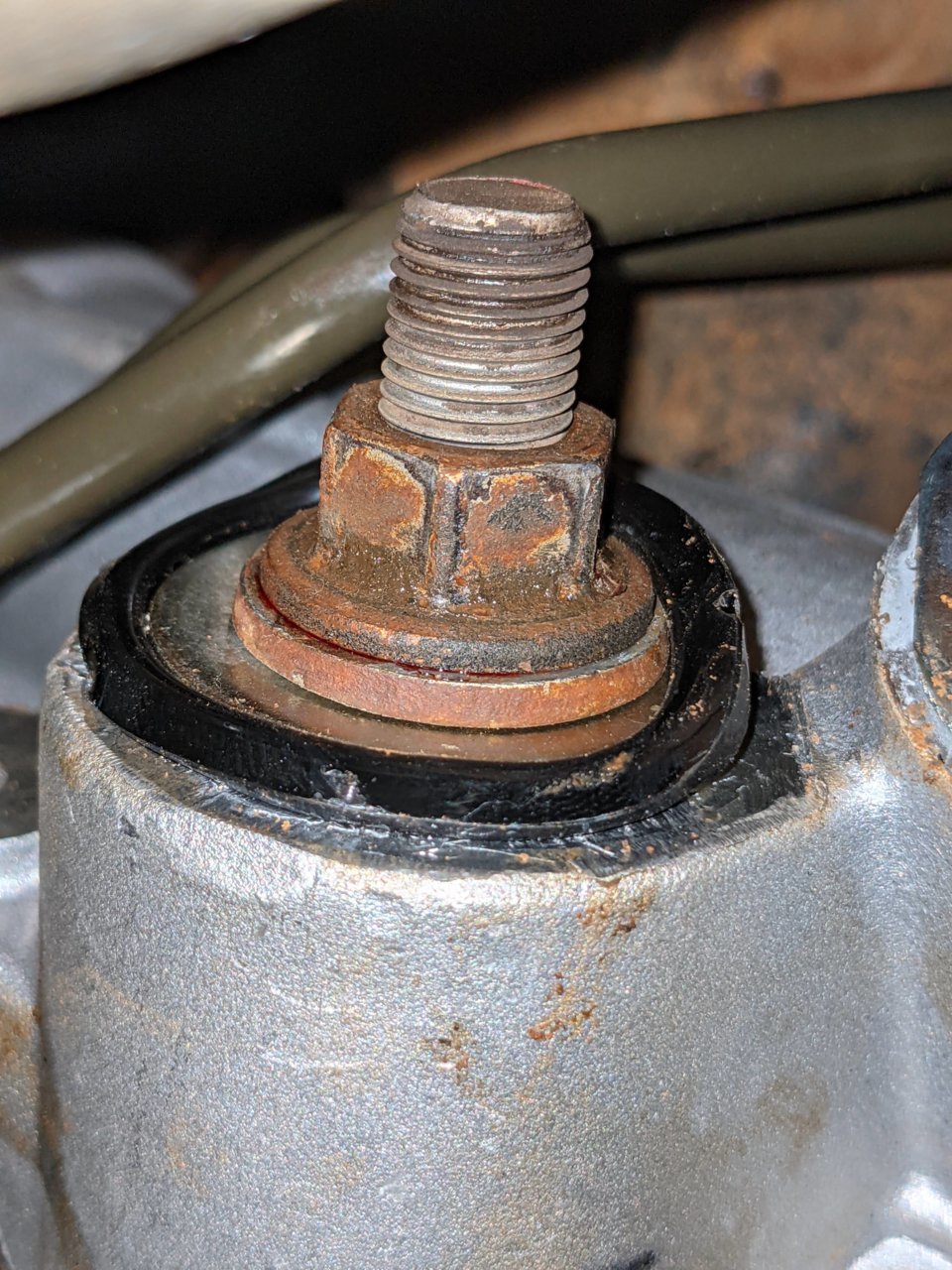

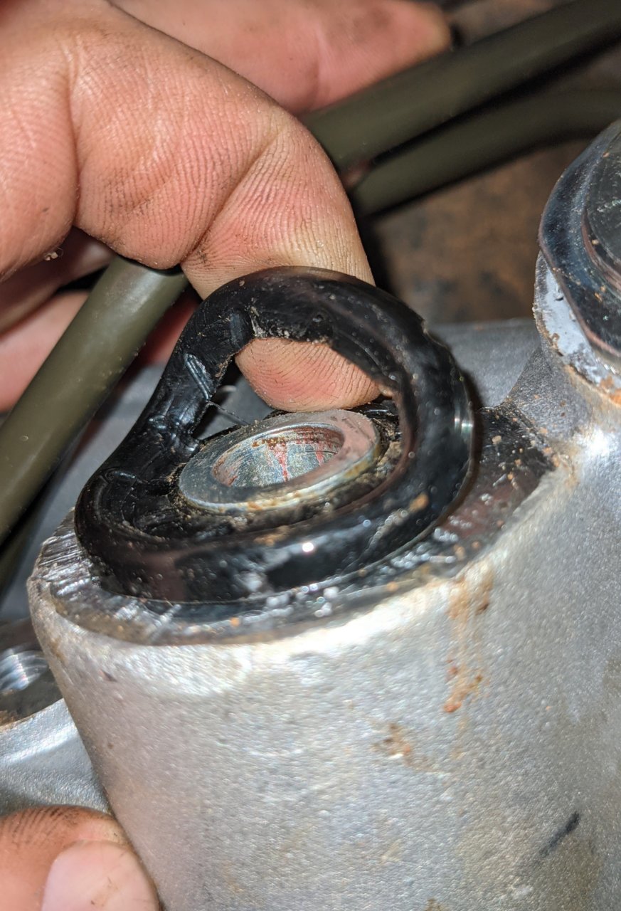

    Well that was obnoxious.. Got a New Cardone 97-2692 steering rack and whiteline W13400 bushings. They're 2 piece bushings, the ones in the steel were as you'd expect to get out but the ones in the aluminum were a bitch! Also there's not much in the way of bushing in the original ones.. And oriented 90* out from what I thought they'd be?
    Whiteline says only use supplied grease, and there was no grease. Further reading sounds like no grease is needed because it's just a cushion, not a rotating bushing.

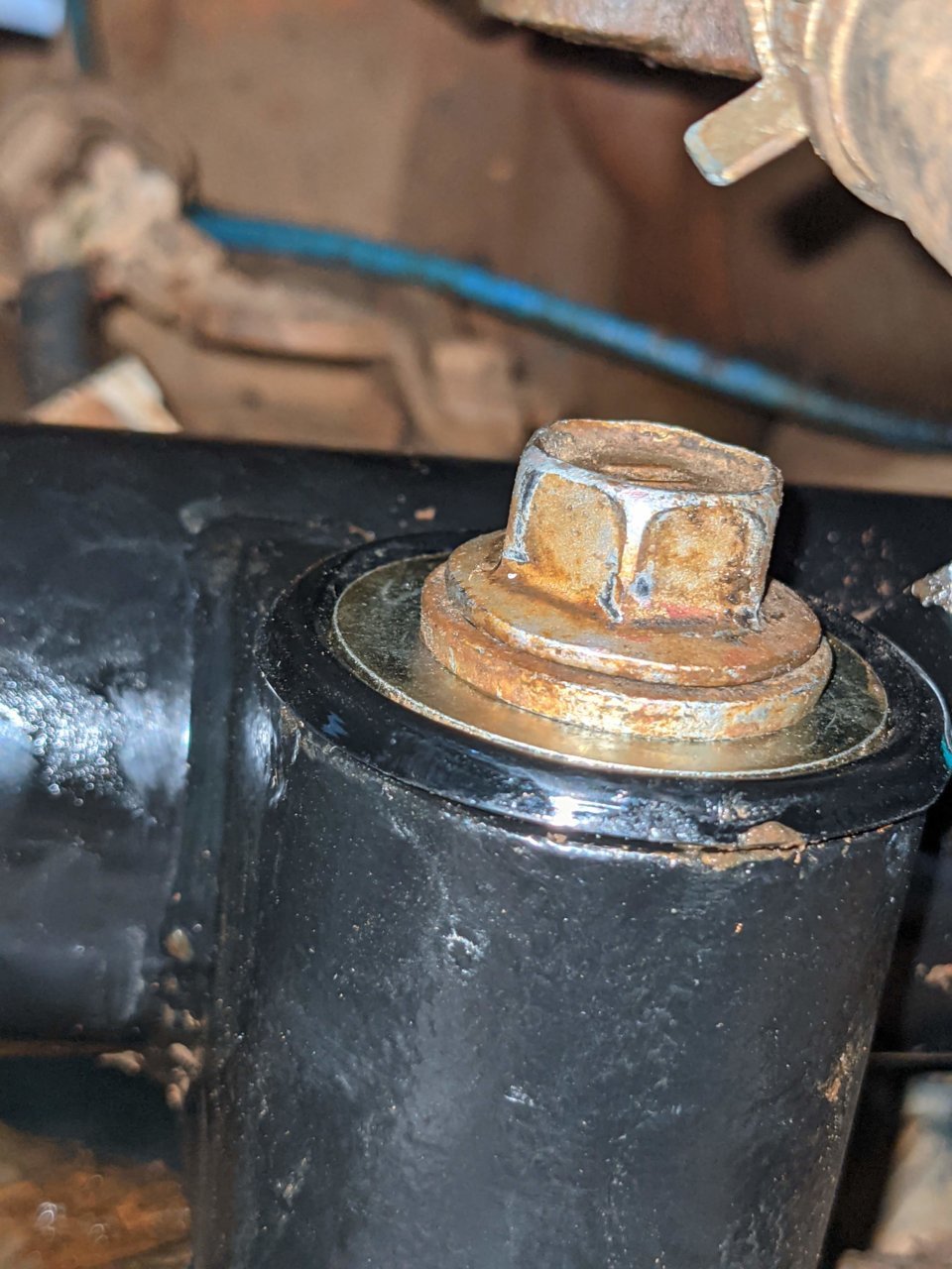

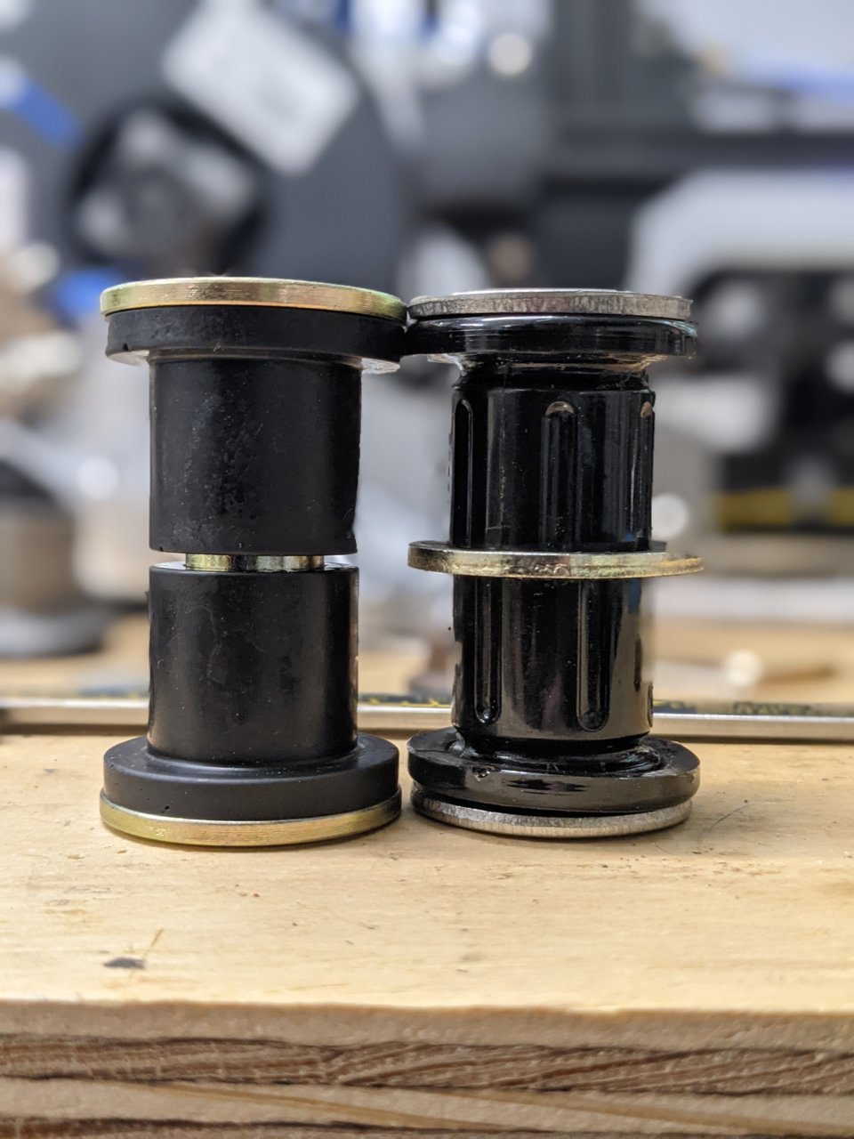

    I'm back on chat support with Whiteline.. W13400 does not fit correctly or I got a bad kit.. The sleeves are too short to reach all the way through the bushings and allow the weird washer design to cut the lips off the bushing. I only tightened them to factory spec (68ft/lbs).
    On a new Cardone rack.. Not that it should matter, the bushing "housing" is the same inner diam and height.

    New washers showed up. When I get the whiteline RMA bushings I'll use them. *The center washer is just to show the 3mm gap that will be between the sleeves/bushings.

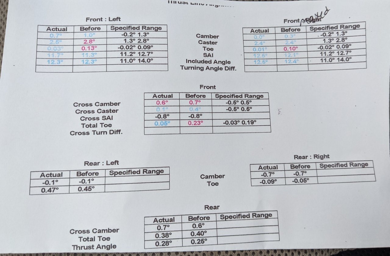

    Update:
    New bushings/washers are in with minimal squeeze out. I'm much happier with this install. I'll get the wheels back on and an alignment this weekend.
    Alignment wasn't that far off when I put it back together. Drives nice and tight again!

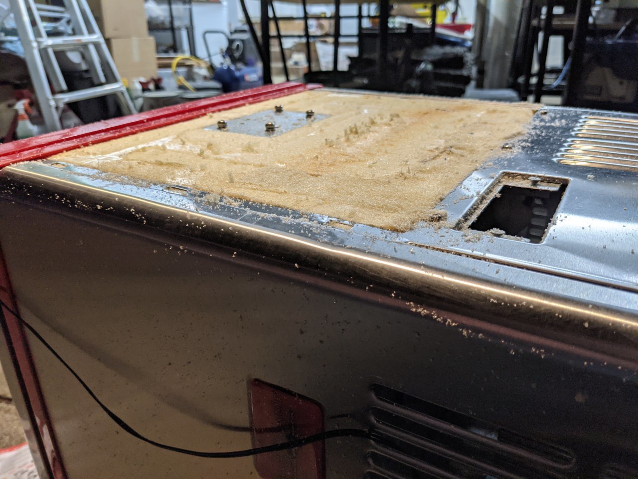

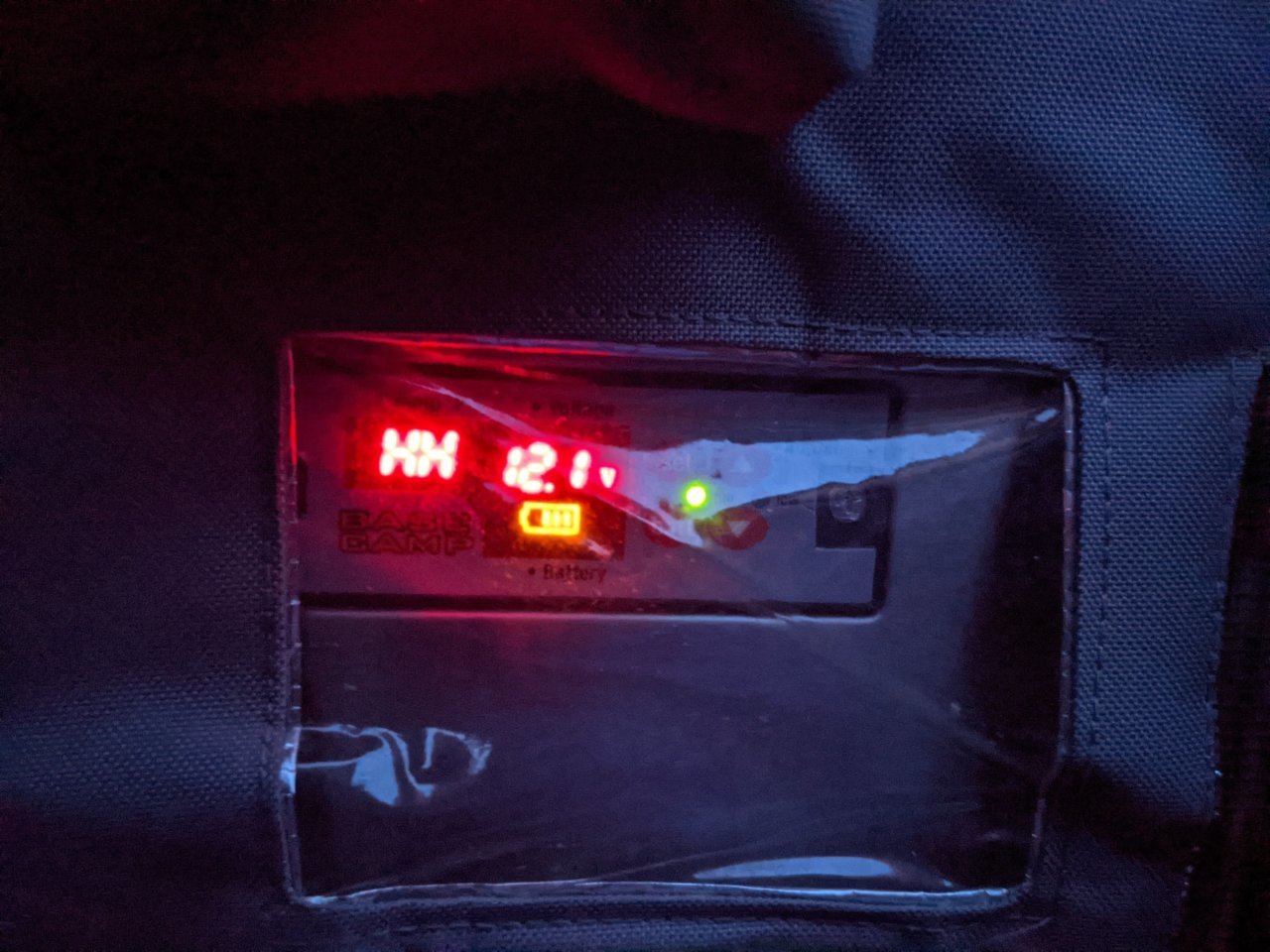

    Cleaned out all the pine needles and trash, enbiggun'd the drain holes, and fixed my house battery. Marine circuit breakers are not waterproof... I got rubber booties now.

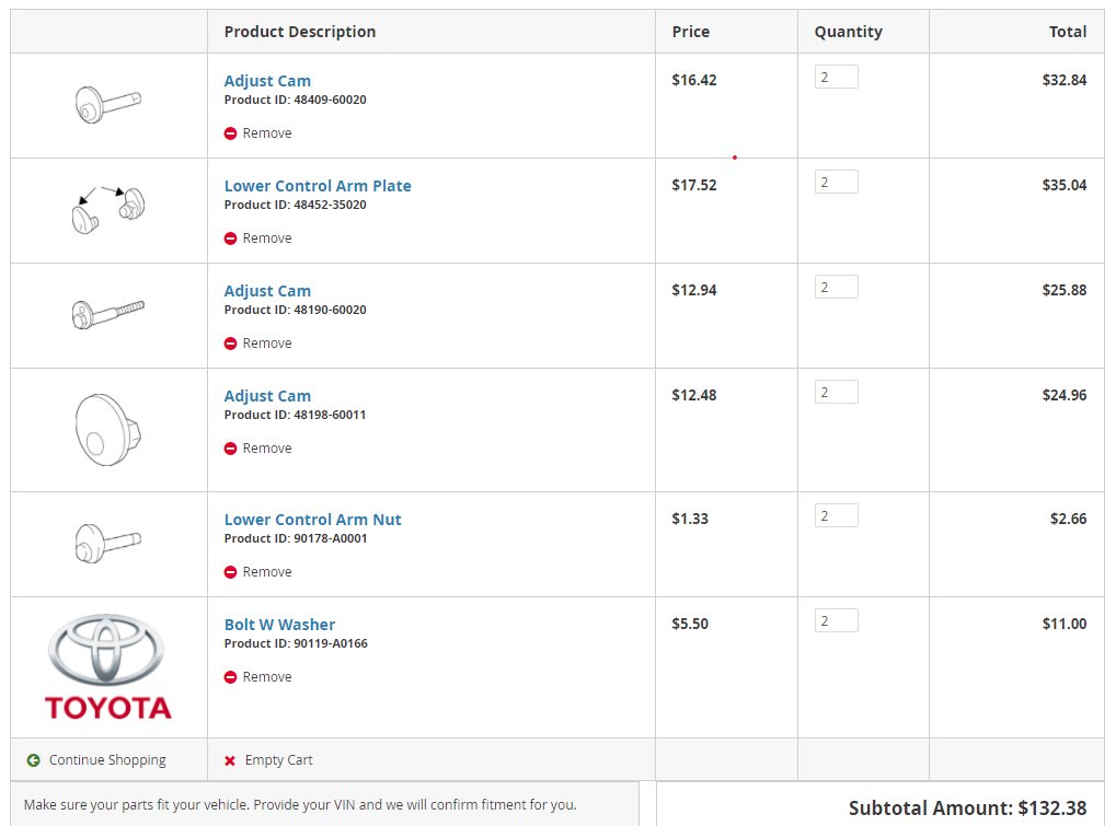

    here is what I came up with. from this thread. Changed an incorrect qty and incorrect part #.
    from the Camelback Toyota store.
