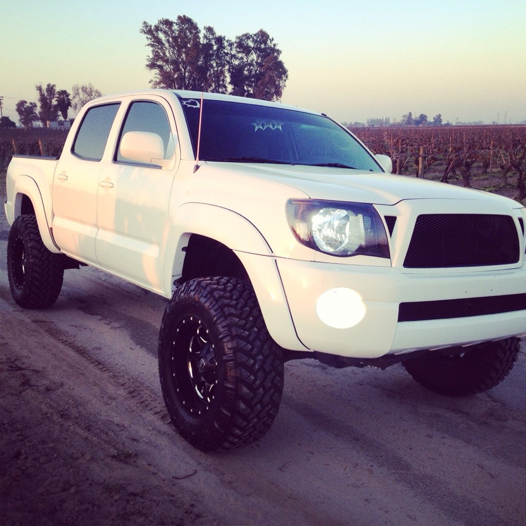

    How it sits.
    10410156_1024469290912646_67524914184860_e8d90de0c9361e404792831ee3ab500ebacc5774.jpg
    Makin it Pretty Mods:
    Engage Long Travel
    Fiberwerx Fenders
    Custom Made bed cage
    16" double bypass
    Deavers
    17" Fuel Boost Rims
    285/70R17 Nitto Trail Grapplers
    Color Matched everything
    2 Kicker 10" Subs ​

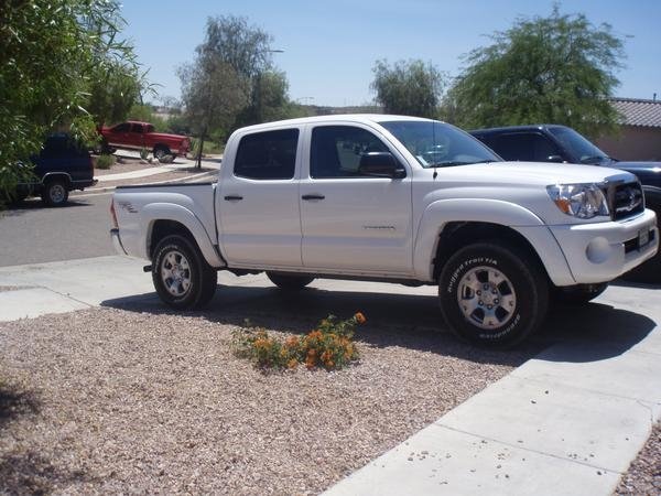

    Day 1 Straight off the lot in Cali Driven Home to Phoenix..
    d1bd5bd2-3c72-4666-aee1-3b7ca4c3efcb_zps_eb89b9fec895bf9754003979ac693e969f314df2.jpg

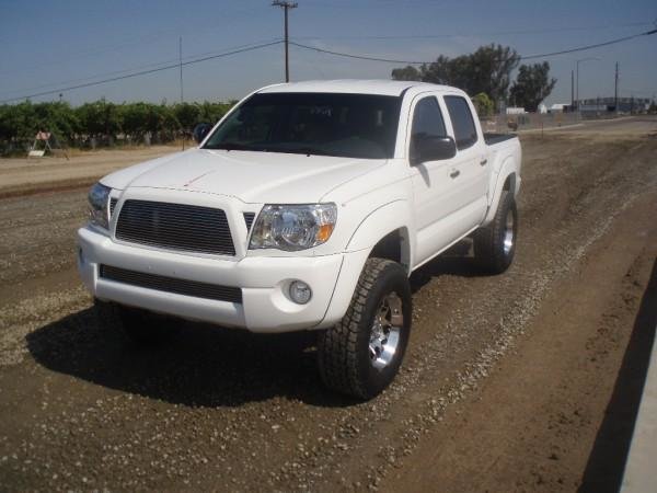

    Some idiot ran a red light and hit me... Decided to Color match the grille.. The shop that fixed it decided to add some ugly pin stripping to it without asking me...
    Decided to Color match the rest of it

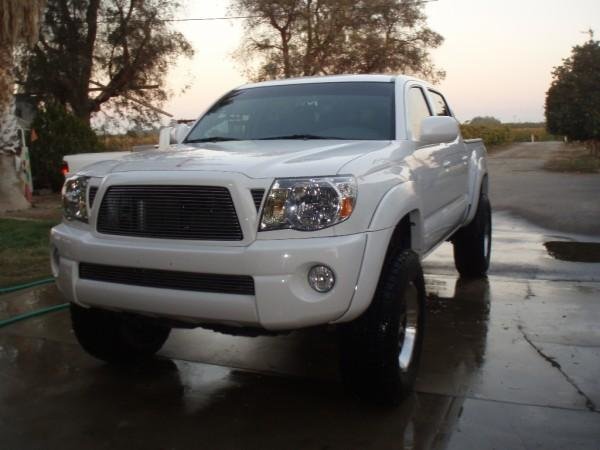

    Finally took the pin stripping off and got new Wheels and Tires and changed out the spaces for Maxtrac spindles ​

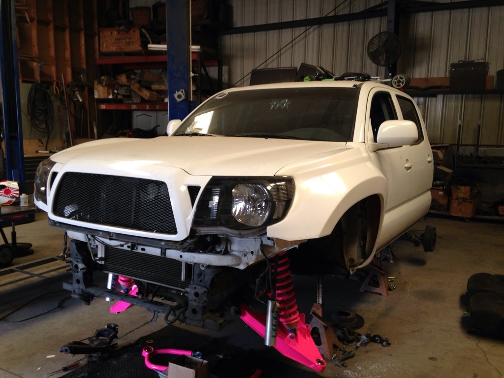

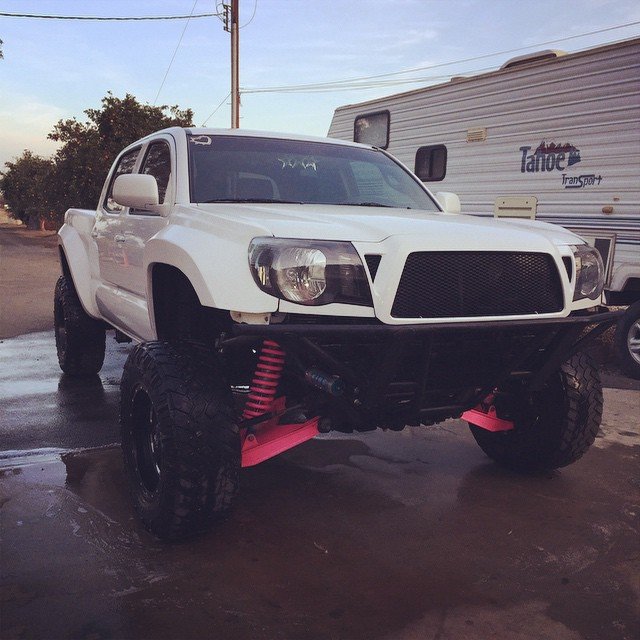

    Long Travel Process
    49dbd2ba194aae6501e5b5a343fae04a_3b73d5fee302528a5b510c8119889312f4779c0b.jpg658394f98f7765c3fee554437ac47b0d_0532c1b8d1b7ae8a901af2fd2e16fc06e450f94f.jpg

    Cool looking truck. Much better without the pinstripes. I'm putting on Fuel Boosts with 285/70/17 on Friday, glad to see how sweet it will look. Do the tires/wheels still sit within the wheel well or do the stick out a little?

    They stick out a little bit theyre the same size as the old tires i had on it so I dunno if you can see it from the front shot or not

    Do you get rubbing with the 285 tires?

    SaraLynn what offset do your Fuels have? I drove 100 miles Friday to have mine put on and they couldn't get them on and they were going to rub on the UCA anyway. Was planning on putting on Duratrac 285/70/17. The shop ordered new Fuel Boosts and Duratrac 285/75/16 with a different offset this go around and they promise to do what it takes to make them fit. I can't believe that fit on your ride. How did you do it?

    They rub a little bit just with sharp turns Mostly because theyre a mud tire so they have bigger tread my nitto terra grapplers didnt rub once i cut some of the plastic
    They're 17x9 with a backspacing of 4.50... Thats the norm with 17x9 they should've fit unless they ordered you 17x12 or something ridiculous
