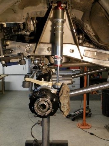

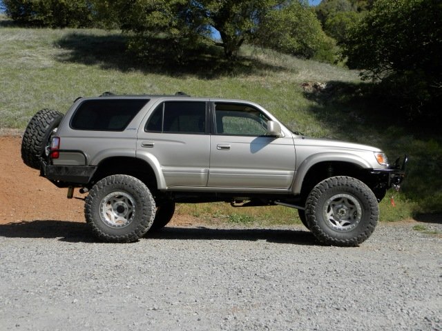

    I just built a 2001 4Runner for a customer with a 3 link in the front and leafs out back. It was a 3.4L/Auto truck to begin twith and it had the electronic case and ABS. It was a $30K+ build. So no, building an older Tacoma is not necessarily going to be cheaper. Areas where you could save money: buy a truck without ABS, a manual shift t-case, and use a junkyard D60 for the front.
    The problem with the older (1985) trucks is that they have no power. The 2005+ 1GR-FE 4.0L has V8-like HP, so comparing the two is really not fair.
