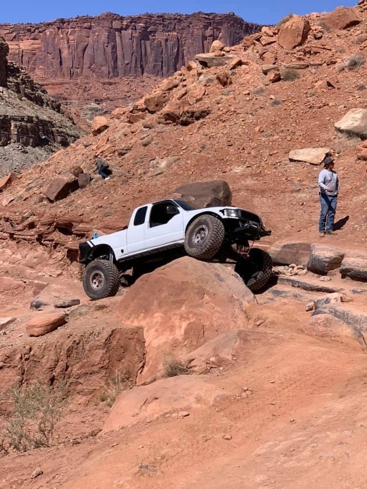

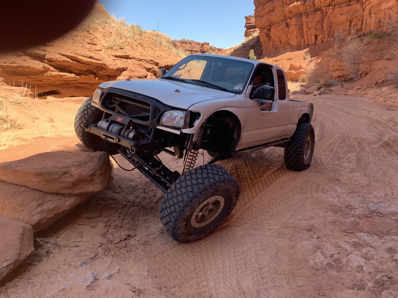

    Just finished mine for the 3rd time? First trip out was a week in moab with no major issues. B16EAF45-E699-404F-B378-1C23106CF50B.jpg08DB5670-CD60-4CE6-9933-5C49754E8CC3.jpg

    That turned out great :headbang:. How do you like it now compared to leaf springs? Do you think the juice was worth the squeeze? lol
    Only if you add the numbers for the expenses :laughing:

    Worlds ahead. More so having 6.5 inches of uptravel vs two. Less axle wrap as well now which helps as well.

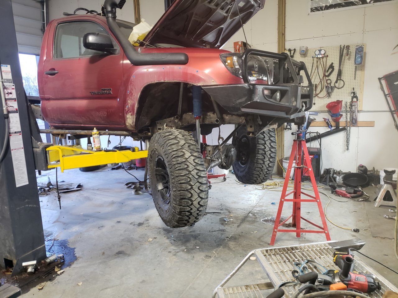

    Im only getting 4 inches of uptravel but a grip of down travel. No axle wrap

    Yeah I only get axle wrap in the rear now but planning to do an anti wrap bar here soon to help with that. With 6.5 now I can go as fast as I want and not get the crap beat out of me which is nice and still flexes really well while being super stable.

    Awesome!
    What you described really settles the "leafs vs links/coilovers" type of arguments.
    Yes...leaf springs work, are cheaper, etc. But links/coilovers are soooooooooooo much better in so many ways.

    There’s always trade offs. A little taller for more uptravel on leaf springs and some decent bump stops and I probably wouldn’t have thought I needed to link it.
    But for the wheeling I do (lots of sand stone, sand hollow, moab etc) with lots of off camber and steep climbs I like a lower overall height.
    37s and 24 in frame height with a 125 in wheelbase i bellied out a lot. Now 39s with 23.5 in frame height and a 128 or 130 wheeelbase and I rarely touch the belly. All a trade off in the end.
    I also think leaf spring tech has progressed a lot from when I originally did mine and a set of deavers up front or sky’s new 3f springs would also have been worlds ahead for ride quality vs my trail gear plus junkyard springs pack.
    sounds dumb but main reason I did all this work was because the springs were worn and needed replace and I wanted more uptravel to go fast lol. The truck worked super good before and there was very few obstacles in the south west I couldn’t do and I out wheeled a lot of very well built jeeps.

    That escalated quickly from worn leaf springs that needed replacements to a 3-link and coilovers haha.
    I'm at 26.5" frame height on a 104" wheelbase :eek: (reg cab truck on 40"s). Pretty tall by y'all standards lol.
    I have TG 5" leaf springs in the rear axle. They have worked pretty good for the most, tons of flex and good highway manners (I don't have a trailer). However, I know that having leaf springs in a steering axle with leafs also in the rea is a whole different story. I would probably hate them in the front.
    Your project turned out really good. Glad to hear is performing well and that you like it.

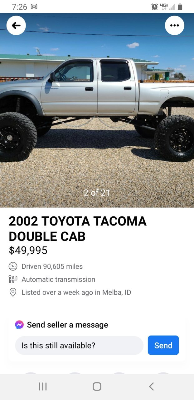

    Well if you dont want to build it you can buy it

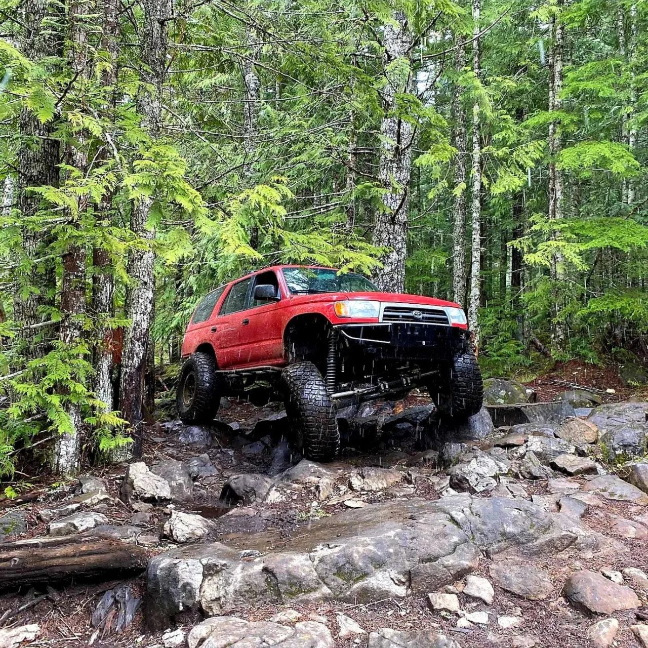

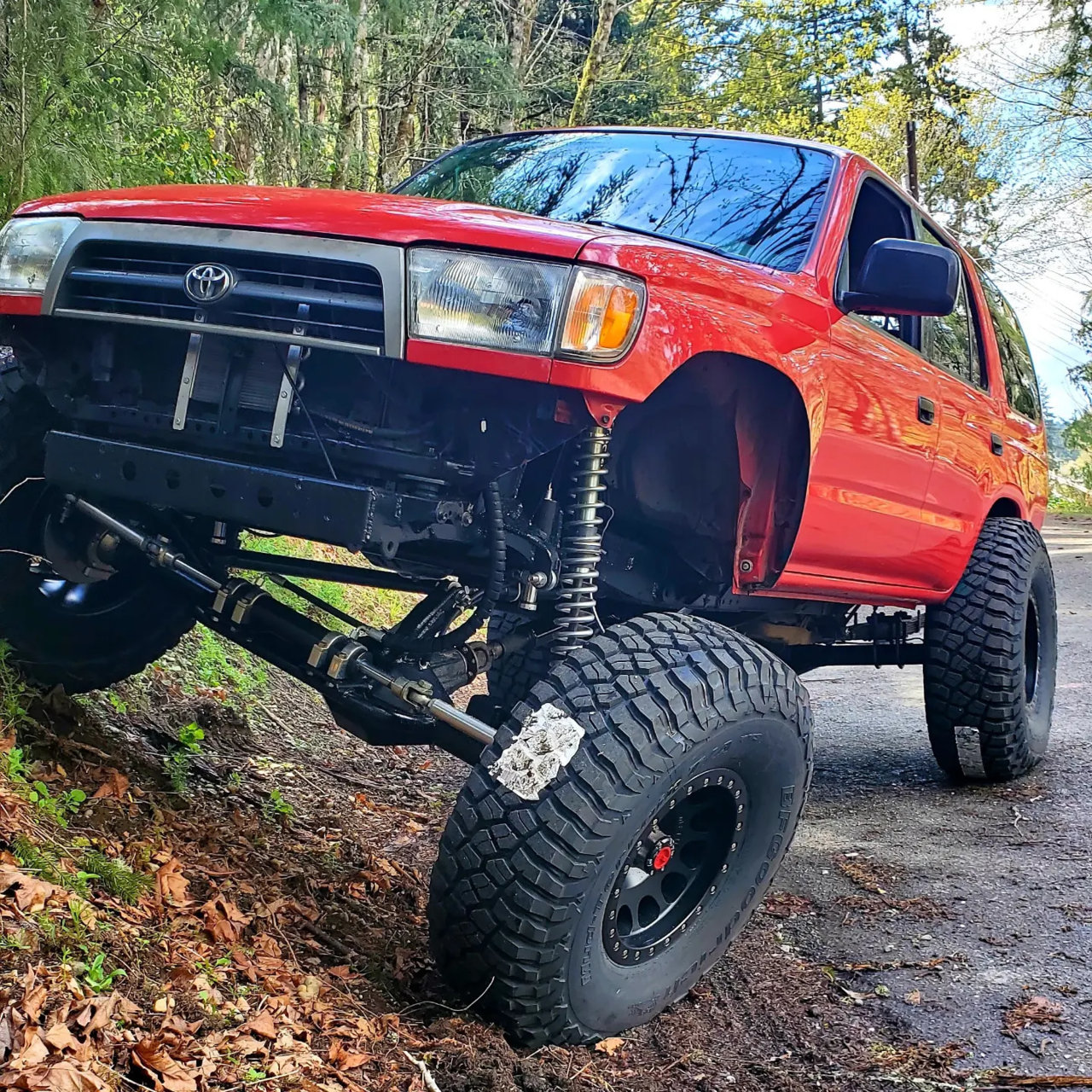

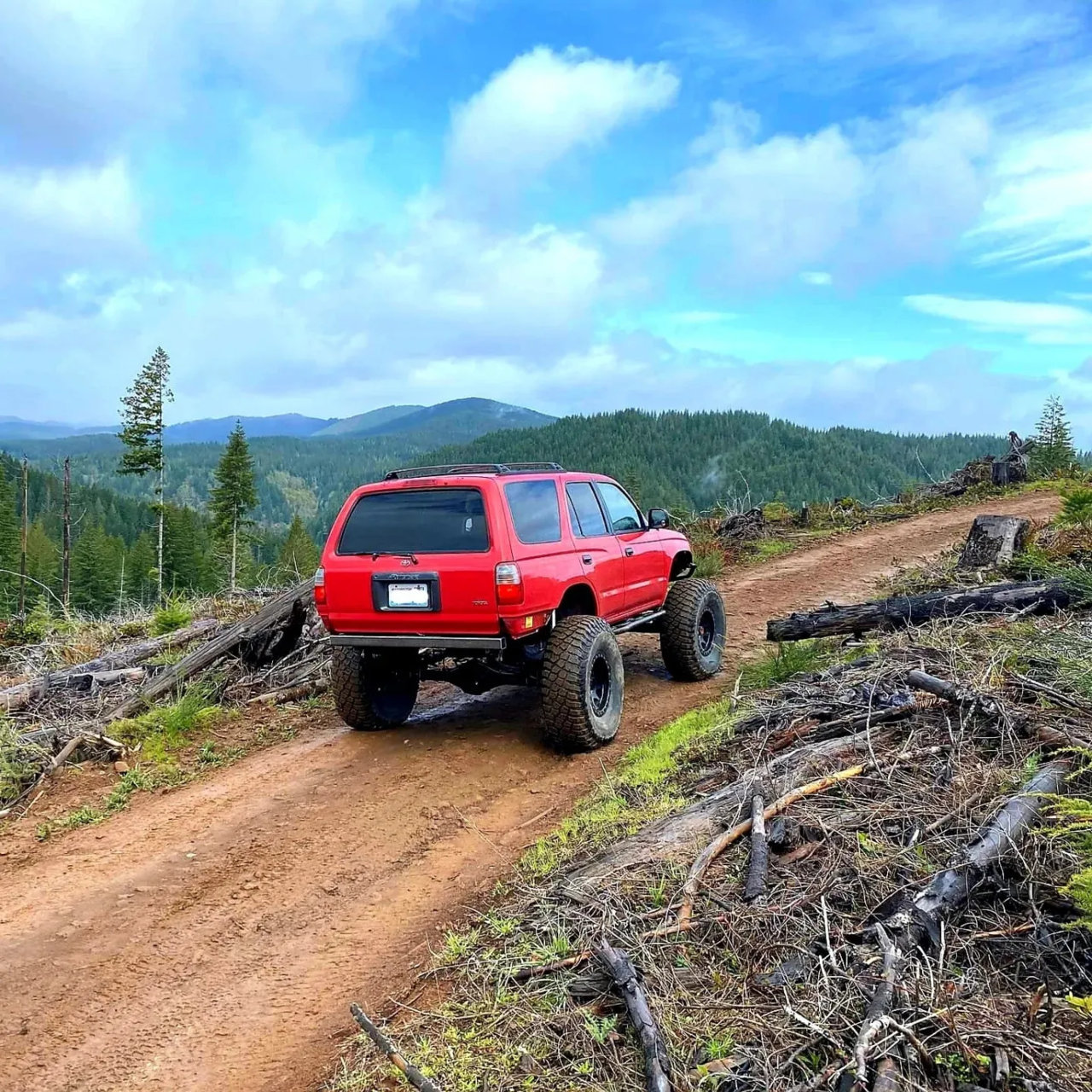

    Thought I would post my 4runner build. It's 4WU front 3 link, full hydro, Diamond Axle, Dual transfer case, E-locker front and rear, and rear leafs. I'm over $25k just in parts. Was way more $$$ than I expected and still not done.
