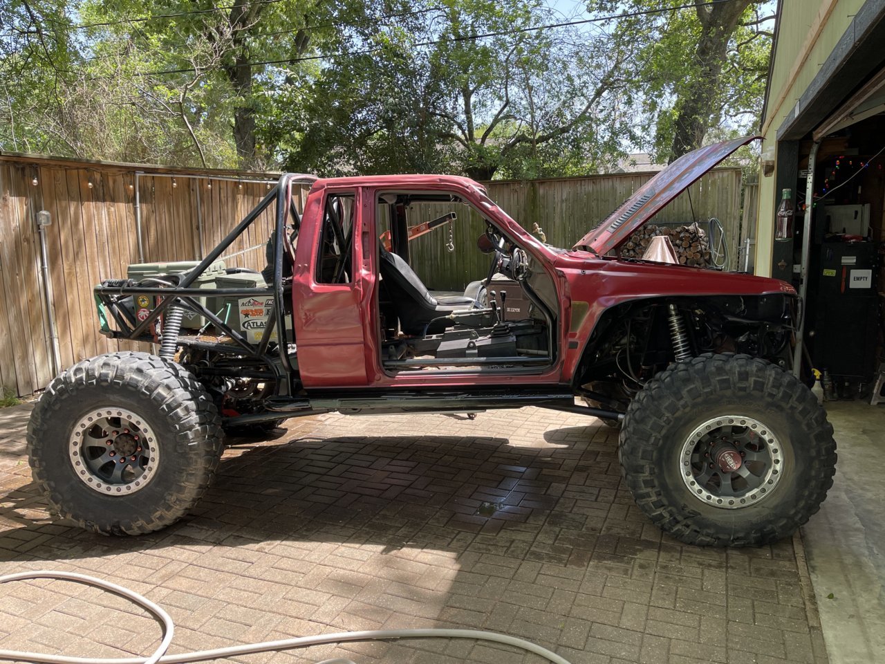

    562D84AB-C0D4-488E-895D-0B42B372DB42.jpg Unless you rip all that shit out like I did lol. The leaf sprung stuff was cool until it wasn’t. Tons, links front and rear, stickies, beadlocks… its a fucking snowball for sure. Now I’m in the the middle of a 2rz turbo swap. I should have built a buggy lol.

    I remember following your build. It has gone through a lot of transformations! One of my favorites for sure. In its current stage is definitely not a good example to prove that the older trucks are cheaper to build lol

    True on that. I love working on this rig though. 12 years of sinking money into an endless money pit. That being said, when I initially built the toy axles I had about 2500 in them with no suspension and steering mods. That was replacing every serviceable part on each axle with OEM parts, 5.29s, detroits front and rear, longs, and an IFS rear width axle. It adds up quick.
