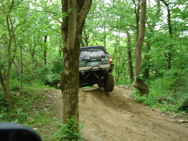

    Older trucks are A COMPLETELY different story. They are simple to build compared to a tacoma. Great 4runner none the less! Looks like it flexes well! :cool:
