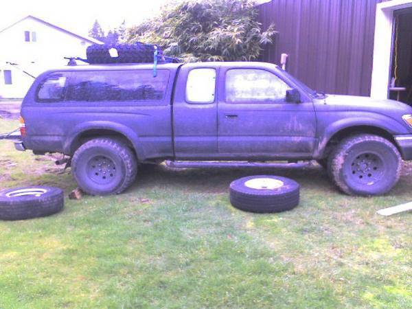

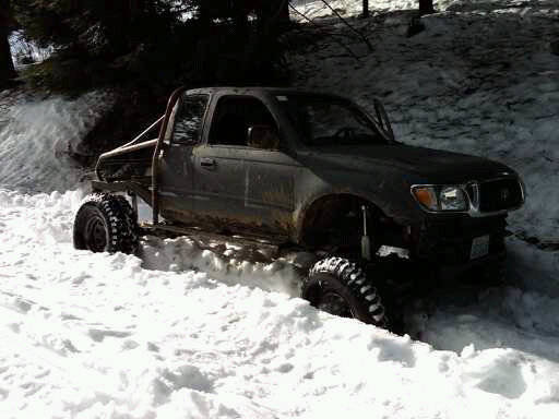

    I WOULD BE HAPPY TO SHOW U A CHEAPER WAY. THAT IS VERY EFFECIENT AND RELIABLE. you dont ALWAYS have to buy the BEST parts right out of the gate.
    this is the first time i did my sas tacoma back in 07
    wagoneer dana 44 w/flat top knuckles $250
    94 toyota rear leafs $100 i ran the mounting leaf and over load with 3 of my tacoma leafs from my rear! put them up front.
    ford F250 shock mounts $23 each from dealer
    IFS steering box $75
    steering shaft to column $200 bentup.com
    pro comp 14" ES3000 shocks $124 all 4 4wheel parts
    firewall plate allpro $65
    driveline flange to from 44 to toyota $90
    trail gear front hanger $50
    tube bungs from trailgear and jigs $45
    stock shackles from a rear toyota $20 craigslist.
    dana 44 to toyota brake lines $$$$ i had mine made pretty sure it was under $100
    rear chevy 63's $100
    i made my own shackles
    mounts for the 63's $45
    rear driveline $250.
    stainless brake lines $80
    throw out a few hundered for bushings and some metal for bracking and plating of the frame.
    thats under $2000 and i wheeled the shit out of my truck broke a few u joints and hubs. but my truck was done it wheeled great and i built it over time.
    sence then i've gone threw many axles and setups.
    if i had to do it again all over as it was my first build.
    i would go with toyota axle get rid of the shitty chain driven tcase and do the v6 adapter to 4cyl gear case. so it was passenger side drop
    FINISH PRODUCT WHEN I FIRST DID THIS

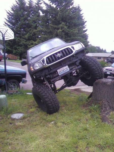

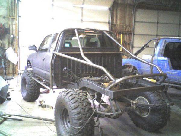

    HERE IS WHAT IS GOING UNDER IT RIGHT NOW AND PRICES...
    04 tacoma 77k ext cab 3.4 v6
    narrowerd front end 20" cut off the back
    front
    dana 60 rear end narrowed tacoma width pass drop w/toyota SAS outters
    dirty30's resplined
    trunion elim
    PSC full hydro
    3link w/panhard
    ORI struts
    rear
    dana 60 narrowed tacoma width
    stock tacoma axles resplined
    disk brakes
    4 LINK
    ORI struts
    3.0 tranny
    4cyl gear driven dual cases w/4.7
    42" pitbull rockers 16x10 steel wheels with weld on beadlocks
    Triple stick setup $
    PSC hydro kit $1067.75
    PSC 3.4 pump kit $425
    six shooter knuckles $260
    DOM tubing @ $8ft $
    8 ballistic joints @$48 $384
    2 diff covers $
    2 yota /d60 flange $75
    4.56 gears 2qty $250
    ORI struts 4qty $650
    DIY beadlocks $225
    toyota sas $300
    dana 60 $70
    dana 60 $80
    tacoma rear axle $100
    dirty 30's $540
    respline $90
    taco shaft respline $60
    U bolt flip $35
    spring hanger perch $45
    4.7 gear $410
    dual case adapter $235
    23 spline shaft $119
    v6 adapter 4cyl case $290
    trunion elm kit $150
    don brown machining $360
    2 gear drive Tcases $160
    16x10 steel wheels $100
    42" pitbull rockers $1700
    total $10,456 total i'll be around $15k when im done but i've also sold parts from some of the things i've bought and that list is below and made back around $1500
