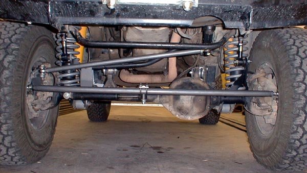

    What about for durability? I don't want to be swapping out joints very often. Also as I like to wheel alone, in remote places, it seems like leaves are a more well... trouble free option.
    I do like the idea of the LC radius arm set ups but I like the flex of the leaves better.
    Also I can't remember if this was answered on that build thread on TTORA but how does that guy like those 60s with the 37s, any word?

    Well you would use big joints. Currie, Ballistic Fab, Parts Mike and Ruff Stuff sell them for cheap now (They used to be expensive). You can get them with a 1 1/4" threaded shaft and accept a bolt up to 1". They also come in "uniball" style or urethane bushing style. I don't use Heims a lot because of the wear. They get sloppy after a little while and start making noise.
    You can get far more flex out of links than you can with leafs. And you can control things like dive/anti dive and roll steer a lot better with links. You're right though, leaves are a nice combination of easy and strong.
    The Blue Tacoma DC? He loves it. We call it a Tacoma HD!

    You hit the nail on the head about the unexpected cost of doing the SAS. So far I have been lucky and only ran into $300 of unexpected cost while collecting parts. I had to get steering joints and went ahead and did chromo hub gears. That being said the actually swap will begin in a week or so, so we will see what pops up.
    I had originally thought I was going to get the front and rear leaf sprung for $5,000-$6,000 and instead I'm going to have $6000 in just 3-linking the front. The rear will come eventually but it wont be anything too amazing... just beefing up the leaf pack, u-bolt flip and putting in some long Fox shocks. So figure another $1,000 or less.

    That's a good estimate. And leafs are great in the rear.

    Well, the oil pan on the tacomas have the forward mounting location for the oil pick up, and when the axle is stuffed it will clearly hit the oil pan. When the new oil pan is used it makes it a rear facing pickup and allows for more stuff on the axle. Oil pan is the same pretty much, its the t100 oil pan (same shit just reversed oil sump) use the 3.4l oil pan from the t100 on the tacoma 3.4l. and the 2.7l t100 for the 2.7l tacoma.
    Hysteer is just a form of steering set up mainly used by guys with leaf springs. When you run leaf springs and locate the steering gearboxes on our trucks it becomes clearance issues majorly for the leaf spring crap. basically it is just a "Higher mounted steering" Set up than the normal steering, or a mid steer. Has nothing to do with pumps, just a form of steering linkage.
    Hysteer: Over the leaf springs
    Mid to low steering under the leaf springs if they were to run leafs
