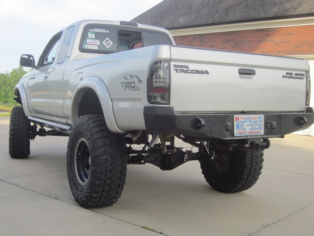

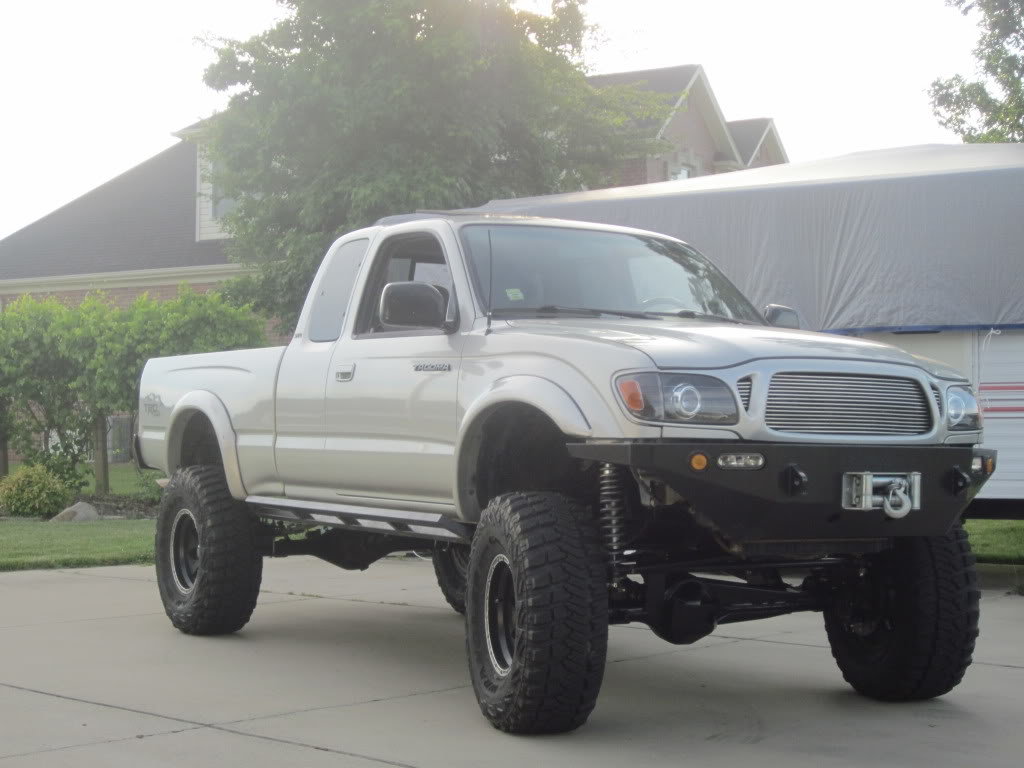

    I started out thinking I could do everything for $5,000-$6,000... boy was I off :rolleyes:
    3 Link SAS Price Sheet
    Axle
    79 Toyota; 8” 4cyl  $250.00
    Sierra 8” 4cyl 4.56 gear set  $185.00 + 10% off  $166.50
    Sierra 8” 4cyl master bearing kit  $135.00 + 10% off  $121.50
    Spartan Locker 8” 4cyl  $284.26
    Marlin front axle service kit  $179.00
    Trail-Gear Chromolly Hub Gears  $100.00
    Vented rotors (79 FJ40)  60.00?
    Reman Calipers  Carquest #’s 19-1601 and 19-1600 (94 4Runner)  $79.42
    Raybestos Brake Pads  Carquest # RCD 611 (94 4Runner)  $22.53
    Low profile drain plug  $4.99
    TOTAL  $1,268.20
    Suspension
    Fox Coilovers  12in Travel  $620.00
    Upper Coils  10in with 250lbs  $130.00
    Lower Coils  14in with 350lbs  $130.00
    Fox Emulsion Shocks  12in Travel  $320.00
    Toytec 2in Shackles w/ Bushings  $149.36
    Brackets  $400.00
    TOTAL  $1,749.36
    Transfer Case
    82 Toyota top shift case  $100.00
    Tacoma Passenger Side Adapter  $399.00 + 10% off  $359.10
    Speed Sensor Adapter  $100.00 + 10% off  $90.00
    Creeper Gears 4.7:1 – 23 Spline  $492 + 10% off  $442.80
    TOTAL  $991.90
    Drive Shaft
    HD Front Driveline Kit – Creeper Joint  $229.00 + 10% off  $206.10
    Rear Tube Yoke  $39.68
    Rear Flange Yoke  $58.53
    Rear U Joint  $21.36
    Steering Shaft Joint  $100 x 2  $200.00
    TOTAL  $525.67
    Misc Parts Needed
    Oil Pan  12101-65030  $155.62
    Strainer  15104-62060  $62.78
    Oil Strainer Gasket  15147-62060  $2.05
    Oil Pan Drain Plug and Gaskets  Dorman #’s 090-038 (plug) and 097-115 (gasket)  $2.50
    Transmission Cooler  Carquest # 77421  $41.86
    33x12.50 Goodyear MTR Kevlar  $900.00
    TOTAL  $1,164.81
    Fluids/Chemicals
    Amsoil 75W90 Synthetic Gear Oil  $11.55 x 8  $92.40
    Amsoil Synthetic ATF  $8.90 x 14  $124.60
    Amsoil Synthetic Grease  $5.41 x 4  $21.64
    TOTAL  $238.64
    Shipping
    Inchworm  $93.03
    Marlin Crawler  $20.72
    Trail-Gear  $43.98
    Amsoil  $36.05
    TOTAL  $193.78
    Labor
    SAS and Rear Shock Setup  $1,700.00
    Rear Drive Shaft  $75.00
    Gearing and Installing the Transfercase  $300.00
    Differential Gear Setup  $75.00
    TOTAL  $2,150.00
    Parts Sold
    Front Differential (geared and locked)  $800.00
    Icon UCA’s  $630.00
    Toytec/Bilstein Coilovers  $500.00
    Remington Sendero 7mm Mag  $950.00
    Nikon Monarch 8-32x50SF  $480.00
    Sold Total  $3,360.00
    Grand Total  $8,282.36
    Out of Pocket  $4,922.36
    WORTH EVERY DIME!
