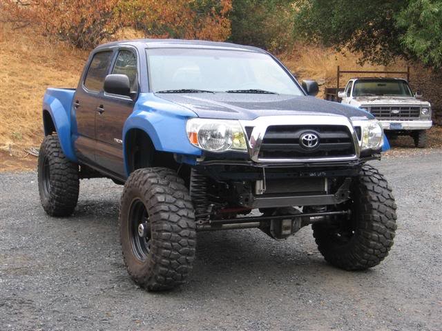

    JLee
    JLee The Man! Vendor
    Jul 20, 2010
    #40461
    19,611
    Jerry
    Benicia, CA
    02 Extra cab SAS Linked front and rear
    I lost track thousands of dollars ago.
    Here is my brake down I'm sure I spent more but that's all I've got on my list.
    Axles $10,503.07
    1 Front Axle Housing & Ultimate 60 Knuckles $1,100.00
    1 Rear Axle Housing New 2nd hand $400.00
    2 One Ton Outers used $325.00
    1 Spidertrax 5 & 6 Lug Aluminum Hat Blem $79.95
    3 Spidertrax 5 & 6 Lug Aluminum Hat $299.97
    2 Spidertrax 4340 Stub Shaft Kit $799.90
    1 Spidertrax 1 Ton Full Floater End Cup Kit $249.95
    2 One Ton Outers new $599.90
    1 Rear 3rd With ARB $1,250.00
    2 Hi- Steer arms $329.90
    1 Drive Flange Kit $249.58
    2 Yukon Hardcore lockouts $295.00
    1 Front Diff $1,564.12
    1 Front inner shafts $999.95
    1 Rear Shafts $499.95
    2 Oil Seal Kit $59.90
    2 Long Field U joints $400.00
    1 Front driveline $500.00
    1 Rear Driveline $500.00
    Suspension & Steering $4,192.81
    6 1.5" ID Tube Adapter LH $59.94
    6 1.5" ID Tube Adapter RH $59.94
    6 Chromoly 2.63" Ballistic Joint LH $323.94
    6 Chromoly 2.63" Ballistic Joint RH $323.94
    6 1.5" ID Jam Nut RH $35.94
    6 1.5" ID Jam Nut LH $35.94
    2 14" Stroke ORI's $1,100.00
    2 16" Stroke ORI's $1,420.00
    2 7/8 X 3/4" Rod end sets $140.00
    1 Toyota IFS Steering box $323.10
    2 3/4" Rod end sets $118.00
    1 Toyota Tacoma Firewall Kit $35.10
    1 Tacoma/4Runner Steering Shaft Seal $12.95
    1 Aluminum Heatsink Cooler for Steering $39.99
    1 Toyota Flat Pitman Arm $71.10
    1 8" PSC Hydro Ram $138.50
    1 Borgeson Universal Steering U-Joints $75.12
    1 Telescoping Steering Shaft $74.97
    1 Step Down Spacer 3/4" to 5/8" $4.99
    6 Ballistic Joint Rebuild Kit $77.94
    1 Toyota Gear Box Fitting $6.30
    1 Steering Box Low Pressure Return $17.15
    18 powder steering hose $105.30
    6 DIY hose fittings $46.62
    1 DIY hose fittings $47.05
    1 Tube Clamp $32.99
    Brakes $2,226.38
    1 Wilwood Dynapro Type E Polymatrix Pad Set $105.00
    2 Wilwood Dynapro 6 Piston Caliper $558.00
    1 Spidertrax LSK Caliper Mount Kit $29.97
    1 Spidertrax UEC Caliper Mount Kit $59.97
    1 Wilwood Type E Polymatrix Pad Set $69.00
    2 Wilwood Forged Dynalite Caliper $270.00
    4 Spidertrax 14" Pro Series Rotor $636.00
    1 WillWood BPV $41.30
    1 Line Lock $49.95
    1 SS Brake Lines $407.19
    Miscellaneous $6,767.68
    1 37"x 12.50" X17" MTR's $2,193.59
    1 Taco Box $1,970.50
    1 Toyota 3.4 (5VZFE) PSC Pump Kit (PK1235) $425.00
    1 Oil Pan Kit $225.00
    5 SCS 17"x 8.5" Wheels $500.00
    1 Shipping $19.73
    1 Shipping $16.43
    1 Shipping $21.87
    1 Spare Tire Spindle $80.00
    1 Shipping $12.35
    1 Tax $11.09
    1 Dual-Fill Nitrogen Charge Kit $264.00
    40 2"x 3" x.188 wall tube $127.20
    24 1.5" .250 DOM $108.00
    1 Shipping $21.56
    1 Shipping $13.75
    1 Shipping $15.75
    1 Shipping $16.97
    1 Tax $11.08
    24 2" .250 Wall Tube $204.00
    1 Shipping $11.00
    2 Through Bumper Clevis Mount $47.98
    2 Weld-in fill plug $11.98
    1 Shipping $14.06
    1 Shipping $8.55
    1 Shipping $9.35
    1 Hardware $21.01
    1 Battery Box $36.95
    1 Hardware $117.97
    1 Yellow top Battery $204.99
    1 Gal PS fluid $13.99
    2 32oz Brake fluid $11.98
    Parts sold -$2,080.00
    1 IFS Skid and belly pan -$475.00
    1 LCA Skids -$80.00
    1 TC UCA's -$400.00
    1 Front Bumper -$600.00
    1 Wheels -$200.00
    1 Rear Shocks -$75.00
    1 Sliders -$100.00
    1 Rear Drive shaft -$150.00
    Total Costs
    Parts $23,713.93
    Total $21,657.92
