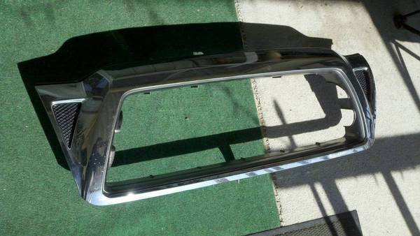

    Day 1:

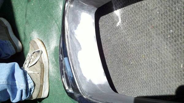

    Started with a stock chrome grille. Then did some chopping.

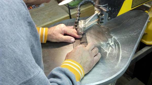

    Used a sawzall to cut everything out. Then sanded everything down

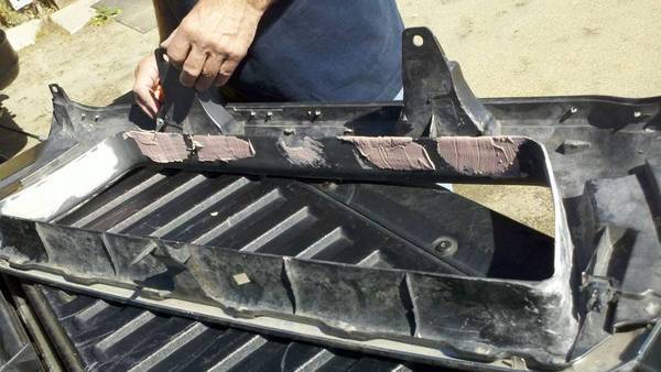

    For the open cuts, we decided to use plastic pieces out of the center cut out, and plastic weld them on. Unfortunately, work gets in the way of the fun and that will come tomorrow. More pics up then

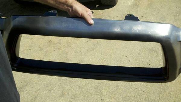

    Day 2:

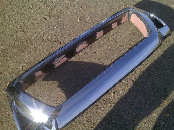

    Bought fiberglass, bondo, and the metal....

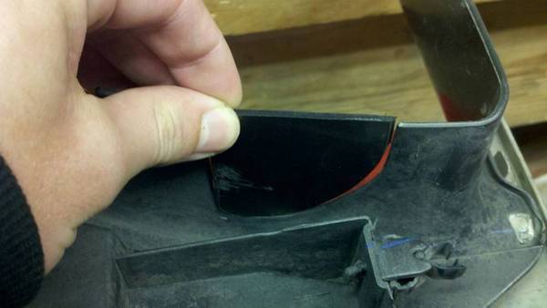

    We started with cutting plastic pieces to fill in the holes out of the center of the grill we cut out:
    and fitted them

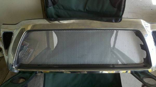

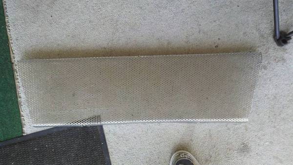

    Then we molded and cut the metal. We decided not to zip tie it in. Instead we bent it and cut it to slid right in, then we're going to either glass it in or use epoxy.

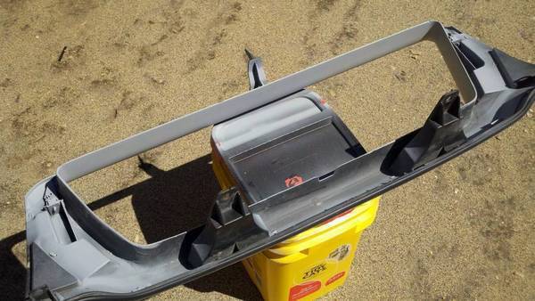

    Then test fitted it in

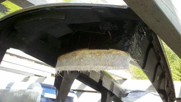

    Then it was time to put the plastic pieces in and fiberglass the back
    Some bondo action...

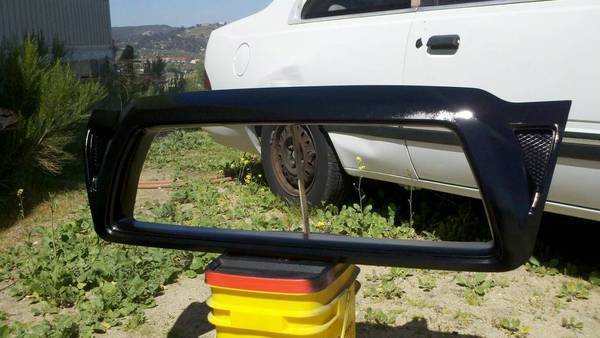

    While waiting for the bondo to dry, we painted the metal gloss black
    Then after the bondo dried, we sanded it down, made it smooth and primed
    Day 4:
    Started the day by sanding down the chrome with 220 grit paper
    After that we preped the area for painting, and starting spraying. We went with a krylon fusion in gloss black. Decided it was probably the best paint for the surface. Came out way better than I hoped

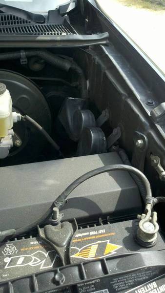

    Relocated the horns on day 4, took a pic today

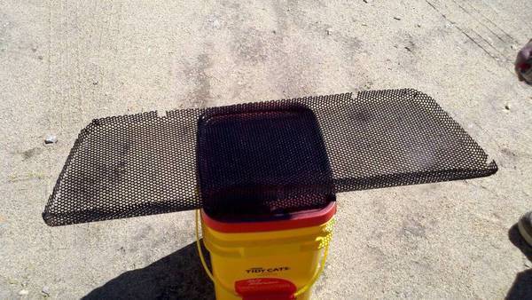

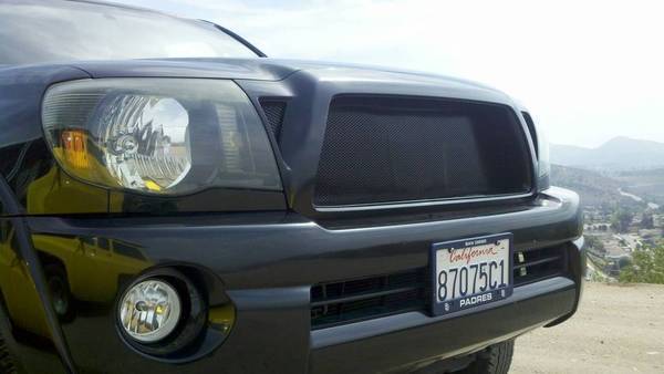

    So we molded the mesh and glassed it in to finish up yesterday. Then it was complete

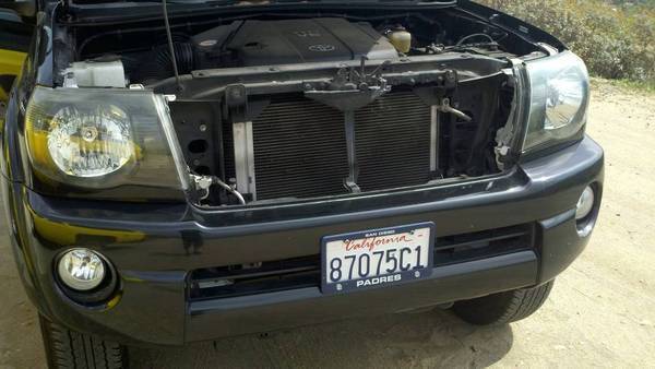

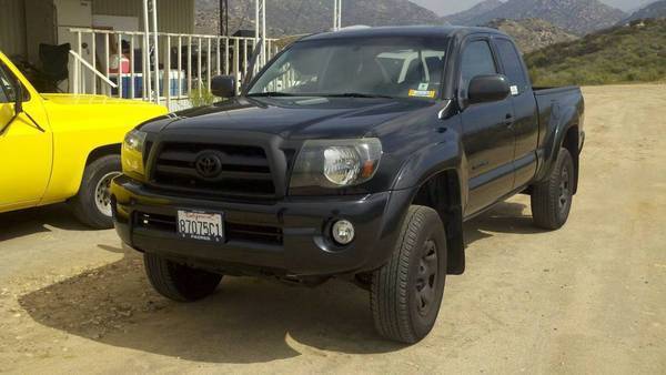

    Took off the stock grill
    Comparing the plastidipped grill to the satoshi...
    Then threw in the satoshi! I couldnt be happier with how it turned out. Time to get some lights.
    Did some comparison shots and fun shots......
