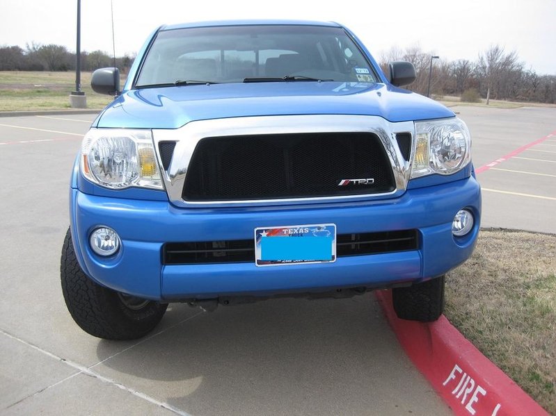

    I got mine completed this weekend. I love the way this mod makes the taco look.

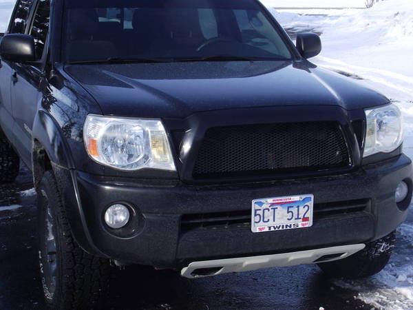

    started mine today

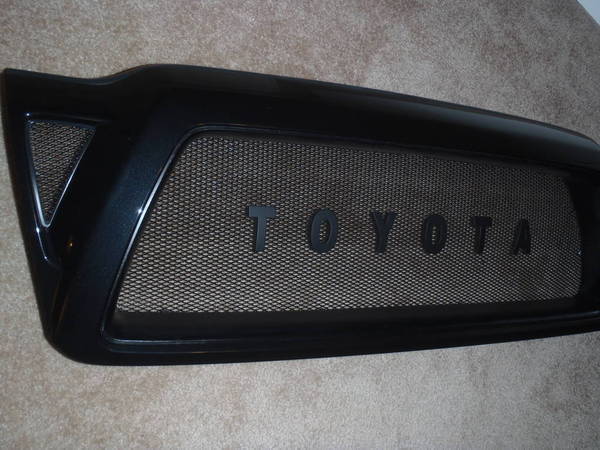

    Finished the grille w/ big help from this post Klipp. Cape codder and Ty (1BlkT) offer lots of advice too for anyone looking. By the way, although nothing is all that difficult, there are a lot of things about this mod that are a pain in the ass: all the trips to pick up supplies, the sanding, taping and painting, EPOXY. Pretty tight seeing it on the truck after a car wash though.

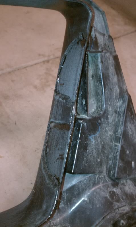

    Quick question. Can't I just take the same piece of plastic that was cut from the center of the cross member and instead of cutting it out to the correct shape, just epoxy the whole piece "behind" the gap? Then fill it with putty/bondo? Then sand and paint?

    Yes you can for sure....especially if your cut doesnt match up exactly and have to fill in the gaps like I did. it also makes it stronger to have a 'backing' piece.
    that would be easier....:)

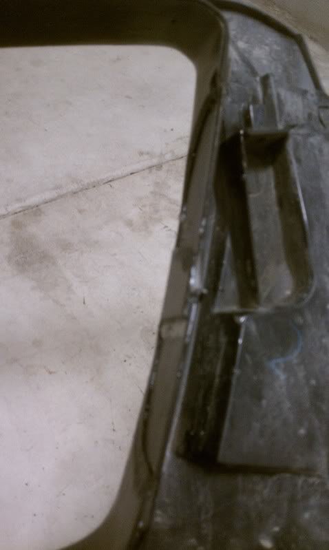

  17. Apr 11, 2011 at 12:34 AM
    #317
    TheBlackPearl
    TheBlackPearl Well-Known Member
    Feb 18, 2009
    #13771
    150
    Orange County
    '06 Double Cab Long Bed TRD Sport 4x4

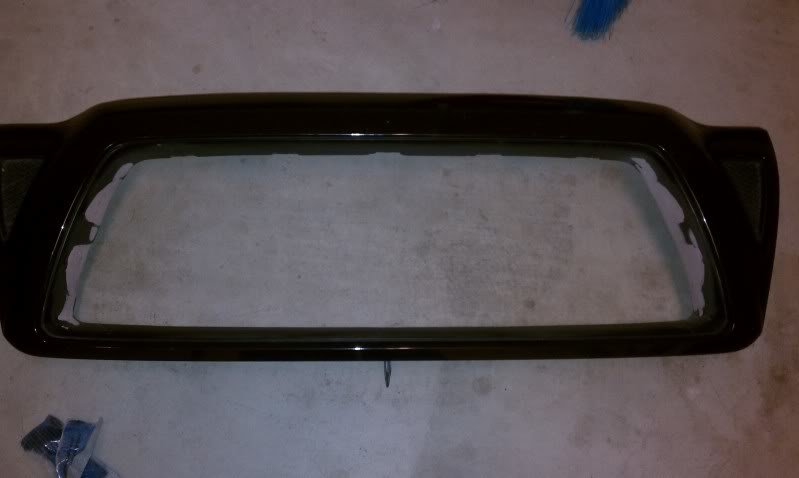

    Okay. Here's what I meant. I apologize for the crappy cell phone pics.
    I initially tried to cut out the "puzzle" piece like the OP but I couldn't get it to fit and hold correctly. So I decided to use Loctite Plastic Epoxy to bond the plastic strip behind it instead of cutting the perfect shape to fit the gap.
    After the epoxy cured, I just applied some bondo over the top, allowed it to harden, then sanded it down evenly with 80 grit. I didn't get to finish it yet but everything appears to be holding on nicely. I still have some more sanding to do. I'll probably finish the project this weekend.
    I've never used bondo before so does anyone know if this is a good way of doing the satoshi? Will the bondo fall off? LOL.
  18. Apr 11, 2011 at 7:47 AM
    #318
    rcfreak201
    rcfreak201 Well-Known Member
    Jul 24, 2010
    #40660
    6,064
    does the bondo stick well over time like that? if its used to fill that gap will it ever crack and expose the little part that isnt filled in perfectly?( referring to that pic^^ )
  19. Apr 11, 2011 at 9:06 AM
    #319
    TheBlackPearl
    Feb 18, 2009
    #13771
    150
    Orange County
    Not sure since this is my first experience with bondo. Maybe someone else can chime in.
  20. Apr 11, 2011 at 9:32 AM
    #320
    replica9000
    replica9000 Das ist no bueno
    Apr 6, 2008
    #5782
    16,435
    Lake Chargoggagoggmanchauggagoggchaubunagungamaugg
    2019 T4R ORP
    I've never worked with bondo myself, but I hear it's prone to cracking and falling apart if it's too thick. I couldn't tell you what would be considered too thick though. I think it's only supposed to be used to smooth out imperfections when removing dents, or something like that.
    I used a putty epoxy instead of bondo. It's been 9 months in New England weather and so far it seem to be perfectly fine.
