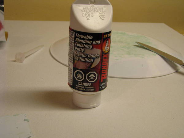

    What exactly is the "finishing putty"? Do you have a pic of the container? If you can save me from ever having to break out fiberglass and bondo again, you'll be my hero.

    i picked it up at my local body shop supply store. here's a pic for ya:
    it comes as a thick paste. just squeezed it out on to the back of an old dinner plate (you can see it in the background), squeezed a bead of hardener that came with it (1:50 ratio of hardener to putty), mixed the hardener throughout the putty, then spread it on the sanded grill plastic to cover up any uneven surfaces.
    it'll give you a couple minutes to spread after you mix the hardener in before it sets and dries. then sand until smooth and paint.
    you're done. :cool:
