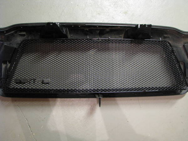

    klipp. can you flip that grill over for an overall back shot?

    here ya go bud

    boy, my regular housecats sometimes scare me! that is amazing. thanks.
    zipties! simple. thanksx2

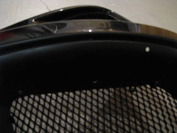

    here's the shot you wanted. looks damn good to me! ignore the drill hole from the the other grillcraft mount method...

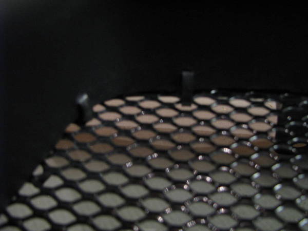

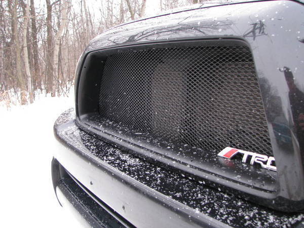

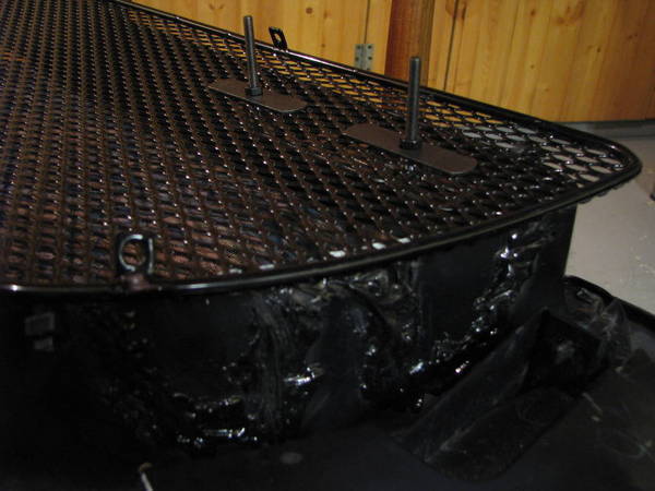

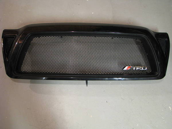

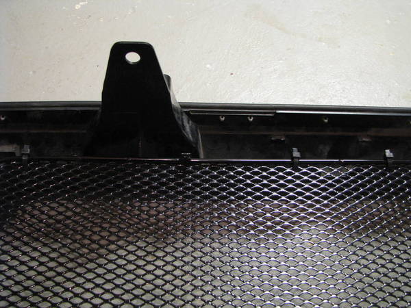

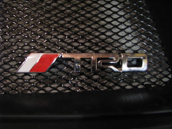

    okay, here's the last couple of pics boys:
    shot of the epoxy and trd emblem from the back side
    zip ties from the back along the edge of the gc. attached 4 along the top, 1 on either side, and 2 on the bottom
    view of the zip ties from the front
    mounted on the truck
    whatcha think?

    DAMN! You just changed the game! I was actually planning the same method. I was drawing it up last night. BUT I was going to use different plastic. It never dawned on me to reuse the cut out portion of the grille. It's awesome to see that doing it this way works. I took a vow a long time ago to never mess with fiberglass again. Work smarter, not harder. Very nice work! +1

    another question.... did you drill holes for the zip ties to go through or??? thanks

    you got it. start with a small pilot hole then bore it out to the right size so that your zip tie just fits through. make sure you drill deep enough in (that's what she said!) so that it won't break through when you cinch up the zip tie tight.
    i drilled more than necessary. haven't decided if i'll patch 'em up or add more zip ties. all you really need are 4 along the top (to support the weight of the gc), 1 on each side, and 2 on the bottom :cool:
