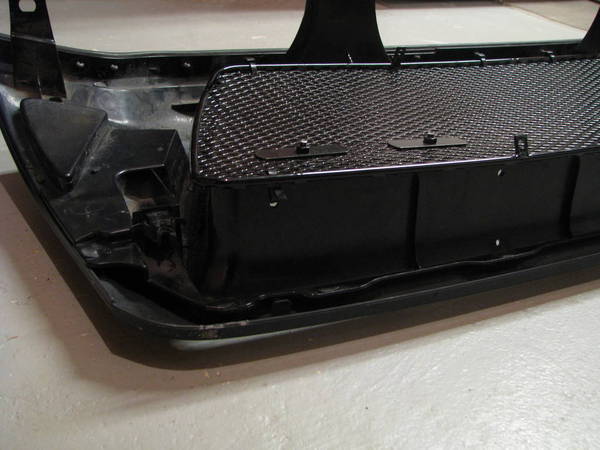

    okay let me know what you guys think about this. I went to home depot to get the zip ties and saw the packages of zip tie base mounts. I was thinking instead of drilling the holes for the ties you could use the base mounts and maybe add some epoxy to secure them (they have double sided tape on them) just thought the epoxy would hold better. In any case you could use alot with little cost and you wouldn't be able to see the zip ties from the front...... just my two cents here. I'm trying to figure out the best way to do this. I'm also looking at making a cover for the horns instead of moving them.....

    I've used this method on the couple Satoshi grilles I've done and have had mixed results. The mounts and epoxy seem to stick just fine to the original plastic of the grille but sometimes want to break free from the fiberglass portion of the grille. I peel the sticky pad off the mount, rough up the spot I'm putting it with a dremel so there's something for the epoxy to grab onto and then just wait for it to cure.
    On my personal grille I've had to go back a few times and redo the sides and haven't had to touch the top or bottom. Once you finally get everything secured down though it seems to hold up very well.

    i haven't seen the mounts you're talking about, but that sounds like a great idea to me. you could hide the zip ties from the front view completely that way. post pics here when you're done! :thumbsup:

    I usually use a couple of those mounts on the grilles I make as well. I remove that double sided tape and rough up the plastic on the back portion of the grille prior to using ABS glue to bond the two plastics. If the surface isn't flat though they sometimes want to break free so watch where you are mounting them.
    I usually only use a couple for the top because on the bottom of the grille on the back portion where it isn't visible I drill a few holes and loop the zipties through there on up to the grille. I can try and take a couple pics to explain what I mean if you need a visual.

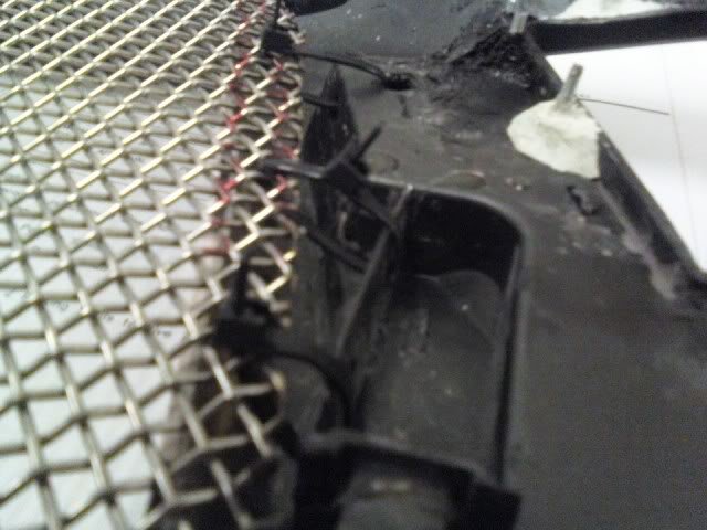

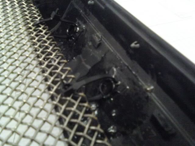

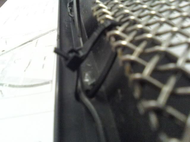

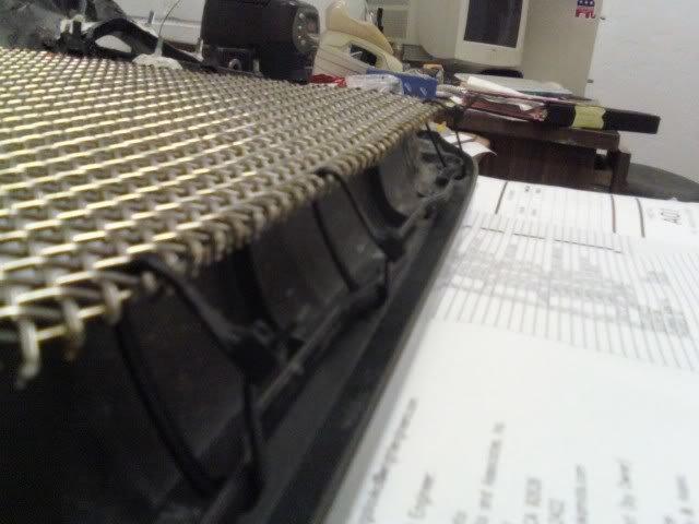

    Sorry for the pic size and quality I snapped them with the good ole cell phone.
    Bottom of the grille
    Drilled little holes just large enough to fit the zip-ties through. Make sure if you drill through the plastic tab you don't keep drilling and go through the outer grille surround.
    Side of the grille
    Drilled a hole through the empty box portion on an angle to run a zip-tie, that's real sturdy. The bottom two in this pic I tried to drill them close to the base. Careful not to overtighten here, I think the plastic my crack. I've had no problems with mine though, I've got it just a little past snug as far as I'm concerned. Did this on my grille and a few others I've made and no one has had problems yet (knock on wood).
    And on the top I've been using the zip-tie tab thingy's
    Let me know if you have any questions
